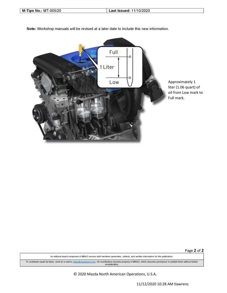

There’s a new oil consumption TSB on 2021 2.5T:
TSB No.: 01-012/21 CHECK ENGINE LIGHT ON WITH DTC P250F:00 DUE TO LOW ENGINE OIL LEVEL

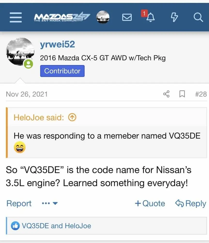

And “VQ35DE”?
Funny :-) VQ35DE.... that was engine in my '02 Maxima.. my VQ35HR in my '07 Infiniti G35x I purchased new doesn't use anything at 112k miles.... literally on the high dot ..even let a few oil changes stretch to 6K miles... normally 4-5K miles.

The oil consumption issue on the 2.5T from many new 2021 Mazda vehicles could be caused by “modified” valve stem seal as Mazda says in the related TSB: “Since this issue has been reported after a valve stem seal modification, it is very likely that valve stem seal damage is causing oil to leak into the combustion chamber.”
TSB No.: 01-012/21 Check Engine Light On with DTC P250F:00 Due to Low Engine Oil Level
