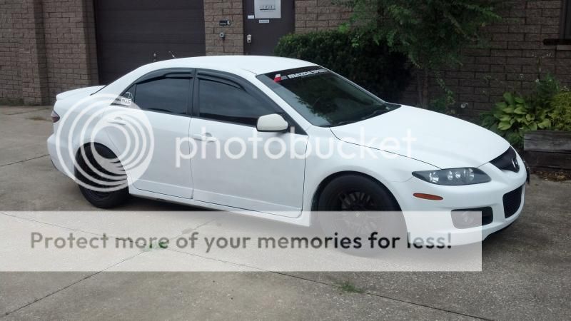

Productive weekend. Added another two coats of white Dip from the cans. Took 14 cans to get decent coverage. What a pain... But turned out pretty well. The car is white again, so that's kinda nice.

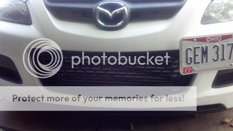

Dave Dremelled out the top rows of my lower grill for better flow to the intercooler. Probably took him a couple hours just sitting there grinding out all those little holes so a HUGE thanks to him for that.

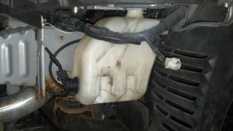

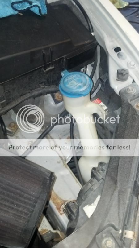

I'm probably most excited about having a windshield washer reservoir again, heh-heh. Relocated to the passenger side and used a 93-95 Civic reservoir that someone posted on MSF fits perfect and it really does. You don't even need to make a mounting bracket, it bolts right up to a frame stud. I used a plastic plug and silicone for where the Civic pump goes then drilled a hole for the MS6 pump and siliconed the s*** out of it. The best part is it doesn't block my power steering cooler.
