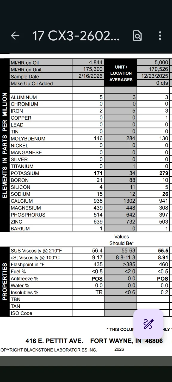

Oil analysis to check for potassium.
Ahh, to indicate the presence of coolant.
My last oil change was at 34,500 miles and I'm currently at 36,200 miles. Is that a long enough period to show results? The coolant reservoir also shows coolant below the low mark. Halfway between empty and low.

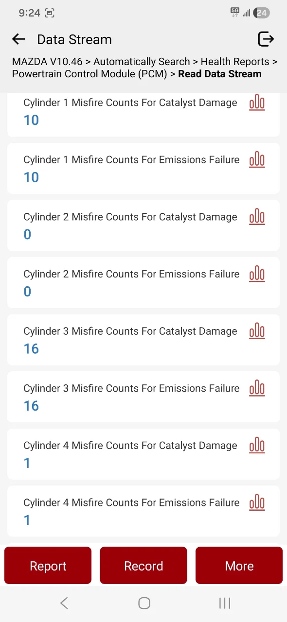

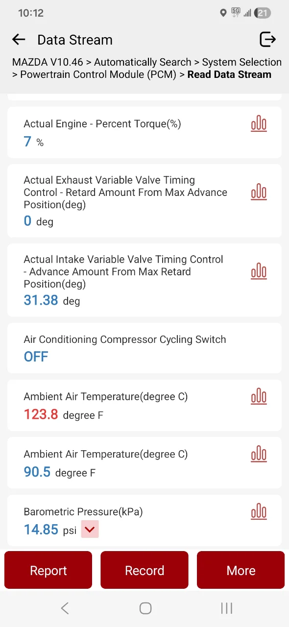

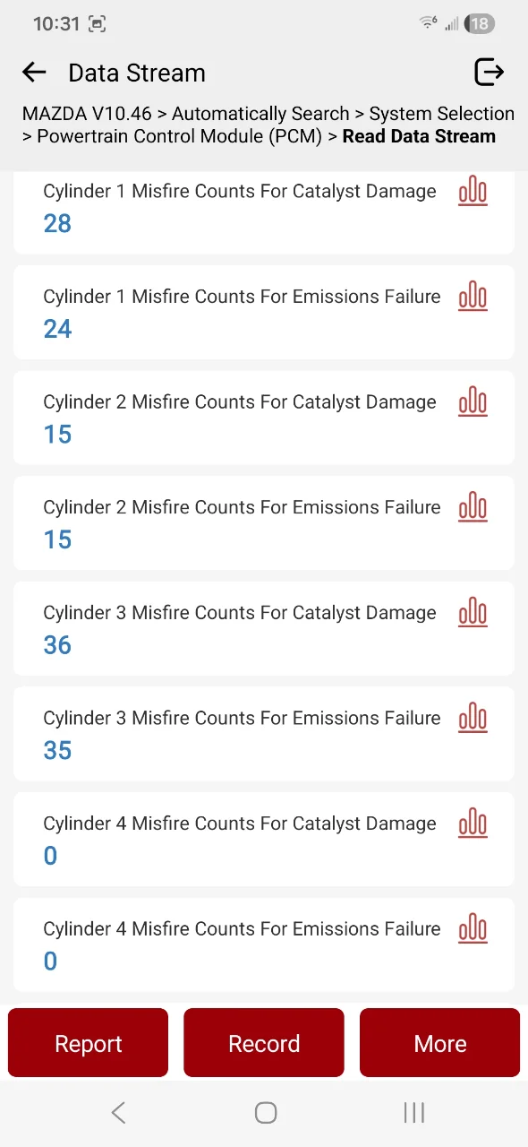

Ok, here are some live data screenshots from a drive this evening I recorded.
The engine exhibits the exact same problem to the same degree as it did before I changed the plugs today. Like the plug change did nothing. I honestly now think it has nothing to do with ignition coils or plugs.
Now i'm thinking it's timing related. That would make more sense. Oil control valve possibly? Burnt exhaust valves? Faulty EGR valve? The engine literally sounds like its knocking when the idle is so slowed and I hear a tin aluminium metal sounding clinking noise (similar to the way the little tab on top of a soda can would sound if you break it off and put it inside the empty can and shook it) when I rev the rpms a little like something is broken or loose inside but it comes and goes. Really bizarre
Anyway, i'm considering removing the new plugs, putting back the old ones and taking it to the dealer. I don't want them to say something to the effect that they see new plugs and give me a headache or trying to blame something on me. This may be over my head.
What do you all think? Something is really wrong here and i'm just drained from it at this point. Thank you to each of you all for your help and insight.

OMG i'm going to throw up! That's the exact same issue i'm experiencing. I'm so sorry to hear this happened to you and that whole experience makes me sick to my stomach.
I don't understand why there is no code thrown for ANY of the cylinders misfiring like that let alone no check engine light on.
Would a dead cylinder cause the other cylinders to misfire like that?
I guess I need to throw in the towel, put the other plugs back in and take it to the dealer.
Or should I leave the new plugs in and drive it around until a code in the PCM appears or put back the previous plugs and drive it around?
Would their scan tool show a misfire code that mine is not for some reason?

In the thread linked above, someone noted the MAF sensor as the culprit. You can explore that aspect yourself. If all your cylinders are misfiring, the cause is hopefully something other than a dead cylinder.
I learned recently that the scanning process is not absolutely precise/perfect. The hardware/software combo can lead to different results. See if you can find a different connector or app to check again. Auto parts stores don't always have time to run scans. There are still things that you can do before turning it over.
