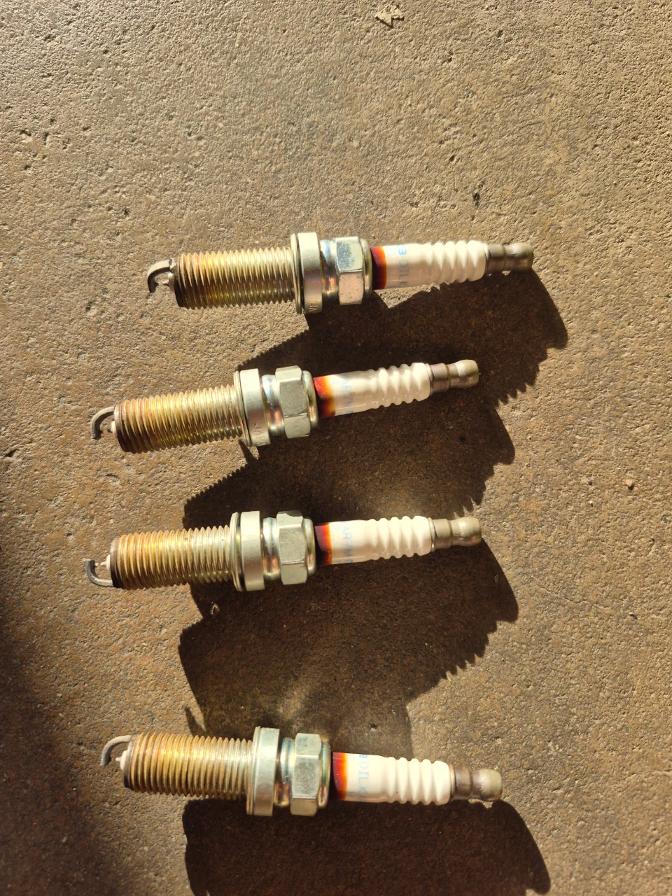

If you want I can send you my old set of oem plugs w/ 35k miles. That way you have oem equipment when you bring it in.
No way!!!! That is so incredibly generous of you my jaw dropped i'm speechless.
That would so awesome and I can feel so much easier knowing they can't try to blame something on my own plugs. I've played that game before and it's so much aggrevation.
Really, THANK YOU and I will be happy to pay you something for them and of course shipping.
You all rock and I'm so happy to be a part of this community to help when I can as well and feel good that we've all got each other.
I'll send you my address and send me your PayPal or zelle email!
Haha the all knowledgeable sm1ke has entered the chat! You're a good man thank you.(Actually everyone here is)
Yes, i'm going to do exactly that, put the original plugs back in the same cylinders ( I kept them in order) and make a dealer appt.
The warranty is Mazda OEM Platinum exclusionary with no deductible. So that's a huge plus if they come through.

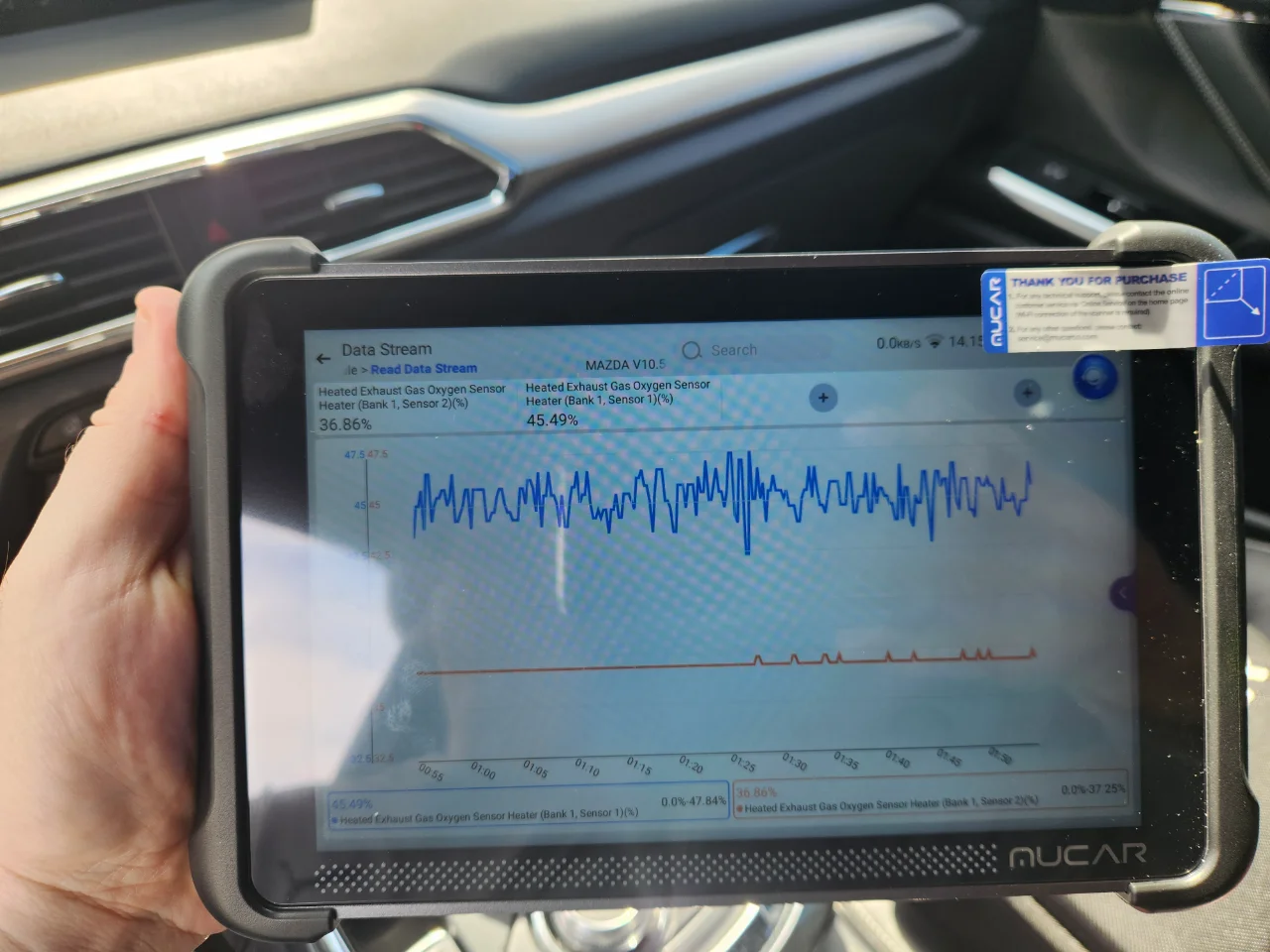

In the meantime, I ordered a higher end scantool that graphs live data and to see if there would be any difference between what I have already and received it today. I hooked it up and noticed an anomaly on the o2 sensor data. There are two o2 sensors and I noticed one very erratic and the other one doing almost nothing. I don't think that's right, however there are zero codes for anything wrong. Here's a pic taken with the engine at operating temp in closed loop.
Anyone know what to nake of this?
Also, the engine misfire counts are all over the place for each cylinder, meaning sometimes is only a handful for only 1 cylinder during a trip and other times its a handful for each cylinder during a trip or just a couple cylinders. Its so bizarre.
Anyway, I'm wondering if there is an oxygen sensor issue now. I'd like to do my own cylinder compression test when I have the plugs out again so i'm going to order one from Amazon for like $35. Some innova one I saw in advance auto. I believe a good pressure should be between 140 and 160 PSI per cylinder with no more than 10 percent variance between cylinders. Someone correct me if i'm wrong.

Oh I forgot to mention that I measured the plug gap on all 4 plugs today after pulling them out and I found the gap to be .27 on all of them which I though was unusual because the spec for the engine is .30.
So, the fact that the plug smells like gas and looks sooted up would mean its not firing correctly right? Injector leaking into the cylinder or bad coil? Coolant intrusion dilution causing a no ignition?

Since all cylinders are showing misfires I'd consider a more global issue; in no particular order :
1) fuel pump, pressure regulator?
2) try a can of BG-44K in a fresh tank of gas - if that changes things for the better, go down the fuel rabbit hole.
3) check ECU wire harnesses, connectors only partially plugged... Injector and coil connectors esp.
4) since plug #3 was wet, try a new fuel injector; if you don't want to buy a new one for the test, swap #3 with another and see if the #3 is dry, the other wet...
I'd do #4 first.
