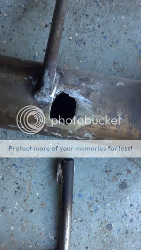

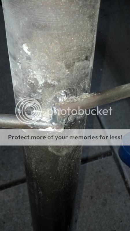

So last week I noticed a rattle on start up/shut down and noticed the exhaust was a little louder than usual. Found out one of the exhaust hangers broke on the midpipe and took a good chunk of the exhaust piping out with it. I patched it temporarily with a can, a worm gear clamp and some exhaust putty while I contacted CPe about the issue. They said it's not under warranty since I'm not the original buyer, which is understandable. And they did offer a replacement midpipe for $250 + $20 shipping. But I can't bring myself to spend that much on a pipe that failed due to the weld. I'll probably replace the midpipe when I have some spare monies but in the mean time I had my friend Scott weld it back on.

Jake ended up disconnecting the hangers on my midpipe due to the way the exhaust sits and it was putting stress on it. Leave it to cp-e to try and charge 250 for a straight piece of exhaust LOL. Get an eBay one for 80-100 and call it a day!
Why replace it at all if it's already been welded fixed? I was going to recommend bringing it to an exhaust shop. They'd have you out of there in 15 minutes for $50 at most.
You should have just cut off the rest of the exhaust. Because racecar, y0!
Like Sho said it would appear something is putting stress on the hangers. Stiffer (i.e. not solid) mounts wouldn't cause something to break unless it's pre-loaded.
aMaff, my understanding is when you re-weld a spot it makes the metal more brittle and susceptible to breaking again.
Fez, it is quieter again, but I still have a small leak at the flange since I have to shove the downpipe way over as far as it will go so it doesn't touch the drive shaft. A little more high-temp silicone will fix it though.
