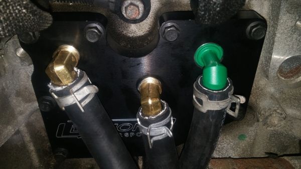

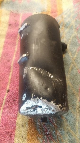

So about two weeks ago I hit steel plate in the road covering some construction that took out my sealed catch can. I also had the dipstick pop out and the last track event so it was time to swap out the catch can, add a PCV plate and a VTA catch can.
Original catch can destroyed. It usually tucks up in the bay but must have been hanging too low.
Damond Motorsports PCV plate. Nice quality.

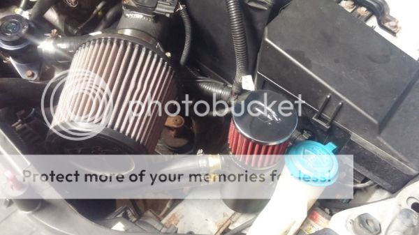

eBay VTA oil catch can. Nice piece for $60 but the filter it came with would not fit worth a damn. I'm a pretty patience fellow when wrenching and I smashed the s*** out of the original one it came with. I greased it all up, even trimmed the lip down to fit better, no chance. Luckily I stumbled across this K&N unit at Summit Racing when I was picking up a new hose clamp.

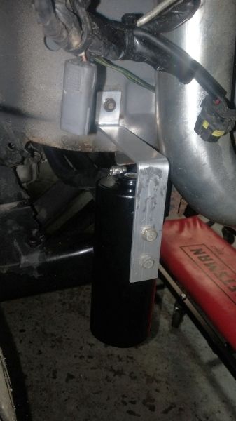

The DM sealed can mounted just above the front subframe so I shouldn't have this problem again. Dat homemade bracket doh.

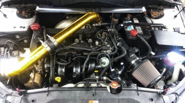

Also painted the IM the fastest/best color of all the colors. The valves looked pretty good too since the EGR is deleted and the catch can was installed by Jake at 138k miles. Also installed the G+ Plus (eBay) silicone radiator hoses I had sitting on the shelf and a coolant flush and oil change.
The car wouldn't start when I got everything back together. Oops, forgot the TB sensor plug. And a ground to the HPFP. Car idled great, no vacuum leaks and ran well but I kept getting a CEL for the knock sensor. Oops, forgot to plug that it. Took her for a test drive and all seems well. :)

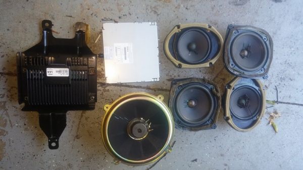

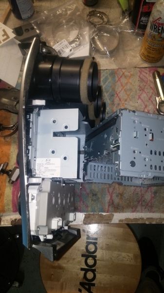

Removed the factory stereo. The Bose system sucks, I can't hear it over the exhaust and I wear my in-ear-monitors while on the highway anyway.
The factory headunit actually disconnects from the face so the stereo controls are still there just non-functioning.

Were the speakers just direct plug and play? I read somewhere that the Bose system to replace things are a little tricky

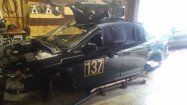

Fatty and I broke up. We love each other but just aren't IN LOVE with each other. A full part out has commenced.
