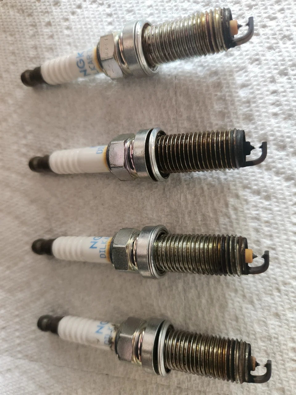

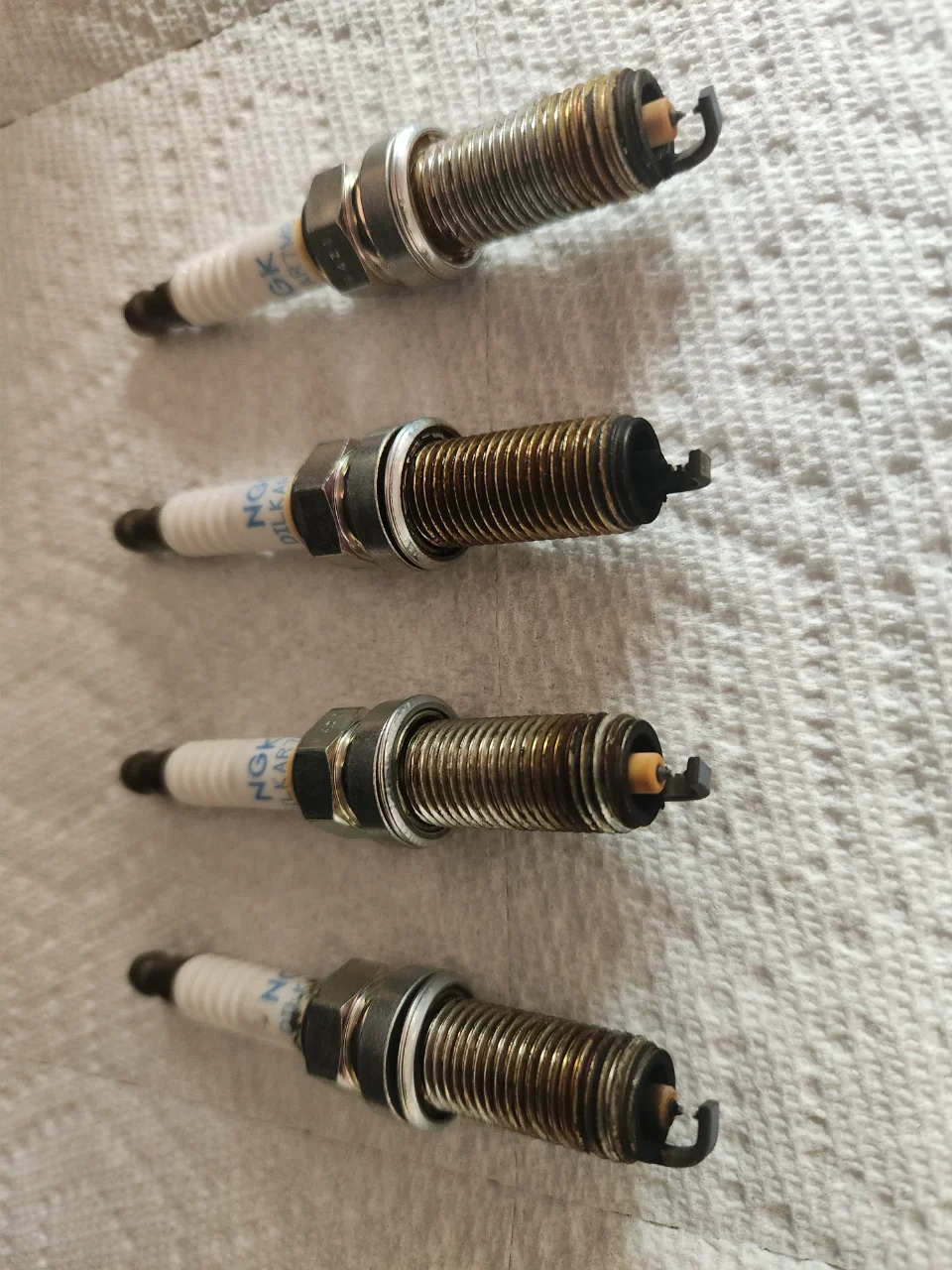

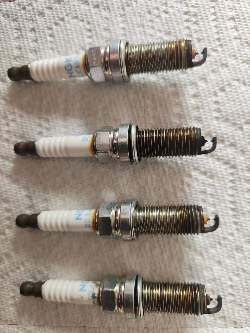

Pulled the plugs in order 1,3,4,2 and found cylinder 3 plug covered in soot, threads dark and, slightly wet and smells like gas. Cylinder 2 plug also looks a little funky.
What does that suggest? Where should I investigate from here?

Did you see my plugs above? Cylinder number 3 (second one from the top)is the plug that is all carboned out and smelled like gas when I removed it. Cylinder 2 plug is a little suspect as well.(Last one on bottom)

Oh I forgot to mention that I measured the plug gap on all 4 plugs today after pulling them out and I found the gap to be .27 on all of them which I though was unusual because the spec for the engine is .30.
So, the fact that the plug smells like gas and looks sooted up would mean its not firing correctly right? Injector leaking into the cylinder or bad coil? Coolant intrusion dilution causing a no ignition?
