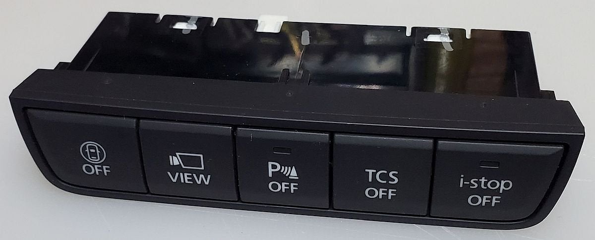

I posted this on another Mazda forum but have not had anyone give it a try. Maybe one of you will try it. Please post your findings. I'm under the impression that the istop eliminator dongles just short out the manual off switch? Just guessing.
This is what I posted.
This happens to bring up something I have been thinking about. It seems that no one has developed and marketed a istop 'defeat' module as is available on other cars. I remember a post where someone took something like a bit of match stick, or something and jambed it in beside the switch button to hold the button in all the time. My 23 CX5 does not have istop so I cannot test this personally. What if:
You start your engine, then
push in and hold the istop defeat button, then
while still holding the istop defeat button in, turn off the engine, and while still holding the button in, you restart and drive a bit.
Does the istop remain defeated, or has it turned itself back on... remember you keep the button pushed in continuously for the duration of this test.
If the istop remains non-functional, then it would be a simple matter of pulling the switch, or going under the dash and jumpering the wires of the istop switch so you have permanently replicated the test.
If anyone wants to try this, please post here for discussion.

I’m working on the same issue for my 2025 CX-5. There doesn’t seem to be any dongle or wiring harnesses available for this model. I think the harness essentially has a delay circuit when the ignition power is up it waits a few seconds, and then closes the circuit for a short time to act as if the button got pressed. I’ve actually developed a similar circuit for my heating blanket so that I could automate it. It’s real easy to make, just a couple of transistors and capacitors and an optical isolator. Less than $10 in components, not including special connectors. If I get around to making it, I’ll share the details here. I’d really like to see the wiring harness diagram and pin out for the switch first, but I don’t know where to find that.

I posted an experiment (#12 of this thread) to see if a technique works. So far no comments and no one has reported trying the experiment. I don't have i-stop on my 23 so I cannot try it. If it works a simple wiring jumper would be easy to do. If it does not work I suspect a simple home made circuit that senses ignition or starter voltage and then activates through a momentary relay the equivalent of pushing the i-stop deactivate button would be easy to build. If I had the need I would have already attempted this. I'm positive we have many on this forum who could easily build such a circuit. Just a suggestion. Love to hear your comments and hopefully some results.
Sorry, but that's not how it works (at least on my CX-50, and I've no reason to think the CX-5 is different). The buttons are just inputs to a microcontroller, which sends commands via a serial interface to the BCM/ECM. The istop 'dongle' actually connects between the switch unit and BCM/ECM and sends the serial commands itself.
It might be possible to solder wires across the switch on the PCB and exit them from the unit, but the switches are surface mount and the contacts very barely exposed.
For more detail on my CX-50's switch/PCB/unit, see:
