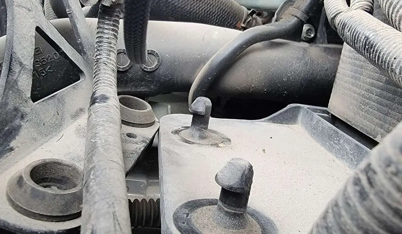

I'm not sure I understand the "plastic pins at the bottom of the airbox" part but I definitely see the #2 grommets. They are currently attached to my air box. For clarification, the deer strike was a year ago and almost totaled the vehicle. What I meant was that this weekend when doing the work I felt like I didn't pull the airbox out with excessive force that would have broken anything off, and I did not find any pieces indicating that I did.
There should have 2 guide pins stick into these 2 holes showing in your picture.
I went out to my car to take a pic. Sorry, engine bay is dirty! This is from a 2018 CX-9, but the mounting pins for the airbox should be the same.
These are what the "pins" look like. In my experience, they don't come off easily, but I think they can come off with enough force. If they aren't still attached to the bottom of the OEM airbox, I'm not sure how else they could have been removed, other than that collision you mentioned. I don't think it's a huge deal if you're missing them though. You could just use zipties to secure the airbox using the same holes.

@sm1ke Thanks for the pictures-appreciate that! Hmm.. definitely think that I would have noticed ripping those out the other day. My hunch is still that either the impact of the deer sheered them off, or the garage fixing the vehicle violently removed the airbox. Who knows. Haven't found any piece around in the undercarriage panels or anything.
