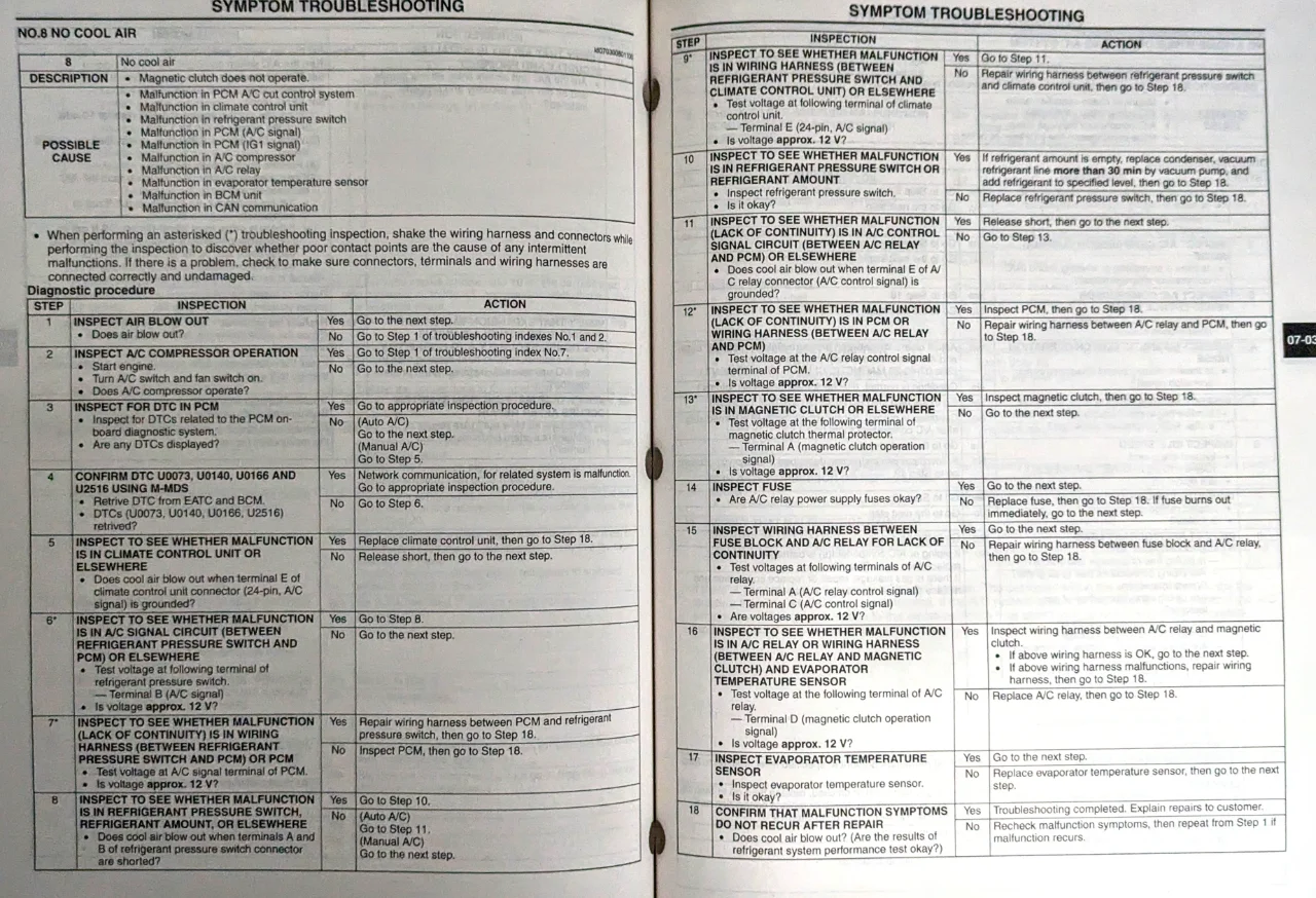

If you can track one down, the service manuals have diagnostic step by step to figure out stuff like this. Better than throwing in parts in the dark. In the '07 manual thers 10 causes for "No cool air" and most are comms and wiring, not parts. I've attached a copy of that section.

Thanks for the info. I do have the service manual and will crack it open.
