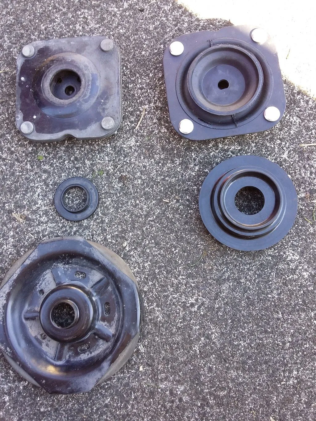

The steering rack is rubber mounted and it probably isn't those causing the clunking but it won't hurt to check, if you go for quick struts they'll come with strut tophats, if not, they look like this:
( the parts on the left are OEM, the parts on the right are parts that weren't quite right)
The little plastic bush in the middle can wear out and slop around.

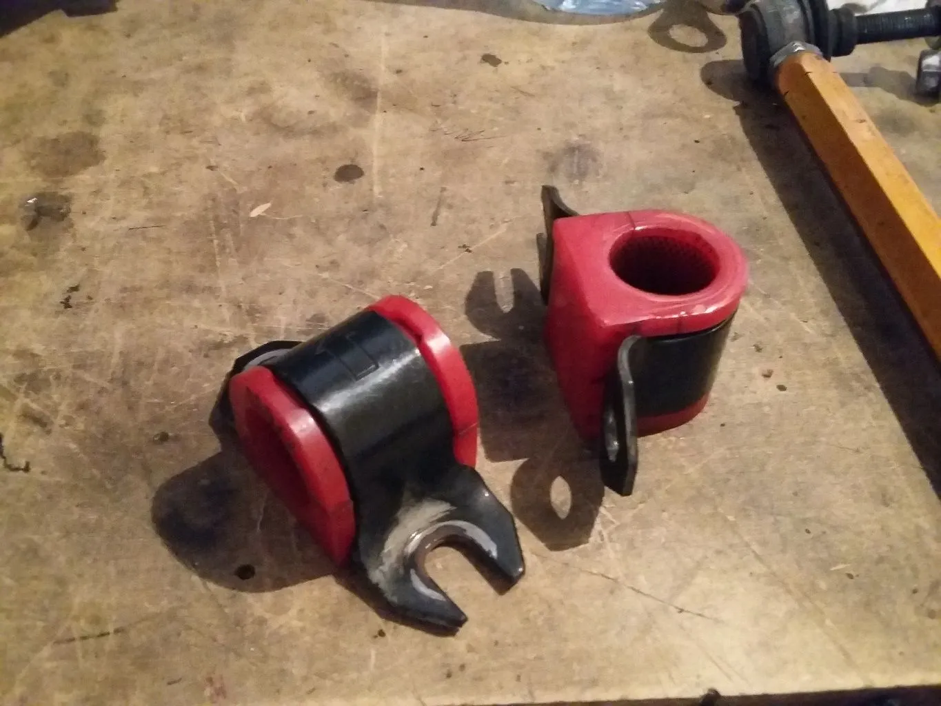

Swaybar mounts look like this:
These came from Nolathane, I don't know who the US equivalent is though (Superpro or Energy suspension most likely) they're cheap and easy-ish to replace
Ford Escape swaybar links fit (I think, haven't personally tried them) and are slightly thicker than stock. MOOG aftermarket links appear to be the best bang-for-buck option

The front struts have a bushing or bearing in the strut mount (top hat) to allow the strut to rotate when the wheels are turned.
I don't know if it is an actual bearing (with ball bearings) or just a bushing.
That bearing can seize up and start to clunk or wear out and get sloppy.

Alright, so I'm looking into those aftermarket polyurethane swaybar mounts and i'm not having a lot of luck. Per LankyKiwi's recommendation (thanks!), I checked both Superpro and Energy suspension and neither appear to make Mazda Protege parts. Went to eBay and this is about the only thing I found: Siberian Bushing. Advertised inner diameter of 25mm.
I double checked inner diameter of Moog OEM-style mounts: 1.380in (~35mm). Not the same.
Also checked an OEM Mazda part supplier and while they don't list inner diameter, there are different parts for "Sport" and "Non-sport" suspension. I'm sure this question has been discussed, but does anybody have an explanation for this or a recommendation on where else these parts can be purchased? Thanks.
Benji
Edit: Forgot to mention, but for what it's worth, I took a look at the suspension components in question and my suspicions were once again confirmed (had a mechanic look at them in the first place). The swaybar mount bushings are especially cracked and torn. Definitely gonna want to get it all replaced as soon as I can, especially because I can put my new wheels on then too!!!
The 25mm bushes are for the Mazdaspeed proteges with the beefier front swaybar, the stock P5 uses a 23mm front bar (at least it is here, not 100% sure about USDM cars) I'm guessing the OEM varieties will be for the Pro5 (sport) and non-pro5 versions of the protege.

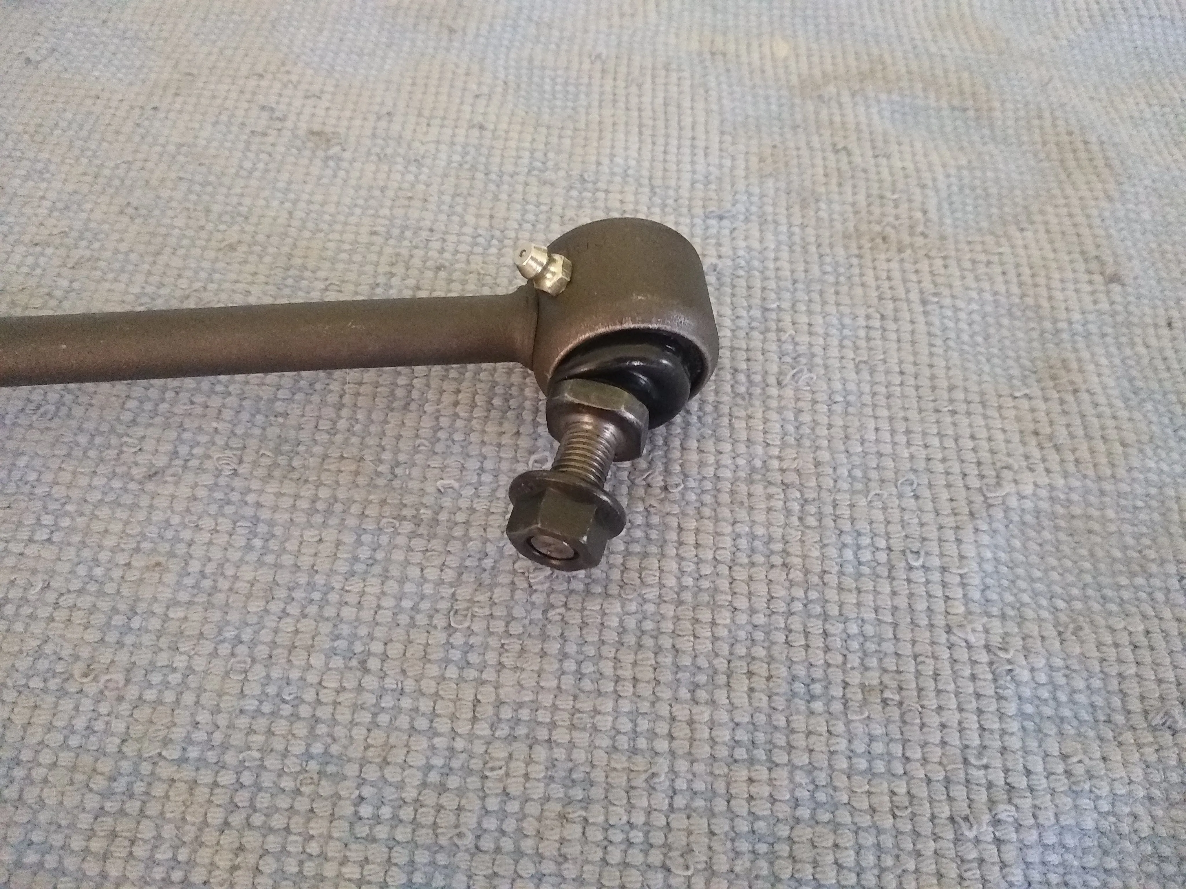

Quick question.
This is one of my new Moog end links. I see that they have these grease nobby things. Do I need to fill them with a grease/lubricant, and if so, what tool can I use to do this and what's recommended to put in it? I don't have any specific equipment to do it, but if it needs to be done, I'll do it.
Thanks,
Benji
That's a grease nipple. You need a grease gun to pump the grease in.
You can get one for about $25 or maybe a friend or a trip to a shop for a few squirts of grease.
I'm pretty sure you use chassis grease but I just use whatever grease I have.
It sucks to buy a grease gun and grease for just two end links.
I bought a grease needle for my grease gun so I can fill all my rubber boots with grease so there is no place for water to go and it keeps things from rusting.
You poke the needle through the boot and pump in the grease.
