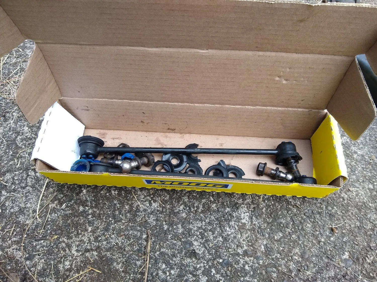

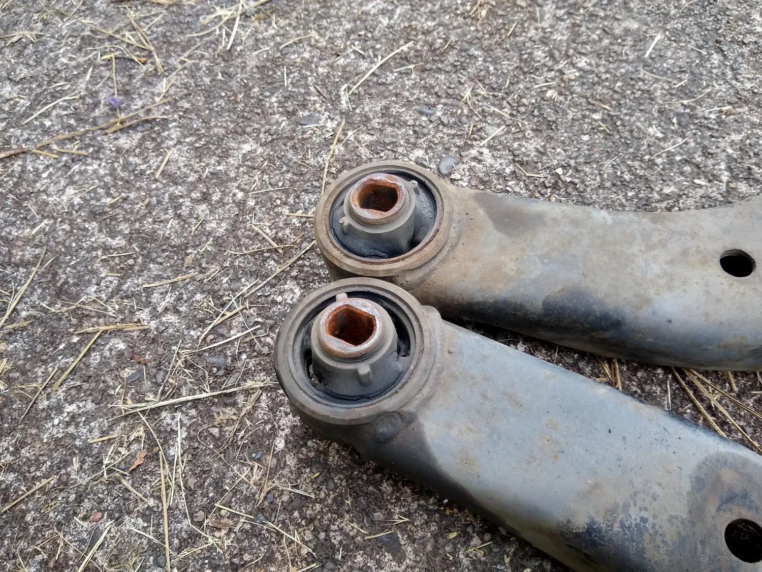

I ordered the following parts:
  • Moog outer tie rod ends (46A0729A)
  • Delphi lower control arms (TC2523, TC2524)
  • Moog stabilizer bar links (K750385)
  • Energy Suspension polyurethane stabilizer bar bushings (9.5127R)
I installing everything except the bushings, as I couldn't find any way to easily get to the rear bolts on the brackets with enough leverage to break them loose. Went ahead and returned them, but they were the correct size (23mm) for my stock bar, so I suppose I would recommend them.
The work went okay but there was lots of carnage getting the old OEM end links off and tie rod end nuts loose. Mostly just issues because of lack of experience and stuck bolts. My car isn't rusty but it looked like things hadn't been touched in a while. Old parts:

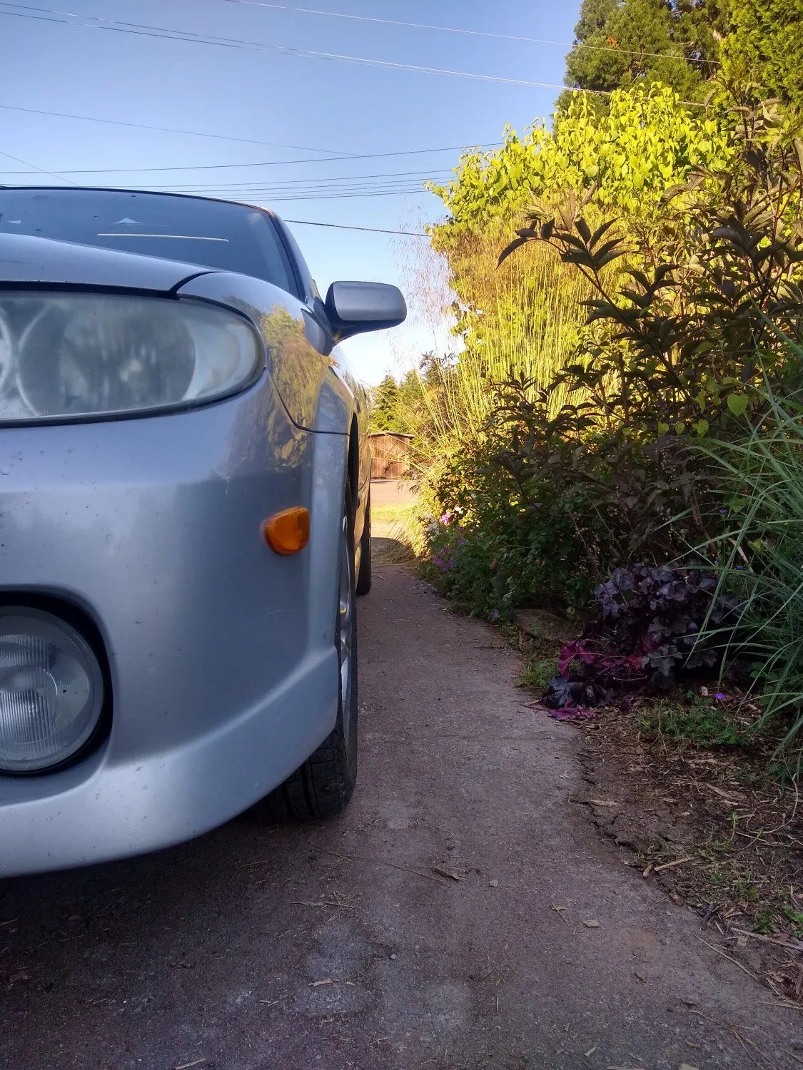

One other thing I've noticed is what appears to be a difference in front camber. I swear it looks like the front wheels are negatively cambered slightly, but this could just be paranoid me, and it's challenging to show in a photo (also lower offset wheels don't help). I'd like my camber to be stock to match my stock suspension, and I don't know of a way to adjust it on a protege without aftermarket modifications. Can I check camber and try to adjust it on my own, or just leave it to the pros at a shop to do it? I'd rather have everything sorted before I do an alignment if possible.
I've put probably 30 miles on the car so far without an alignment (my tires are a trash brand that came on the car, so I don't care about them much) and I'm going to get under there before I get an alignment to check all the bolts and make sure all looks good.

One other thing I've noticed is what appears to be a difference in front camber. I swear it looks like the front wheels are negatively cambered slightly,...
The stock struts have four positions to allow for caster/camber adjustments.
The nut in the middle isn't quite centered so you can remove the four nuts and spin the strut and reinstall it in a different position to adjust your caster/camber.
Judging your caster and camber by eye isn't really possible and it doesn't make a whole heap of difference.
If your car is tracking straight then your caster and camber are probably OK but it takes a proper alignment to find out for sure.
