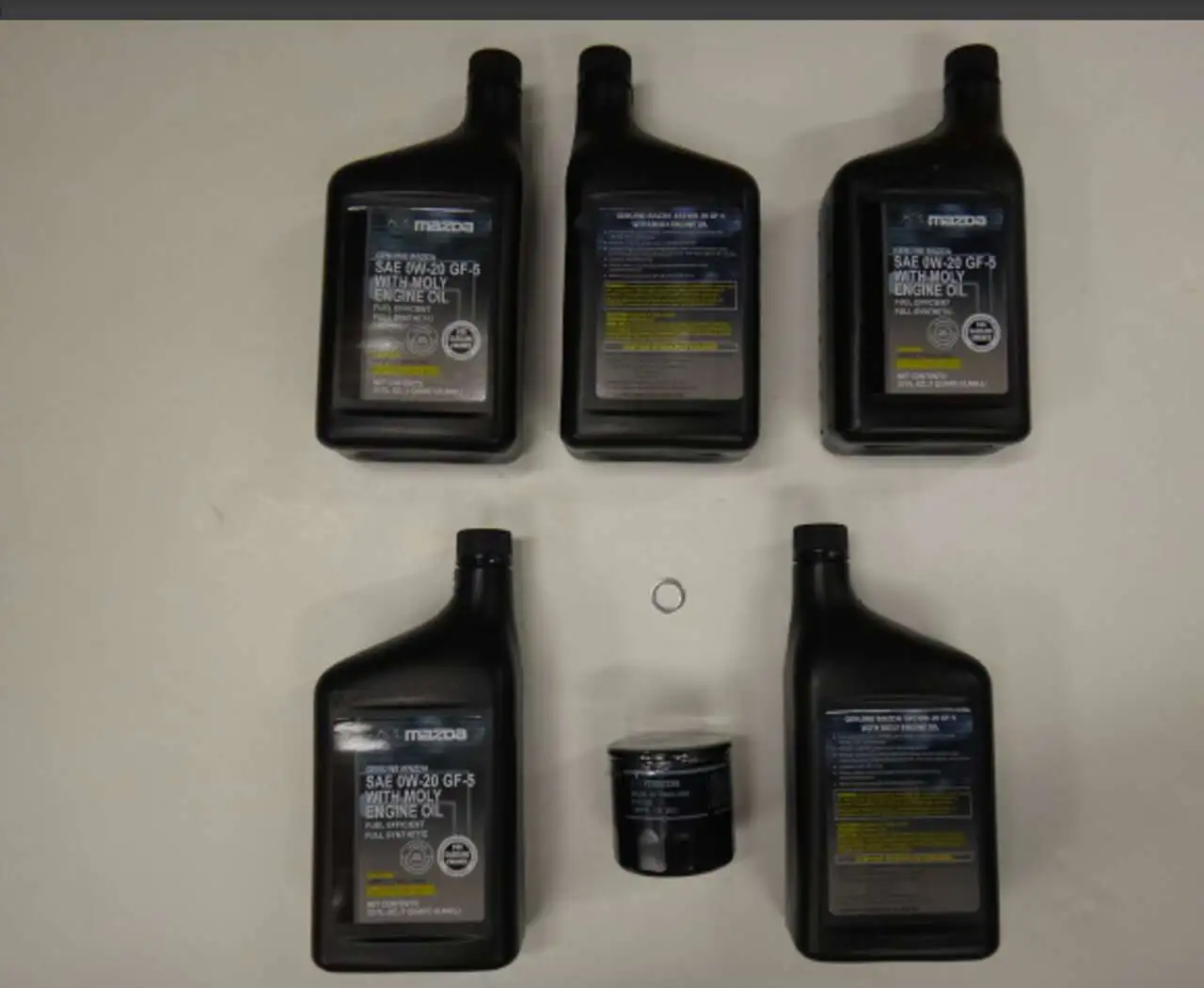

I’ve been use these kits
As of ‘22 I was paying $59.52 an oil change. Now they are $67.58
At least you don't have the turbo motor so you stress the oil less.
For comparison, 5 qts of PUP plus a Mazda filter costs me $39.
