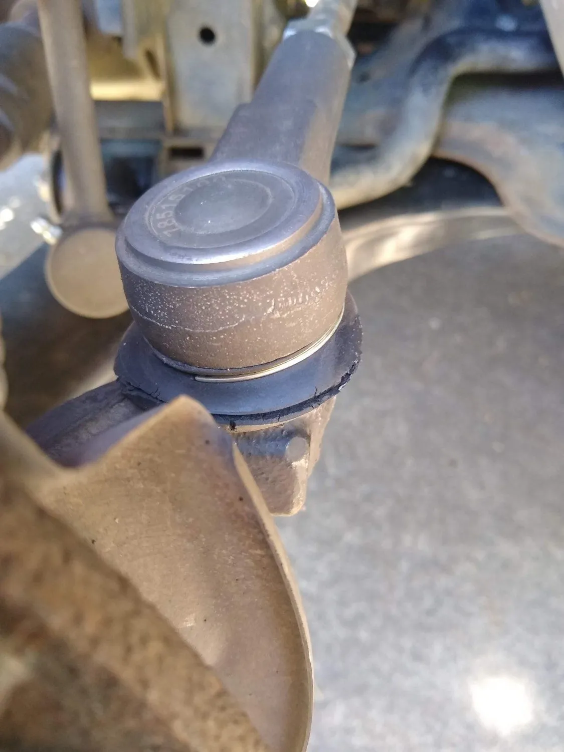

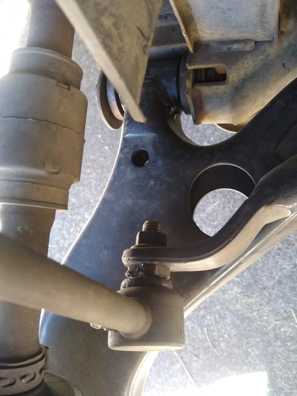

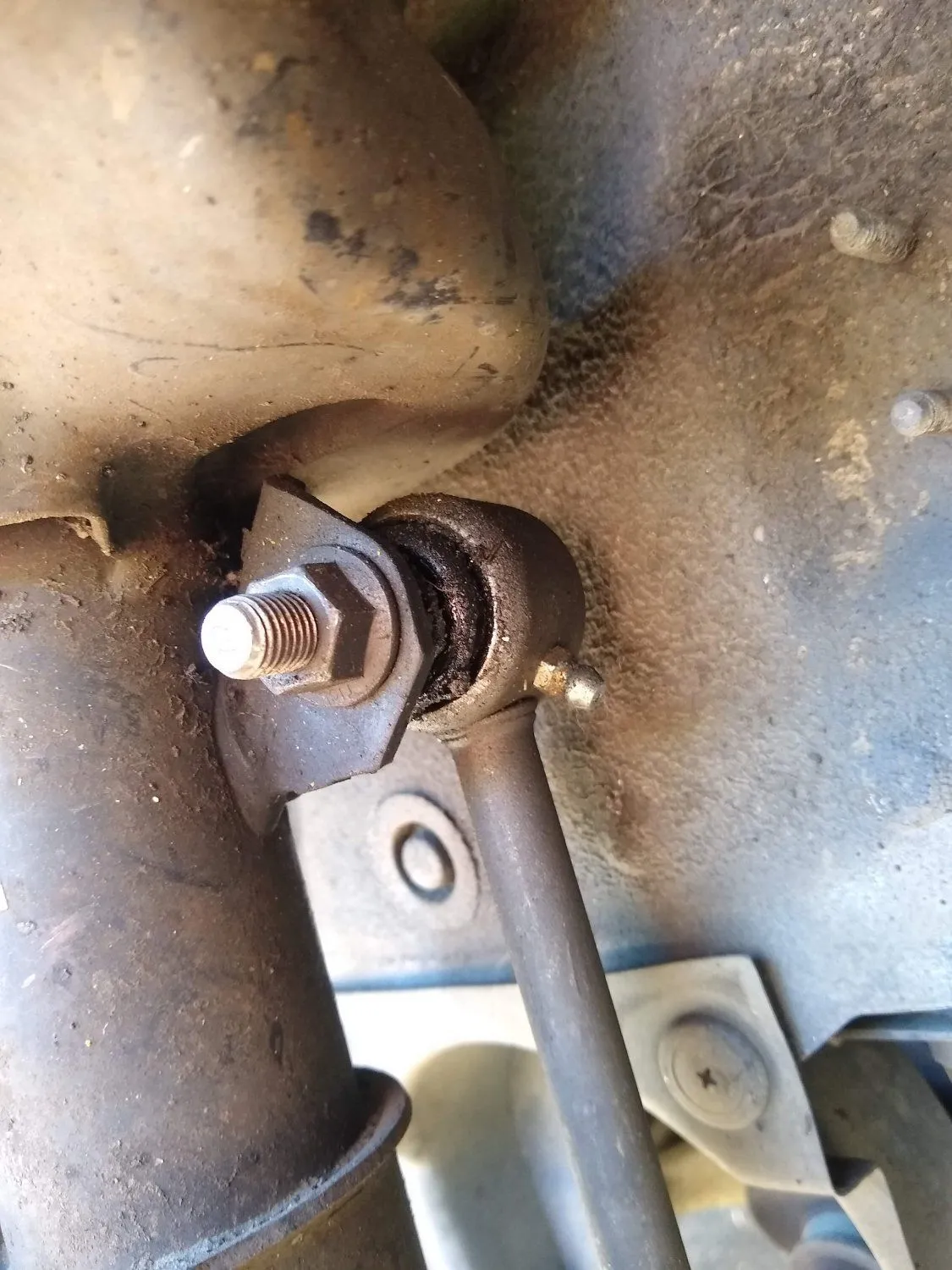

Pulled the front wheels off recently for unrelated reasons and saw that my outer tie rod end and swaybar link boots were torn or tearing, with grease was coming out. It's been about 4k miles and a few months since I did the work, which is why I'm concerned. I greased all parts to the best of my ability (using a terrible mess of a cheapo harbor freight grease gun) but I'm wondering if the grease I used degraded the rubber maybe? I think it was general purpose chassis grease or something like that. I've attached some photos below...anybody have thoughts?
I don't hate doing this stuff, but I do hate the idea of redoing it, then needing an alignment again, then also the fact that I have a shake in my steering which I don't think is alignment/balance/wheel related but I would then want to fix at the same time, more money and time commitment yada yada yada.... As a semi-novice at working on my own car, the whole thing just bums me out.

... I'm wondering if the grease I used degraded the rubber maybe?
I'm thinking that's possible but the joints are designed to be greased, and if you are only supposed to use a certain type of grease, then they should make it clear in the instructions.
If you can't get replacement boots and need to replace everything, you might consider just leaving it as it is.
If you regularly pump fresh grease into the joint, it will push out any dirt and water and do an OK job of sealing the joint.
You may as well just drive it until they start showing signs of wear.
Any chance there is a warranty? You're not gonna get labor back which sucks but if you could get free replacements it'd make it a little better.
I can't imagine grease would disintegrate the boots, that'd just be stupid.
This is what I'm thinking I'll do, for now. Maybe checking in on them occasionally and eventually replacing.
Oh that's a great idea. I don't remember what brand the tie rods were, but the endlinks were Moog, and I've heard good things about them. I might just try and ask their support and also see if I can get replacement parts for if I do want to replace stuff again down the road. I did the work myself and all I've lost is time and money for parts. It took a while but now I could do it again much quicker because I've done it before.
Thank you both, lots of good thoughts here. I'll probably pursue the route of contacting support and seeing what they have as an explanation, and if they'll send me new ones. Worth a shot.
Just keep pumping new grease in them now.
Let it build up.
It helps stop water and dirt penetration.
Just don't get a glob big enough to fling off and end up on your rotors.
In the meantime, you can order some silicone grease to use on your replacements, If they send you new ones.
The grease is dielectric and can be used on all rubber and even on your light bulbs, battery terminals, and maybe your brakes?
It works great on suspension bushings too.
View attachment 227636View attachment 227637View attachment 227638

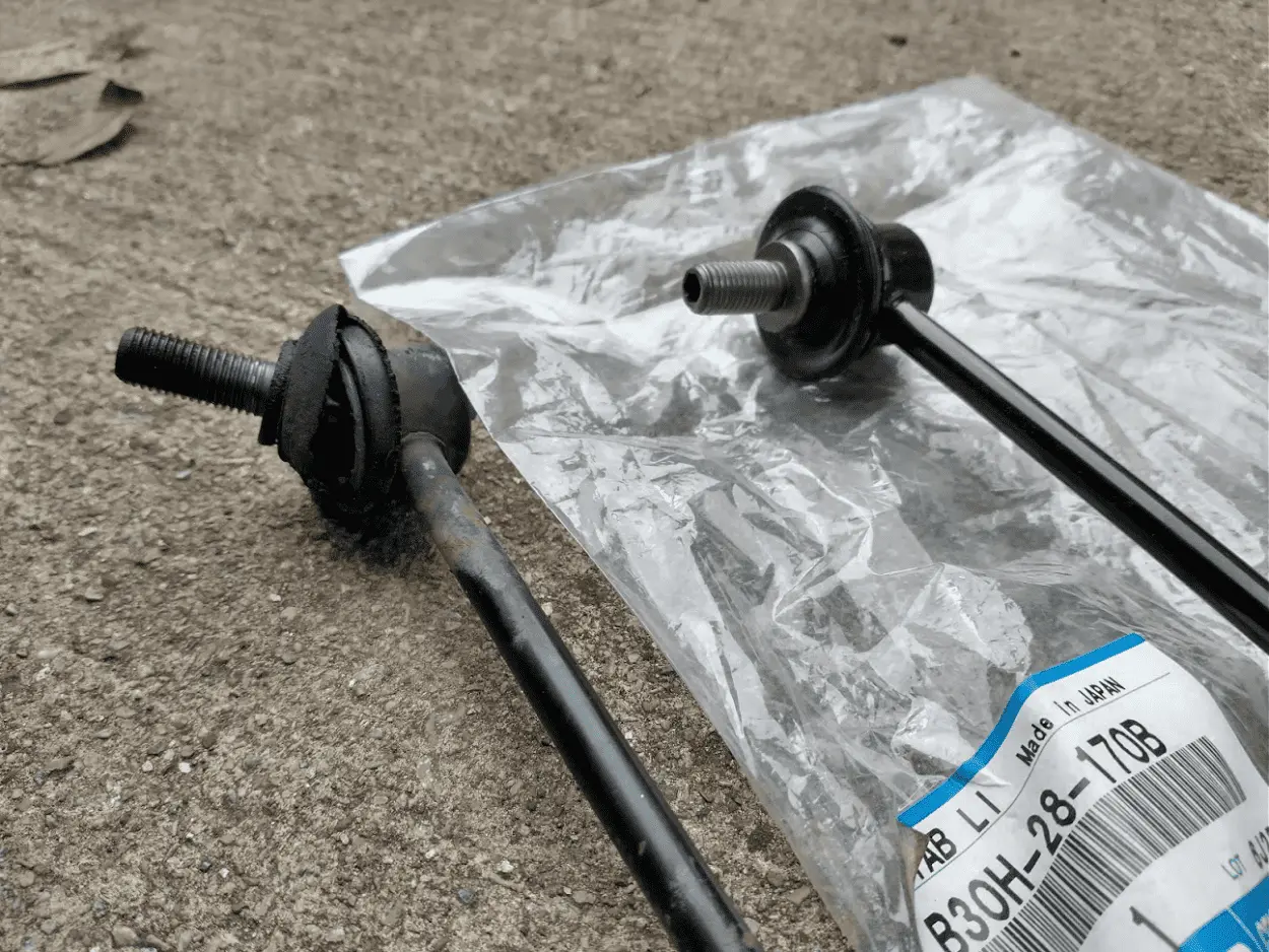

I replaced my rear end links today as they have been torn for years (original parts that came with the car; I should have replaced them when I replaced the struts). I used genuine Mazda parts based in part on your experience and because they were only $30+ apiece. Edit: That's not a whole lot more than the $20+ a decent end link goes for on rockauto.com.
Bought two genuine Mazda front end links yesterday for only $20 apiece on eBay. There are two left in stock if anyone here is interested. Mine will arrive in a few days.
Note the caveat, but I don't think they'll be so old that the boots are dried up or anything. I mean, even rockauto.com buys up surplus parts don't they?
"We are a surplus wholesale dealer. All our parts are (NEW OTHER) unless otherwise specified.
"The majority of our parts are left over merchandise from closed auto parts stores and manufactures that are no longer in business. These items, although NEW, are not always crispy clean like you would purchase from your local retailer. They may have been in storage anywhere from 1-30 years. Rubber parts, gaskets, hardware may need to be replaced and may not be useable. There may be minor corrosion, scuffs, torn or missing boxes, scratches from storage, etc., none of which makes the part Defective."
Update: Genuine Mazda parts (included stickers) arrived yesterday and are in good shape. Two units still left in stock at the link above.

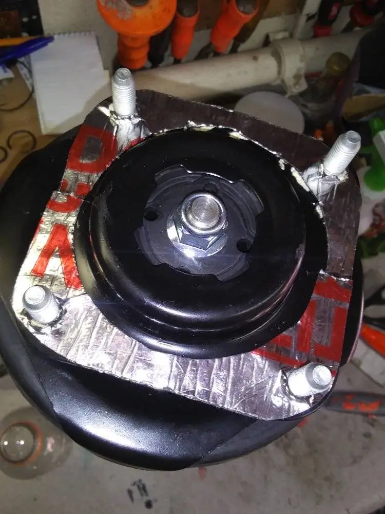

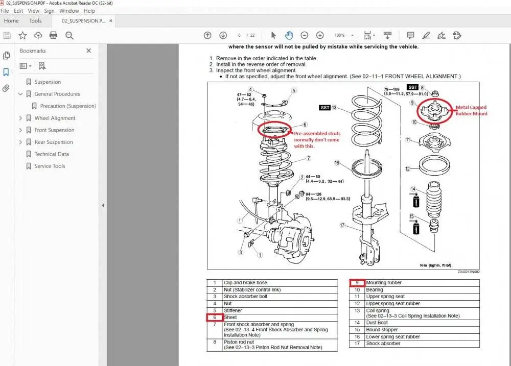

-Fully Assembled Strut Assemblies and Noise-
Bottom Line Up Front (BLUF) - I normally make a isolation/damper gasket to go on top of a New fully-assembled strut assembly to reduce/eliminate metal-to-metal contact between the top of the strut and underbody surface where the strut plugs in.
(Fully assembled strut assemblies normally don't include this gasket/sheet for mounting).
I noticed when replacing the OEM P5s strut assemblies, between the top and underbody mounting surface there was a paper-thin piece of clear plastic ("Sheet" - see illustration below) for this mounting and I used that sheet as a template to make strut gaskets of sorts using (about 1/16" thick) peel-and-stick rubberized window and door flashing to act as a isolation/vibration damper for this area - (see photo below).
---Why?---
I first noticed a obvious metal-to-metal thumping noise right after installing new fully assembled strut assemblies on the front of my old 2000 Maxima. Back then, I used regular (about 1/8" thick) gasket material sheet strut gaskets between the struts and the car's underbody. The isolation/damper gasket cleared up the noise.
