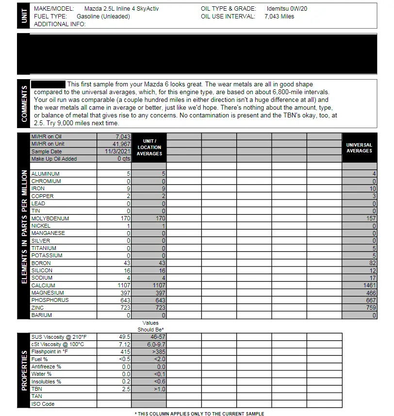

Not true. This is from a couple of years ago. 7k miles on the oil and viscosity is right where it should be and there are plenty of additives left

Well, that is just my impression based off the way the oil looks and drains. The remaining viscosity is perfectly acceptable, but it's lower to begin with and towards the lower end of the range once it's been used. Either oil will protect the engine properly over the rated oil change interval, which is why both oils are rated acceptable by Mazda for use in this engine. I really just prefer 5W-30 because it's so much better at insulating against engine/cabin noise. It's good to see that 0W-20 holds up well over 7,000 miles.

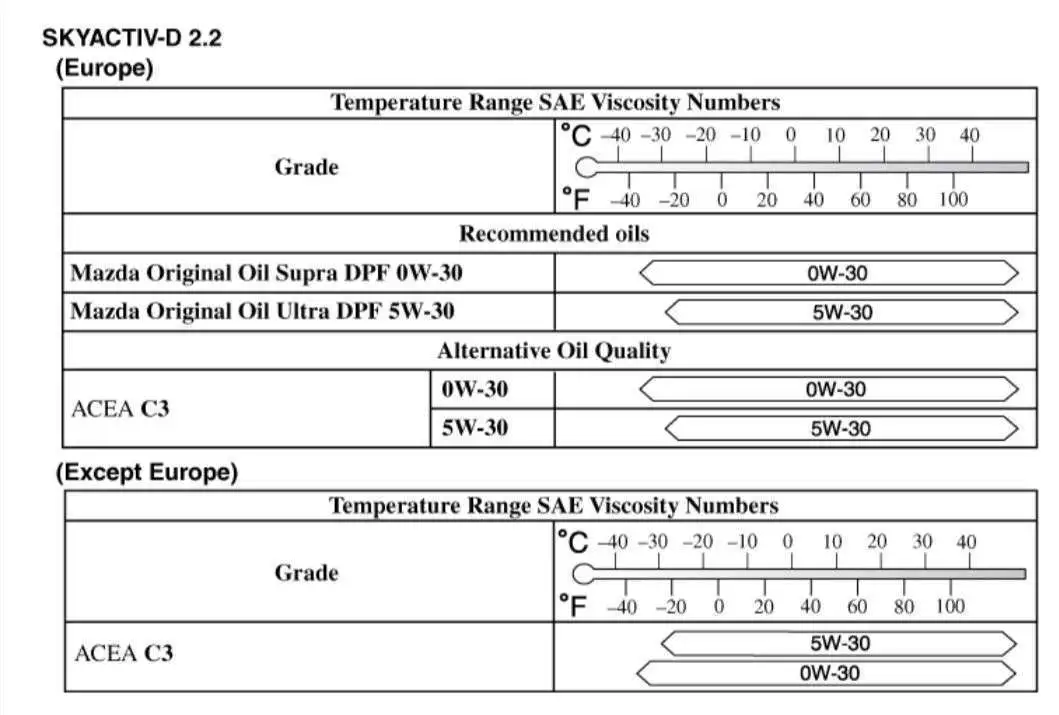

What country? 0w20 and 5w30 are both oils that work in a CX-5. I run 5w30 myself. You can see this in the manual.
