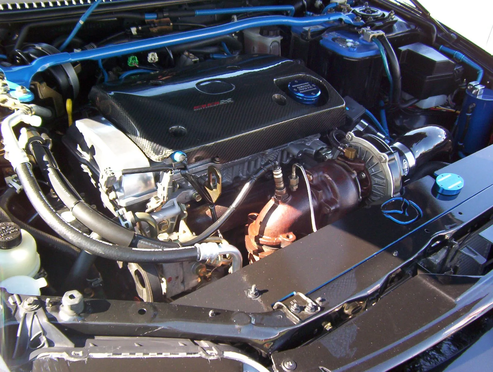

Oh ya... I forgot, here is a pic.

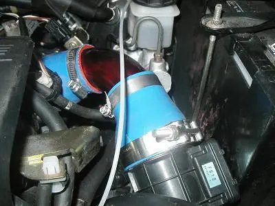

i have had mine set-up like this for over a yr now and i have had no problems with the maf.............
