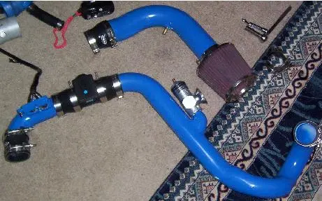

my bov is abt 7 inches from the intercooler on the IC>tb pipe. then 6 inches after the bov is my maf, then abt 5 in from that is my xtra injectors.......which are abt 3 in from the tb
here is a pic of my intercooler to tb pipe. it is blurry but you get the point
cool thanks alot for the info and the pic.

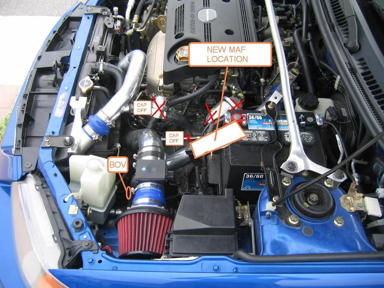

Don't know if you can understand photo, but here it is...
~would this work, stalling problembs Any other issues
See that!

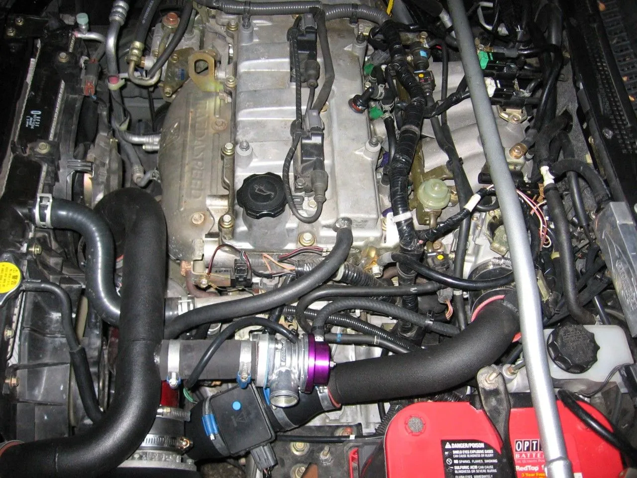

Here's my dirty engine. Mine's pretty far from the TB, but works great.
