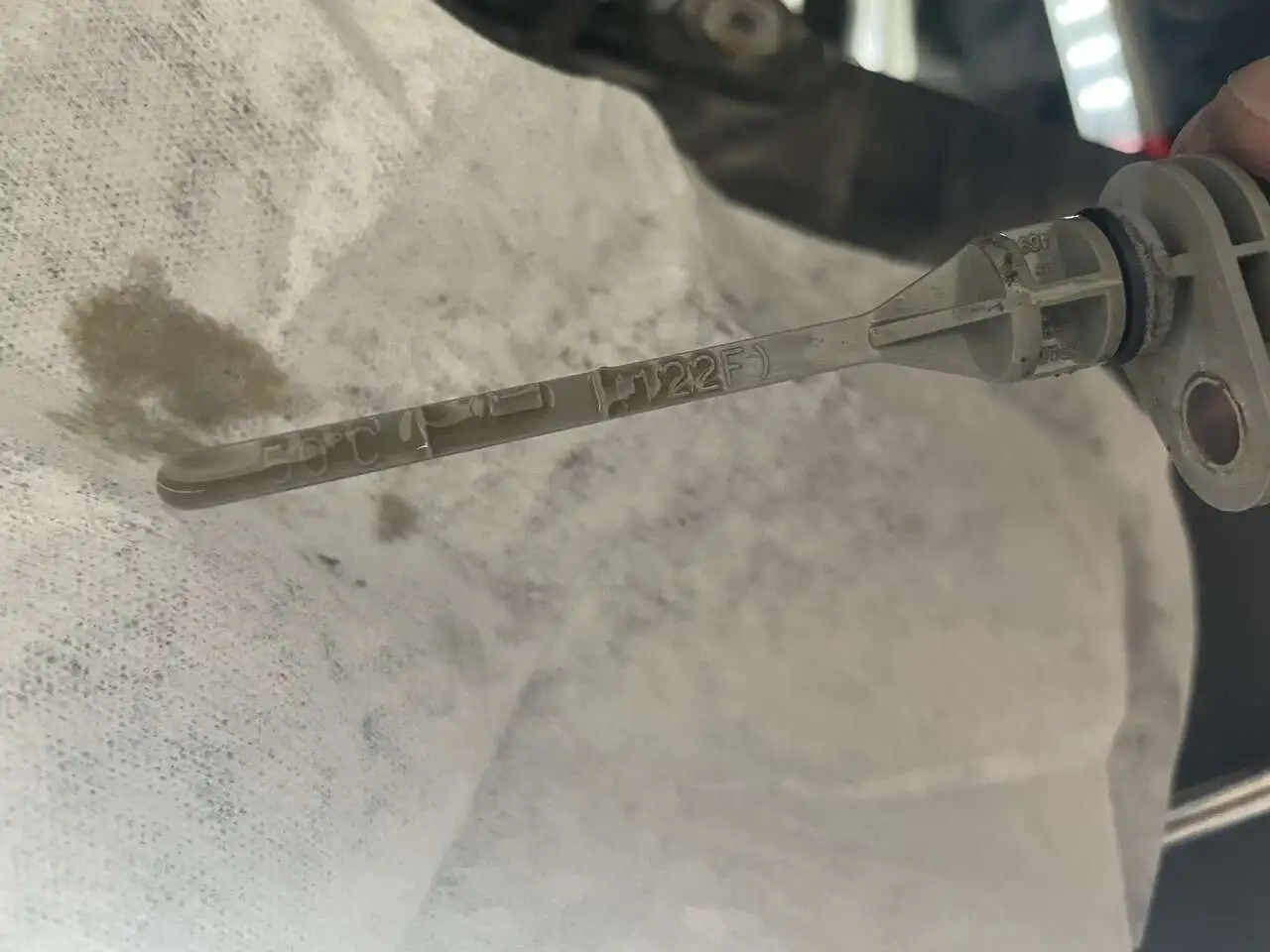

Just checked the level while running for 20 mins but I don’t know what the high/low marks for level is supposed to be it’s not clear from the dip stick.
It changes level with temp. Did you check it with the engine idling and hot?
Idled for 20 mins nice and hot, shut it off and quickly removed air box to access screw, took reading.

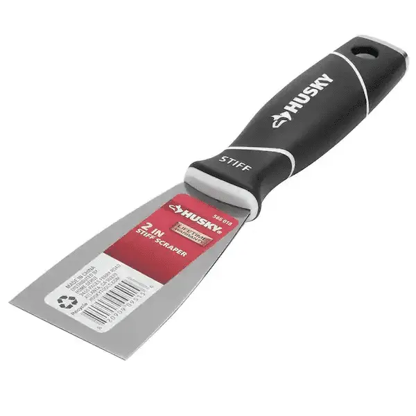

I’m in the middle of trying to remove a stuck pan that seems to be welded on with silicone, tried everything over the last hour, rubber mallet, hitting edges with soft wood and hammer, tried slipping thin scraper tool between seal to get it started and nothing will get in there to break the bond… thinking of going to heat with propane torch but that seems extreme. I don’t know what else to try.

If the engine isn't idling, you won't get an accurate reading. The transmission pump has to be running.
As far as removing the pan, the factory RTV can absolutely be tough. When I removed mine for the first time, I used a 2" paint scraper to break the bond. I started at one corner, then worked my way around. Once you break about 6", the rest will come off.

Sure did. I’m not alone on that though. Lots of folks reported slight underfill on the transmission on earlier models (mine is a ‘13), and the rear differential fluid being way less from the factory than the volume reported in the owners manual.
