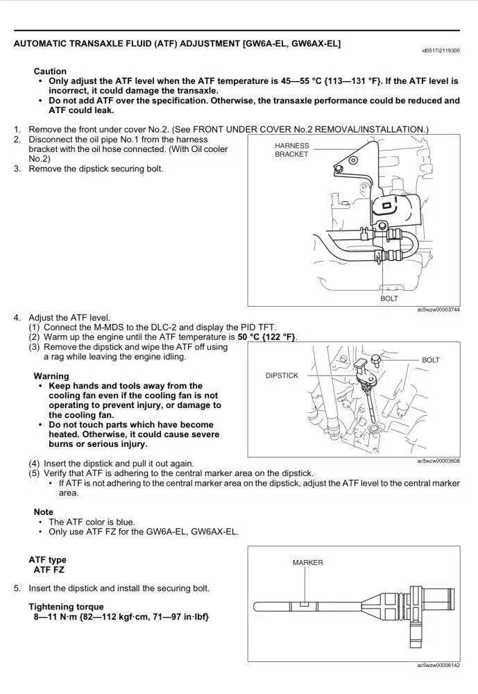

Yes, the square marker is the target ATF level at 122°F with engine idling. If this’s the first ATF change with the pan dropping, you can do 2 more drain-and-fills and get about 87.5% of the fresh ATF content. And you can adjust the ATF level properly in the final drain-and-fill.

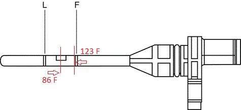

As for how much the ATF level would get affected by the temperature, see this:

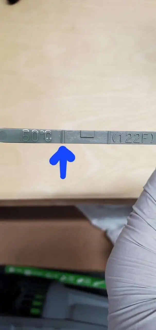

You guys were right, I checked the ATF while idling and it was low. The ATF was at around 25-30 C (77-86 F). I added 600ml and it came up to the middle of the 2 lines, so perfect. I don't think ATF expansion is that great that I need to check at 122F, and I'm guessing if I were to check at 122F it would be closer to the top line.
I also changed the rear diff and front transfer case, and they both took about 0.5L each. Not too complicated.
Update: I warmed up the transmission fluid to 51C / 123F and re-checked level (car idling, level surface) and it was just below the Full line. MS Paint artwork attached.
Summary: added 600ml to factory fluid to bring it up to full level. I did not drain and fill since car has 30K km / 18K miles.

As long as you have followed the procedure outlined on the Mazda workshop manual: car leveled、engine is idling while checking the ATF level (I’d cycle through the gears at least once before checking)、ATF temp @ 122°F、 and the level is on the “central marker area” of the dipstick, you should be fine. The variation amount of the ATF would be even bigger when you drop the pan, 4.75 ~ 6 quarts have been reported.
