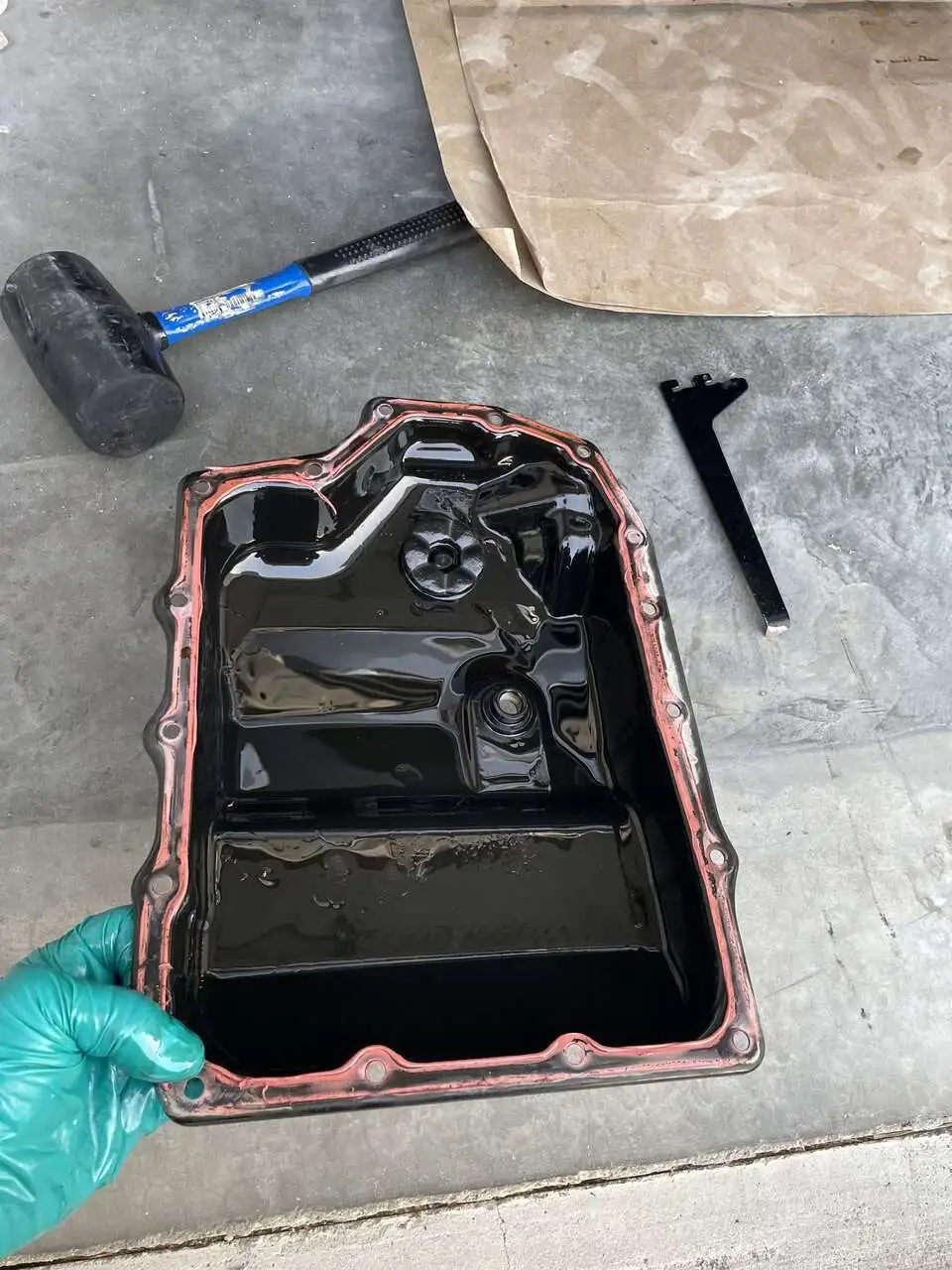

I’m in the middle of trying to remove a stuck pan that seems to be welded on with silicone, tried everything over the last hour, rubber mallet, hitting edges with soft wood and hammer, tried slipping thin scraper tool between seal to get it started and nothing will get in there to break the bond… thinking of going to heat with propane torch but that seems extreme. I don’t know what else to try.

As far as removing the pan, the factory RTV can absolutely be tough. When I removed mine for the first time, I used a 2" paint scraper to break the bond. I started at one corner, then worked my way around. Once you break about 6", the rest will come off.
Well I did manage to free it after some more persuasive arguments with a piece of metal curved and sharpened and lightly tapping it in between the seal going half way around at all access points, eventually enough of the bond broke free I could get my fingers in there and pull down prying the rest away, what a messy frustrating job that was, but it’s done and turned out good! 4.75L came out replaced that and drove it a hundred KM today on my commute, shift is improved but seems to still want to hold on to second gear a second too long when downshifting to first in stop and go traffic, maybe it need to be reflashed?

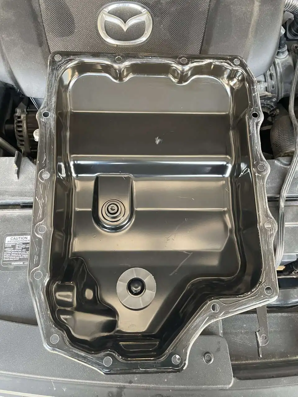

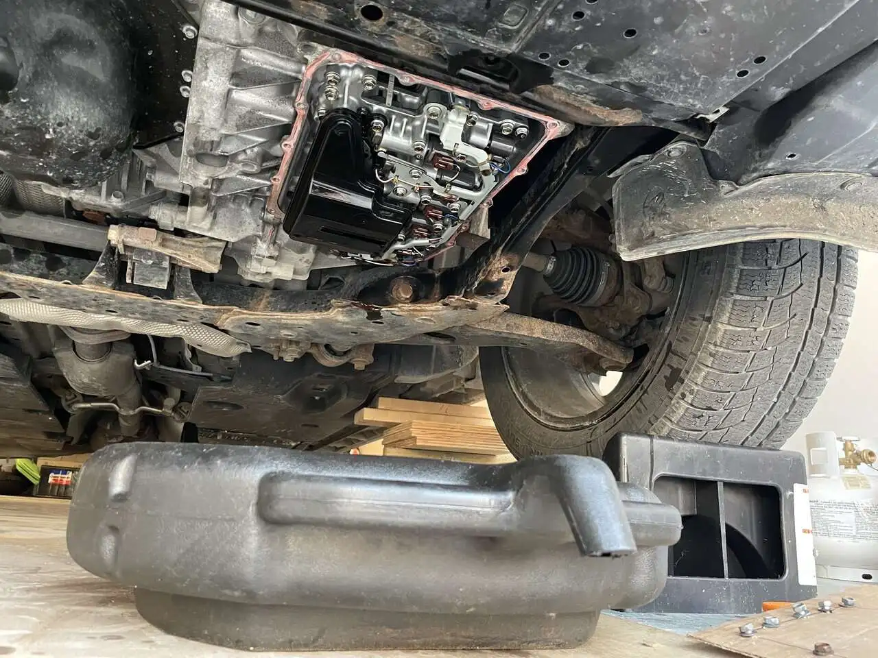

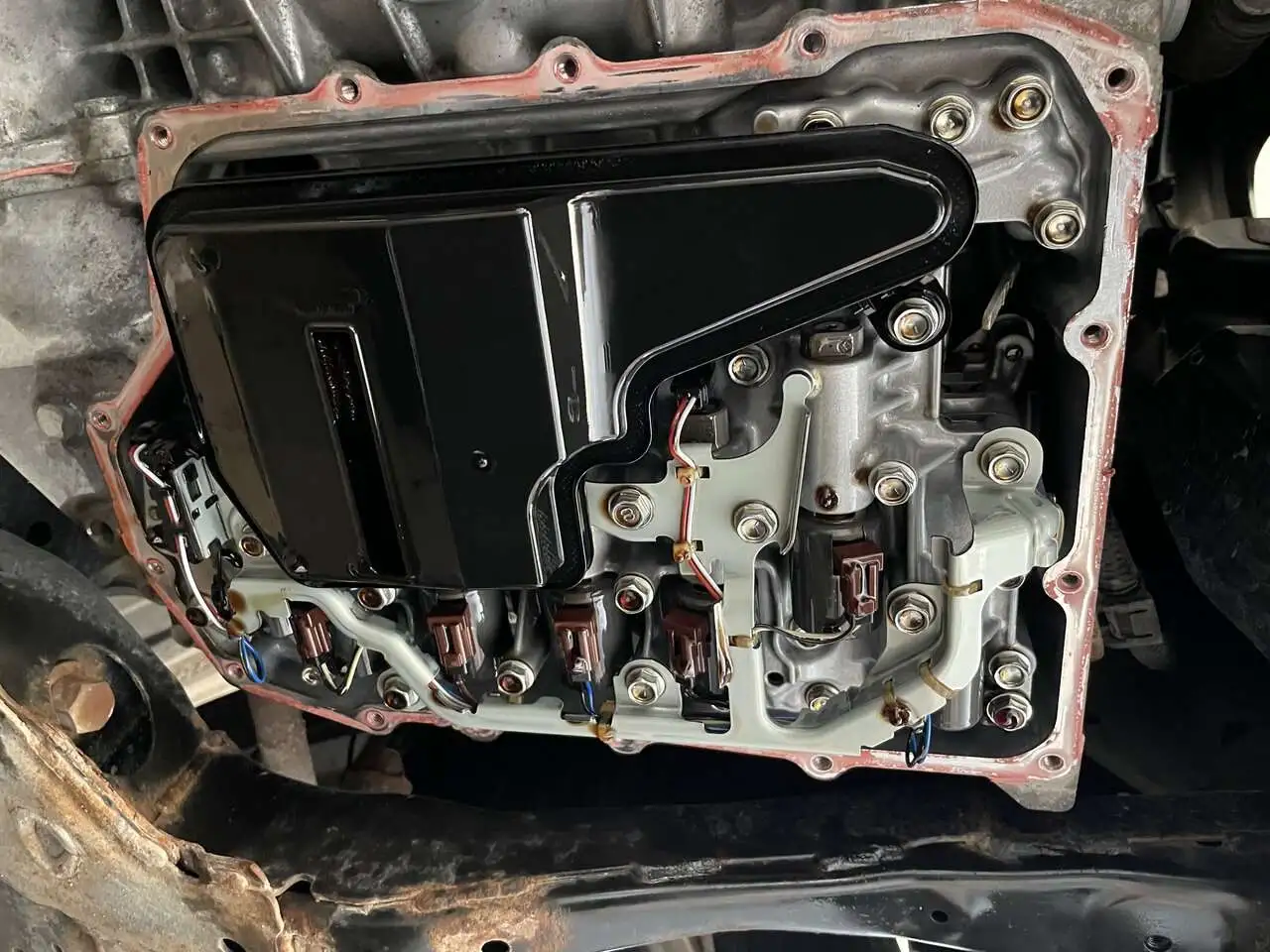

Did my trans fluid and filter on my 2017 CX5 today. Getting that pan off with the factory RTV was a pain. Had to break the seal and then pry it down. The RTV acts like a glue. Then cleaning the pan was another pain. I wish Mazda would just use a reusable gasket with a steel core and outside compressible rubber like on many other cars. The filter came with a cheapo rubber gasket and I don't trust those gaskets.
The trans fluid never stopped dripping, even after hours of waiting. So I cleaned the pan really well and the trans mating surface and then put the Mazda grey RTV on the pan and put it on the trans. Tightened it up and will wait until tomorrow to pour the fluid in to let the RTV set up.

At 53k miles, I have done TWO fluid only changes, this is the first filter change. The trans pan magnet had a decent amount of clutch material on it. Nothing bad but definitely needed to be cleaned. I can't see how people wait until 75k-100k miles to do a fluid/filter change. It's damaging the transmission if you wait that long. The "lifelong fluid" is a marketing joke. Maybe lifelong means 100k miles and the trans fails and you have to buy a new trans.
Hopefully the trans pan doesn't leak. Will find out tomorrow. Measured 4.3 - 4.5 qts of trans fluid that came out.
I'm just gonna pick up a new pan when I do a fluid change with the filter next time. Previously just fluid only the last two times.
I think one would have to let it sit about a day before you no longer saw any drips.
