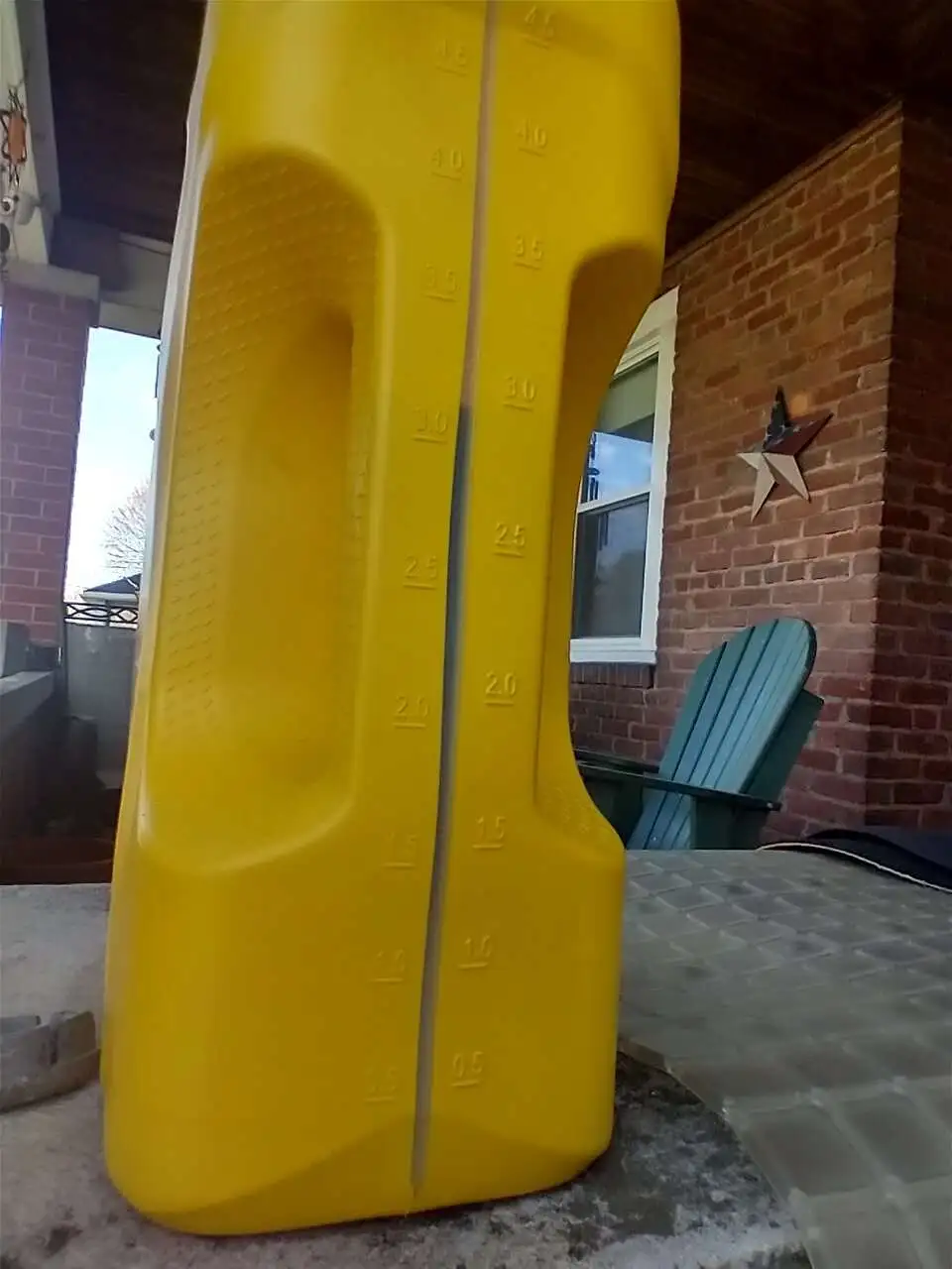

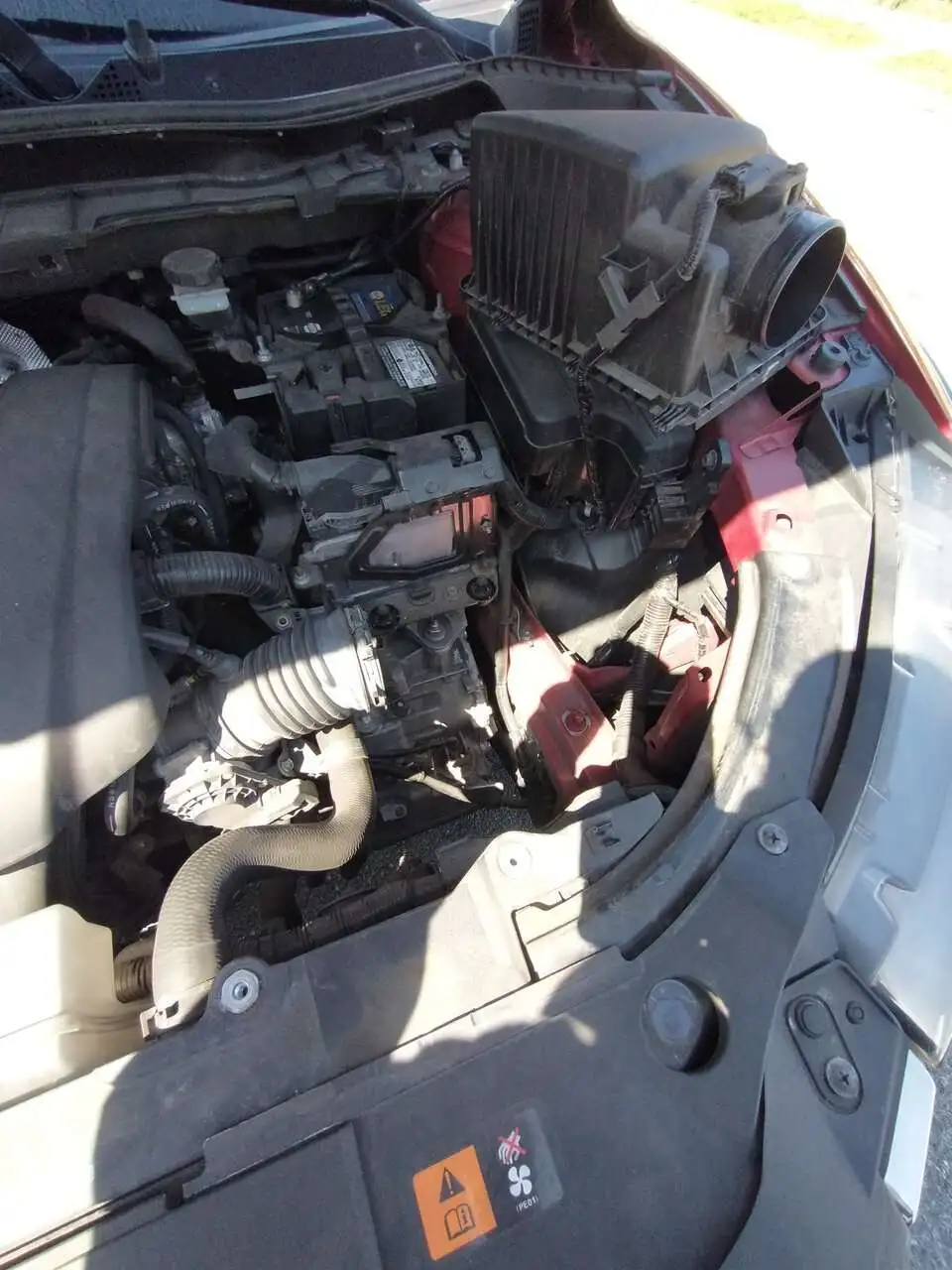

Just did mine today, opted to remove the air box. Really, it's only about 3 or 4 minutes more and you have a whole lot of room to check fluid at the right temp. Drained about 3 quarts and a few ounces, put the same back and the level fell right in line. Hardest part was taking the undercovers off. I hate those push-pins...View attachment 318346
When you removed the air box, did you somehow keep the wiring connected to avoid the error code with engine idling?
Most posts I’ve seen that ~3¾ quarts are the quantity the ATF drained for a drain-and-fill. Yours seems to be on the low side? And you used the same amount to refill. Did you keep your CX-5 leveled? Did you check the ATF temperature close to 122°F when you checked the ATF level?

If you look at the engine picture you can see that the air box in still connected and pushed to the side, no need to disconnect it. Car was as level as could be, slightly lower to the passenger side if anything which could explain the discrepancy. Yes, did have a OBD hookup and checked at 122 and up to 128.

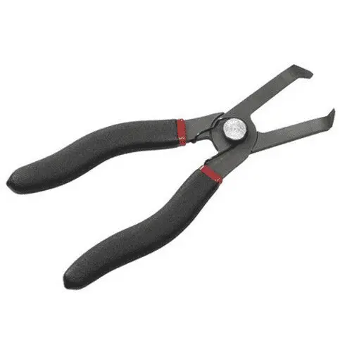

I was trying to remove these push pins too and it seems I will break them. Do you use a special took to remove them?
Yeah, push pin pliers. Takes them out easy.

small blade screwdriver to pop the center pin and a pair of pliers to pull them out. And as determined as I was not to, I lost one, don't know where the hell it got to. Must be in the same place where all the lost socks go.....

Like madar, I use a small flat-head screwdriver stick into one of the cut-offs around the center pin and lift the center pin (serve as a lock) out fully, then the whole push pin can be pulled out easily.
It sounded easy enough.

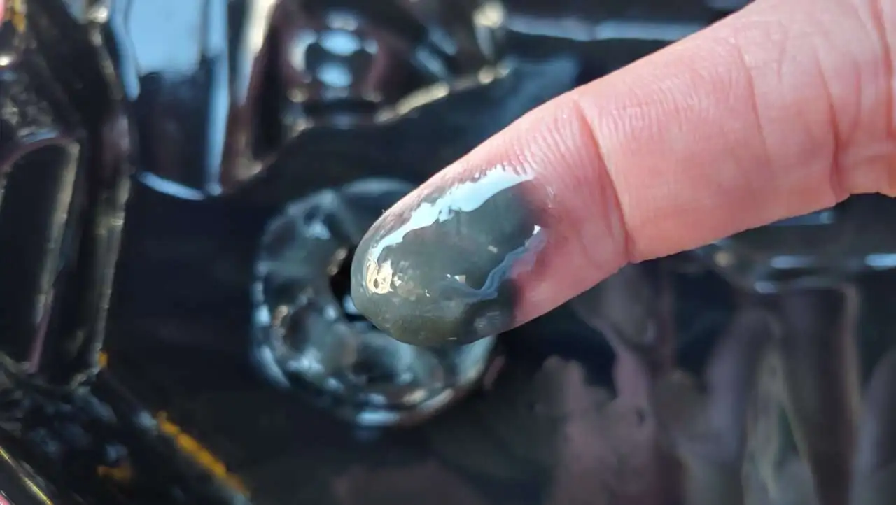

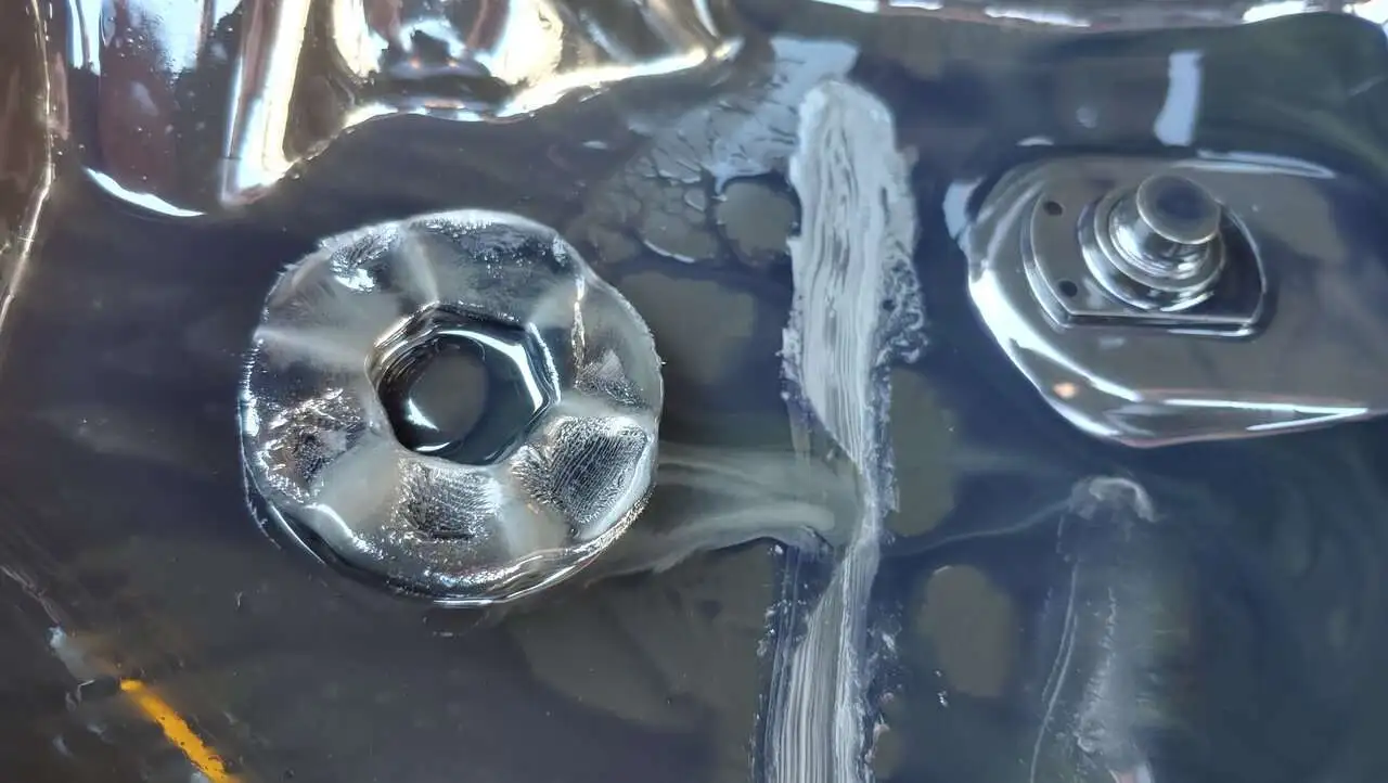

It was easy, tough part was pulling the dipstick out, was in there for 7 years and was difficult. O-ring fits down in the oil hole and was difficult pulling out, had to gently twist and pull the dipstick, think I might have torn the o-ring a bit but it's not leaking. I bought a BAFX OBD reader for Android ($21) years ago and use Forscan with it, $7 for the license. This was the first time trans fluid was changed in 75k miles. I highly recommend a shorter interval. Fluid wasn't in bad shape, must be good stuff, no residue on the drain plug at all.

⋯ Fluid wasn't in bad shape, must be good stuff, no residue on the drain plug at all.
The drain plug doesn’t have any magnet hence you won’t see any metal residue on it. If you ever decide to drop the pan, you’ll see all the metal shavings there, on the magnetic disk attached to the inside of the pan. See these photos from post #238 by rj_make:
Ok, wasn't sure. I plan to do another fluid swap later in this year then next year will be the trans filter. The rear diff plug was clean also.

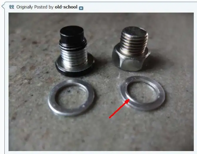

The drain plugs on oil pan and ATF pan have the same part number. This’s from older Allen / hex socket oil drain plug. The black tip is only the paint, not the magnet.
Here's the OEM CX-5 Allen plug on the left with an unused washer in front and the replacement 19mm hex plug on the right and it's used washer. ⋯
Lastly, NO the OEM is NOT magnetic.
