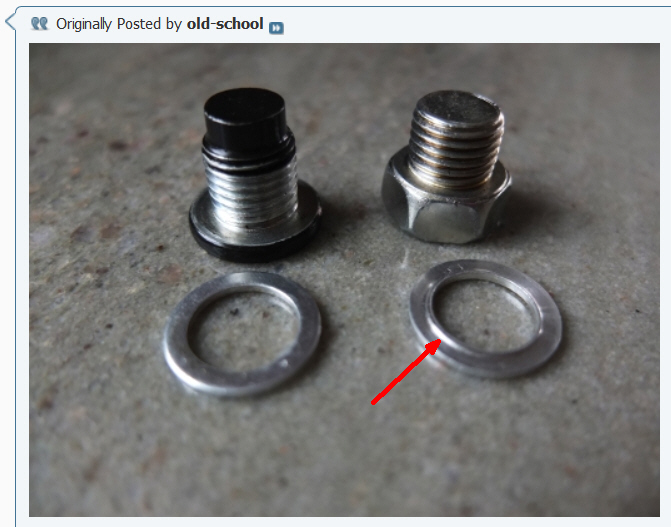

Here's the OEM CX-5 Allen plug on the left with an unused washer in front and the replacement 19mm hex plug on the right and it's used washer.
You can see a flat on the 19mm hex to evenly crush the AL washer when brought up to torque spec and evidence of deformation in the washer to seat against the pan. Since the hex is big, 19mm, the flange shown in a previous hex drain plug is materially present, but in effect buried in the large hex head of this plug vs a 13mm for instance.
The flange on the OEM Allen plug is slightly larger, maybe 2mm in diameter, but I didn't mic it nor the flat on the 19mm Hex plug to compare, just a guess.
Lastly, NO the OEM is NOT magnetic.

Yeah, OEM drain plug has no magnetic at the tip. I confirmed that when I had an oil change several days ago. It's black paint.
However after seeing your comparison picture which makes me believe we should keep the OEM Allen drain plug. OEM Allen drain has larger flange to make sure evenly deforming the aluminum washer with specified torque. 19mm hex drain plug actually applies more force to the aluminum washer with smaller flange area contacting the washer using the same torque, hence the inner blurred edge of your aluminum washer. My used washer doesn't show any sign of that. OEM Allen plug also has non-threaded extension (painted in black) helping us to guide the plug into the drain hole and prevent possible thread stripping during initial turn. OEM plug also has longer length of thread area which may be necessary to match the thread length of the drain hole.

I agree with yrwei52, my OEM aluminum washer doesn't look like that either (red arrow indicates uneven load spread from the smaller flange hex bolt), I'll stick with the larger flange allen bolt that came with the car

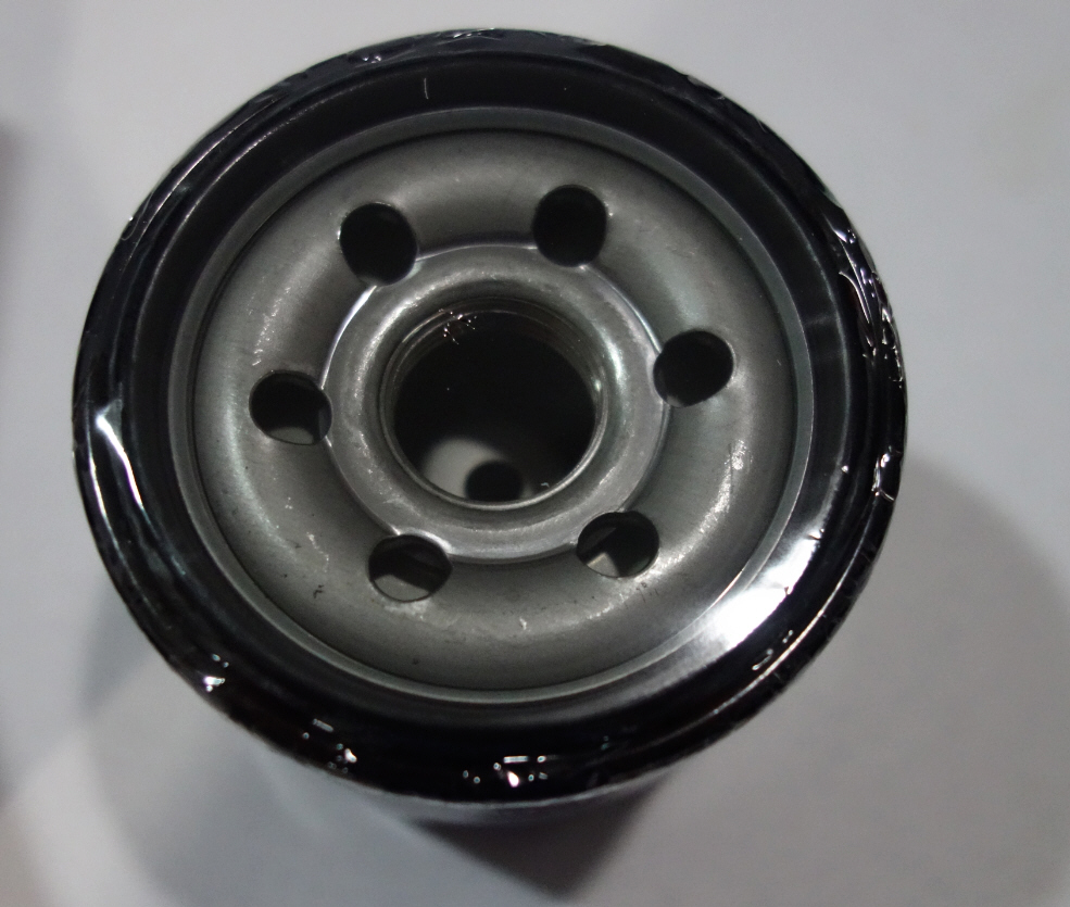

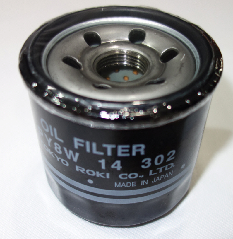

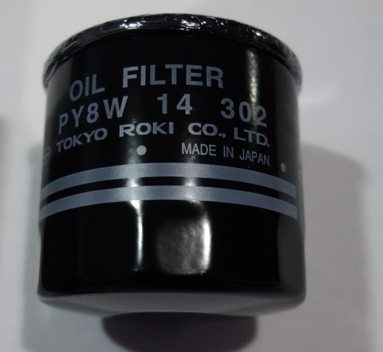

Packaging pictures below, oil filter look to be high quality made and sealed, is this oil filter correct ?
UPDATE, just heard back from Med Mazda, seems they sent out the wrong part by accident,
New message from: mazdapartsmedcenter Top Rated Seller(4,546Red Star)
No you should have received part number 1WPE-14-302. We will ship you the correct oil filter out today. Sorry for the trouble.
Thank you,
seems p/n PY8W-14-302 is for the new CX-9
Thank you,
Yeah, PY8W-14-302 is for SA-G 2.5L Turbo. It's wrong oil filter for our SA-G 2.5L although it should fit. And thanks for the photo pointing out the area I was referring to on aluminum washer! :)
