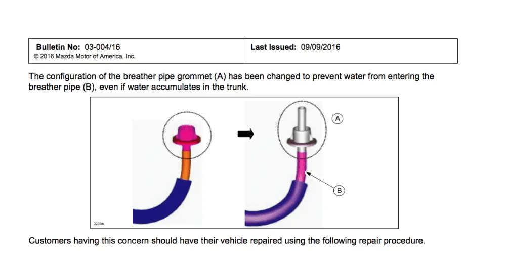

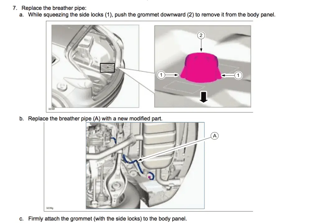

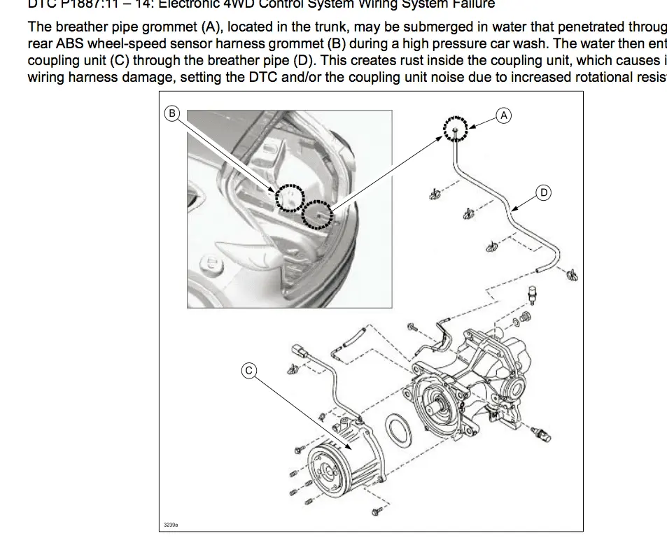

What MY of the rear differential did you get for your 2017 CX-5? Have you checked if both sides of inner CV joint are fine on the drive shaft? Mazda has revised the rear differential input shaft casing a couple of times in the attempt of preventing the premature wear-out on the input shaft bearing based on several TSBs (see dukiebabe‘s post). On the other hand, if the differential is newer than your 2017 MY, you may have trouble doing the programming.
In addition, you may want to replace the vent on top of the rear differential with a revised version while you’re there. Check the condition of the vent, and you may already have the revised version.
I've ordered the replacement diff breather/vent hose mentioned in TSB to address that potential problem

Seal replacement is a good advice to prevent leak. You needs more than 1 quart of expensive Mazda Long Life Hypoid gear oil SG1 to replace both gear oils at the front transfer case (better do it at your mileage, 60K+ miles) and the rear differential. The spec of 0.38 quart on rear differential is way off, more like 0.75 quart.

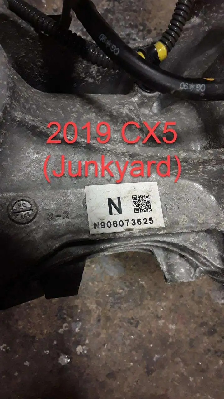

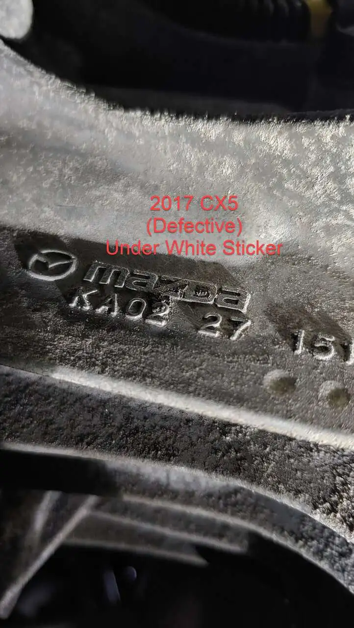

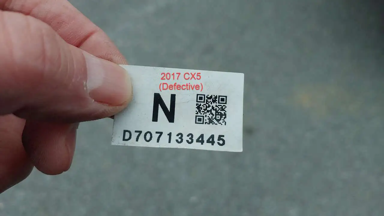

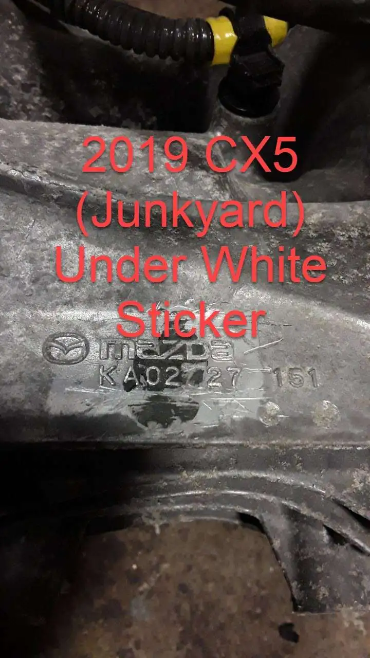

So I called the yard, and the donor was a 2019 CX5? I'm I good?
Chris_Top_Her said the TCM needs to know the rear diff’s ID. But he didn’t answer how he did it. You can check with Mazda parts and see if the part numbers are the same between 2017’s and 2019’s. Also you can check with the service or any other places and see if they can do the TCM reprogramming with a new differential.
Ok so I got, what I presume is, the part number (on the Diff cast) and the programing string. I'm thinking I should be OK.
I'll know in a few week I guess. :cool:

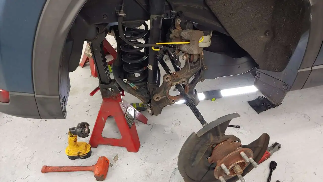

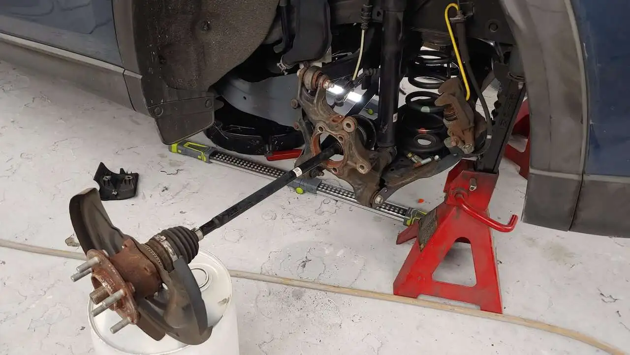

Junkyard replacement complete, just need to have the car calibrated to different diff. I did notice a very small amount of play in the junkyard diff @ CV axle connections. Hopefully normal.
We started ~4.30p and finished up at ~9.45p. That included a dinner break (~30 min), pulling and installing new outboard diff seals in used diff (super easy), installing new rear CV axle clips (out of spec) and draining and refilling front (and rear junkyard) diff. and Of course clean up.
We orginaly pulled the axle nuts, but as you can see in the pictures (sorry I was rolling with the work so I only took 2) that is COMPLETELY unnecessary, especially if you have a 2nd person.
Praise God it went very well. If you're interested in doing this yourself, I can list all the supplies and tools I used to make this go smooth. It also helps alot having a 2nd person. You can defininly do this by yourself, but it would have taken twice as long IMO.
Front diff oil looked good, but didn't seem like much came out. (didn't measure unfortunately)
If anyone is interested in what the inside of the blown diff looks like inside, comment and I'll open it up when it's warmer and post some pictures.
