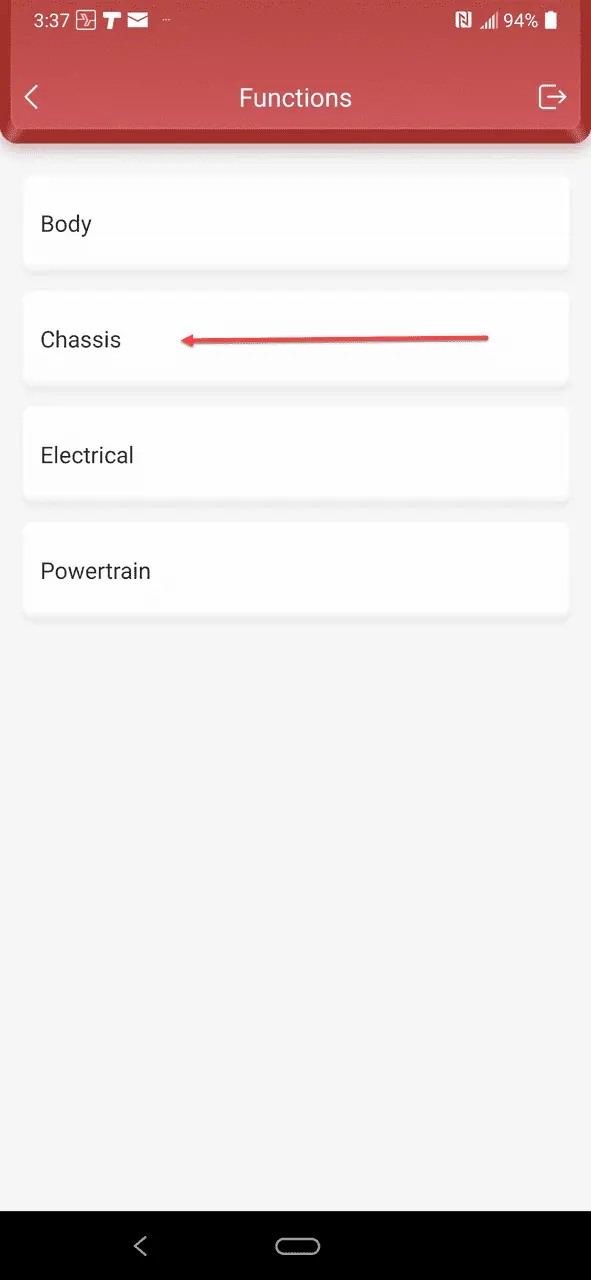

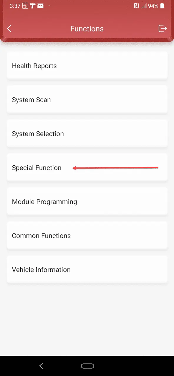

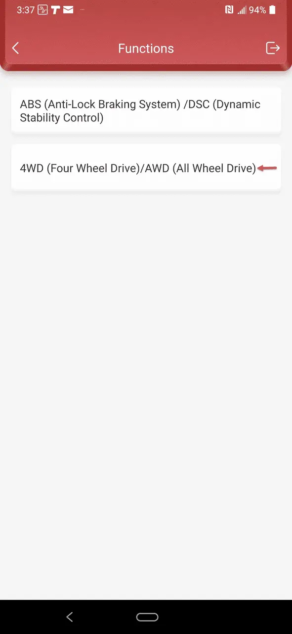

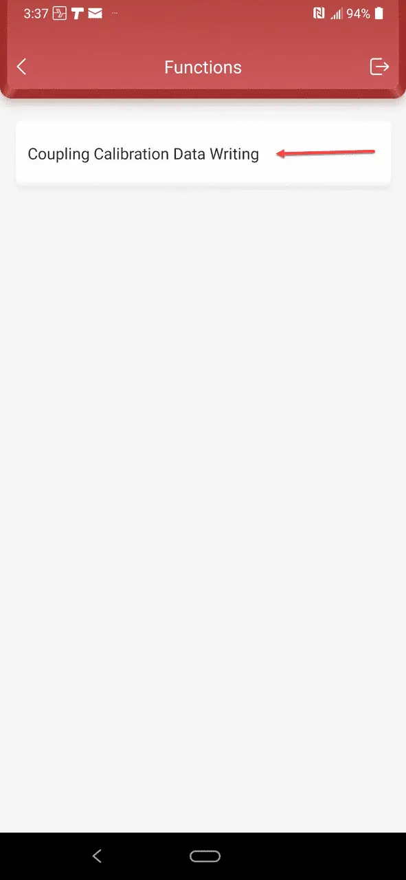

Just an FYI.. https://www.amazon.com (commissions earned) (which is stupid powerful for it's price) was able to write the calibration data (it's the 16 digit code highlighted below and found under the input drive shaft on the coupler) to the car.
Note: The service manual also states it can be found on the side of the coupler, this was NOT the case in either my original or the junkyard diff. So make certain you record that number before re-installing the drive shaft.

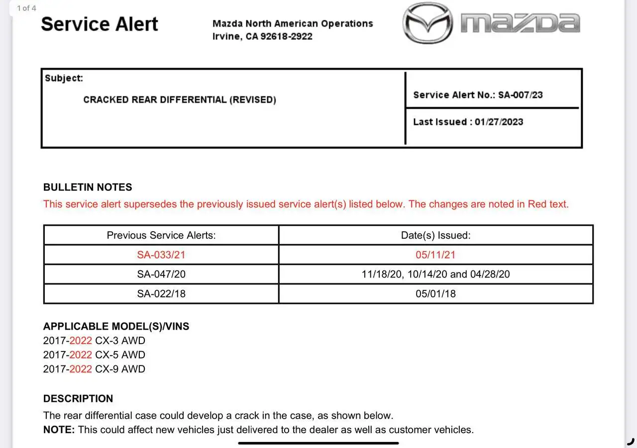

A lot of potential for cracked ones considering TSB ranges ‘17-‘21
https://mazdas247.com/forum/t/►►►-nhtsa-mazda-cx-5-tsb-listings-brochures-manuals-◄◄◄.123875915/#post-6744952

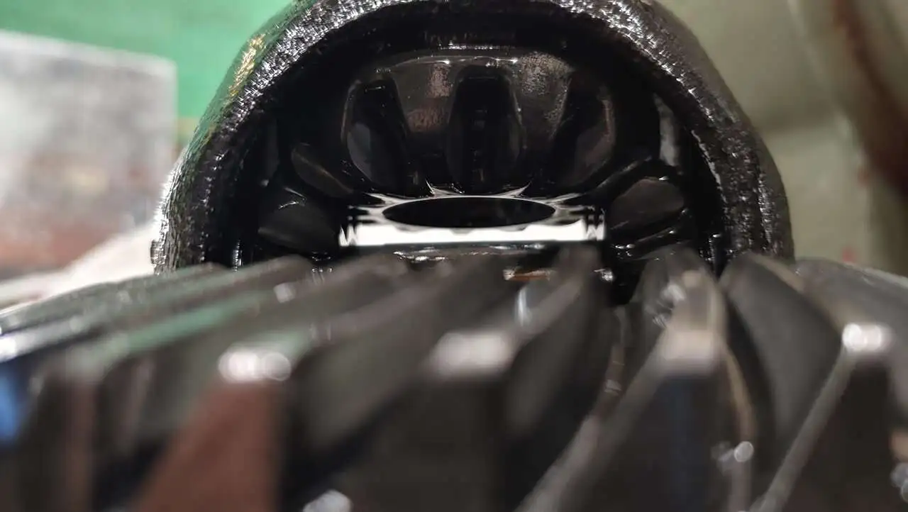

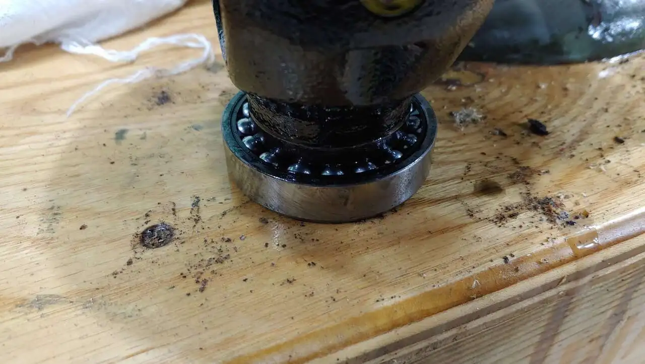

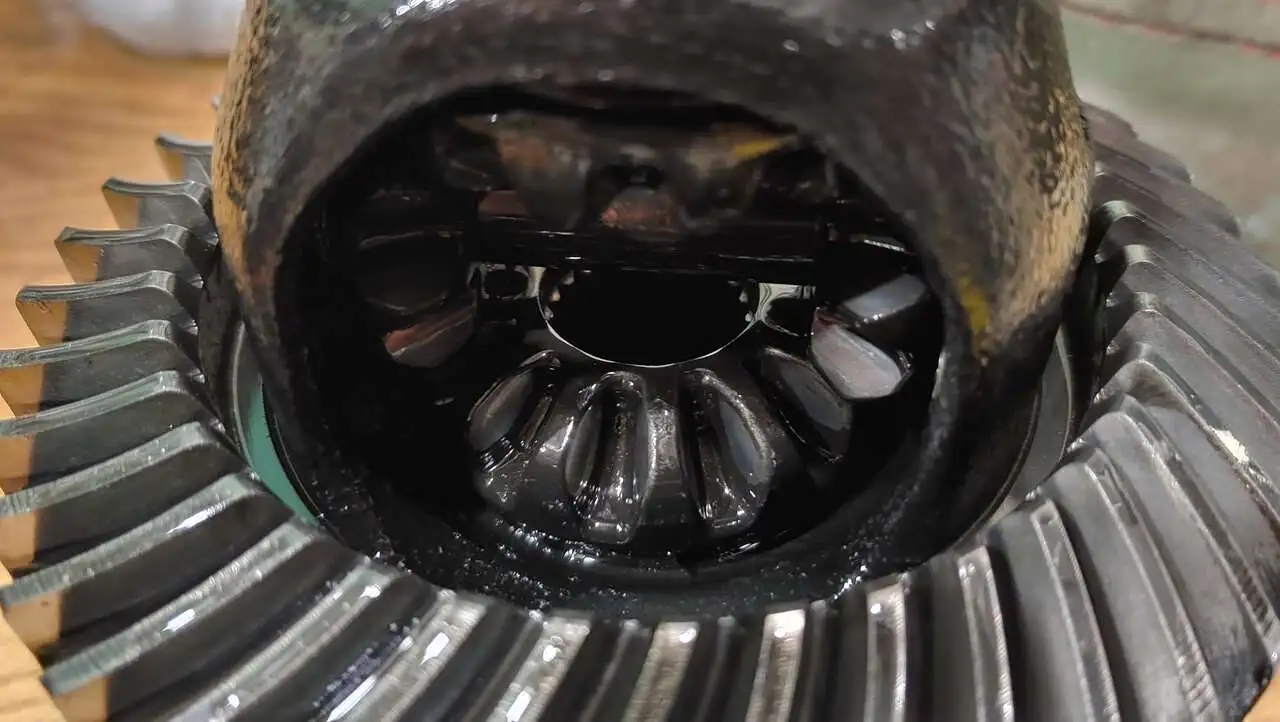

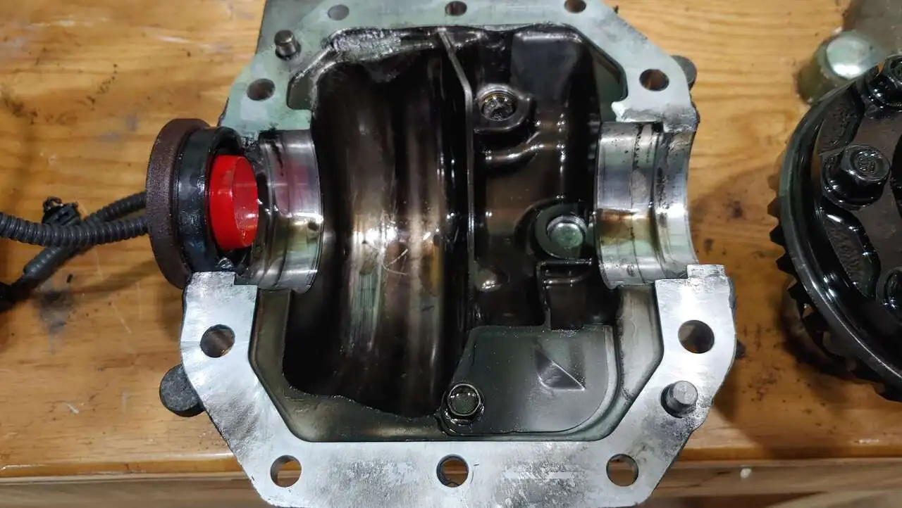

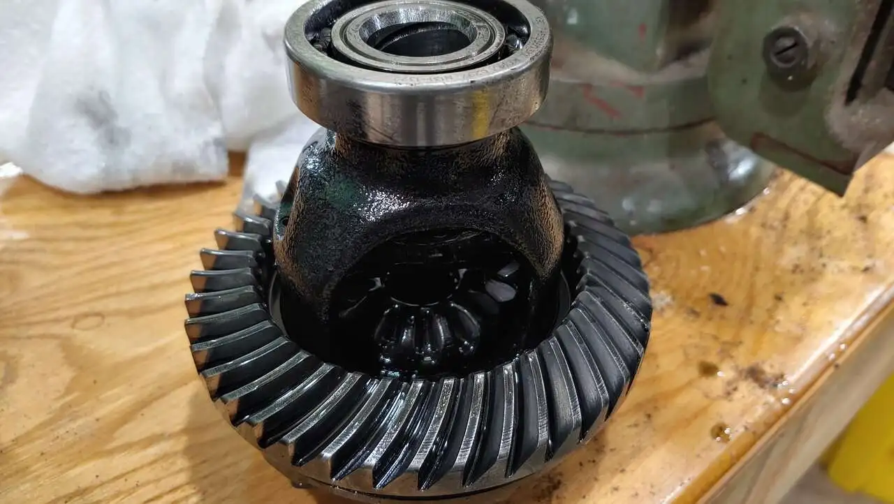

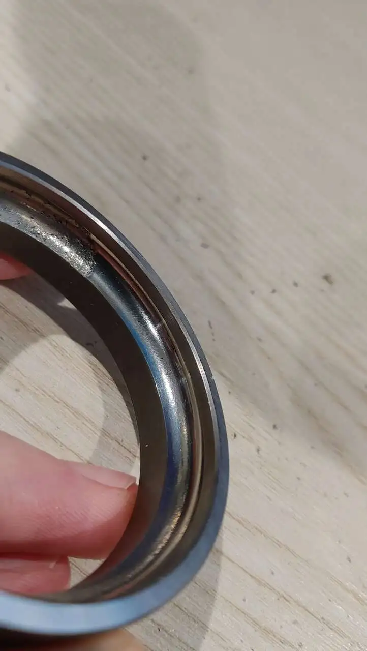

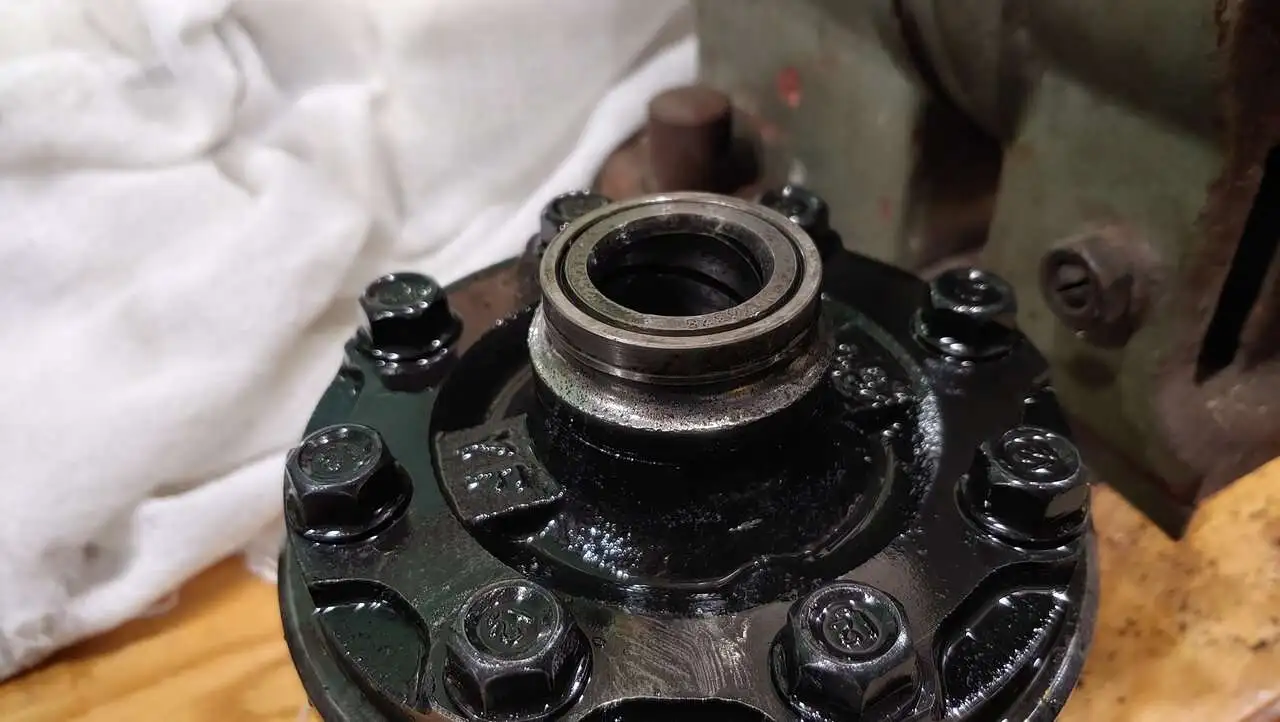

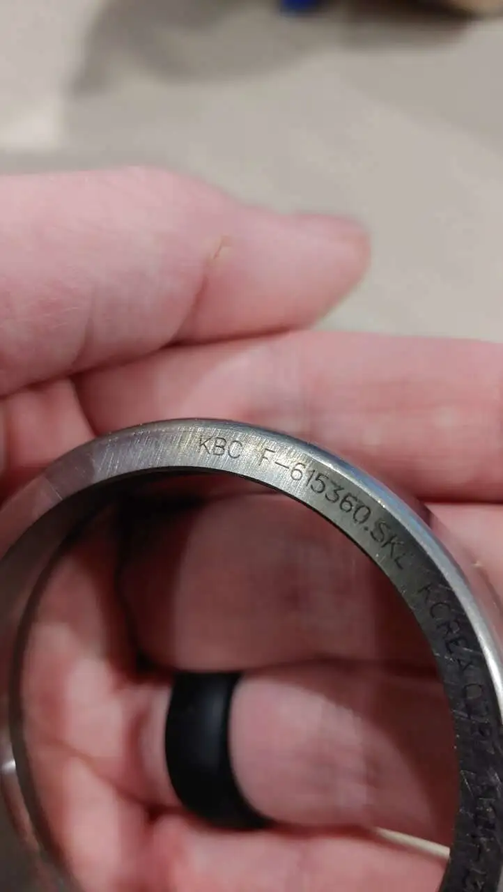

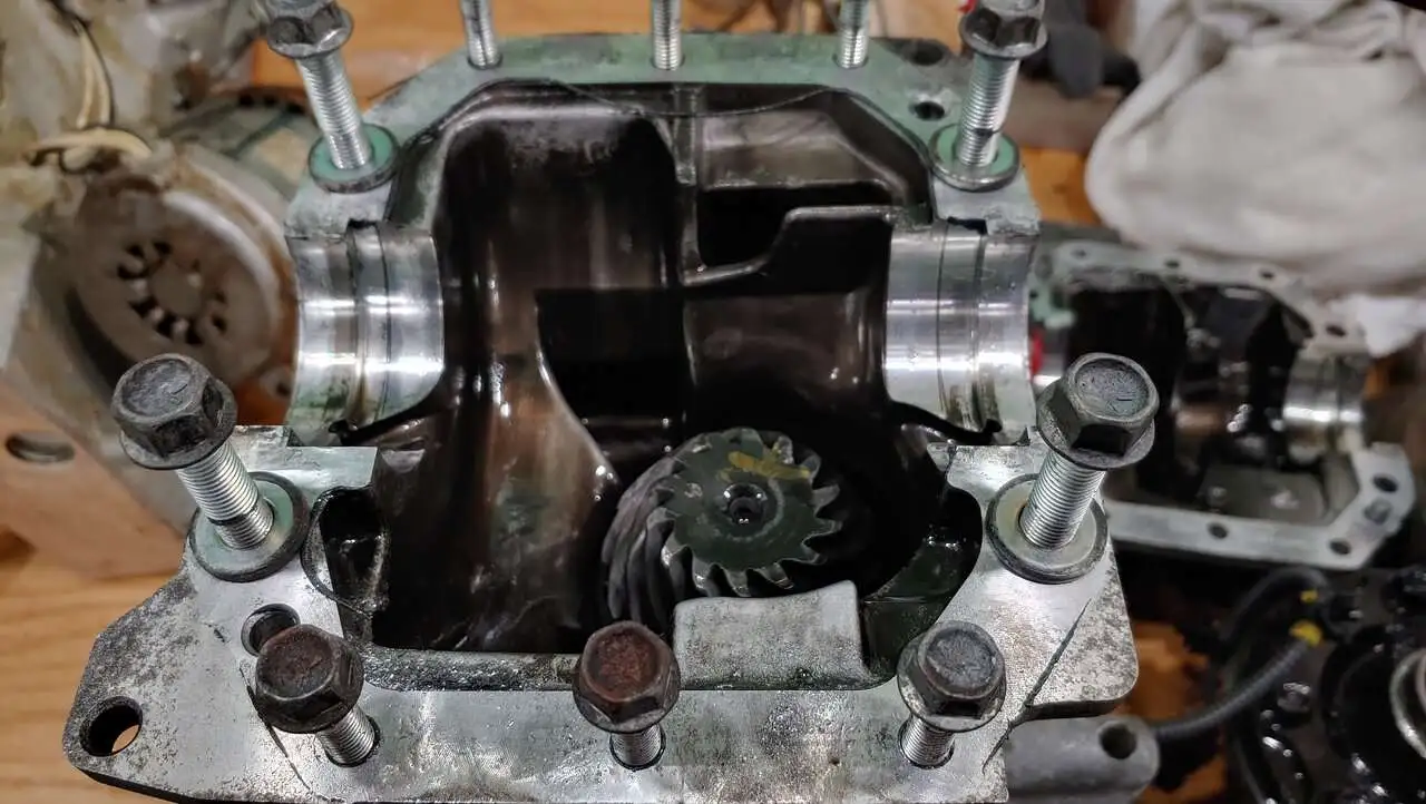

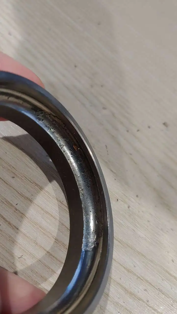

Still not sure what the cause of left side output bearing failure was, but here are some break down pics of the blown diff (Still need to remove the coupler from the diff to check those bearings).
Notice: very little sealant...
