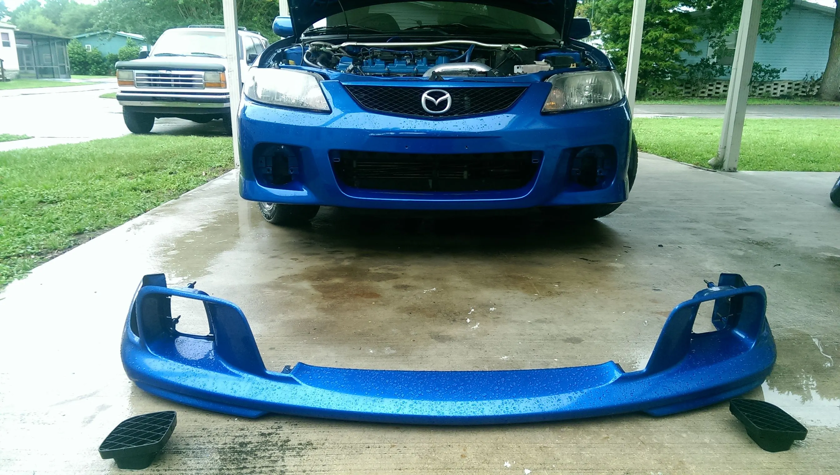

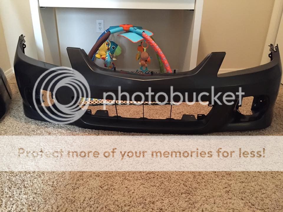

That's a Protege5 front bumper. The MP3 and MSP bumper does not have the holes in the sides for the marker lights, the lights are inside the headlight instead. When I worked at Mazda back in 2012 I had the parts manager (3rd largest Mazda dealer in the country, mind you) look up parts for my MSP, wheel center caps, steering wheel, floormats, shift knob and seat covers were specifically what I looked for and at the time the only thing available was a set of front seat covers and I believe there were 1-2 front lips. Everything else was already obsolete, 3 years later and with all the new models Mazda has introduced since then, I guarantee they are clearing their stock of protege parts.
So what I am taking from this, is that you COULD use this bumper, it just would need those holes filled... basically.
So this would solve the broken headlight area tab.. and now I just need to either replace, or fix the insert... no?
I don't think the lip will fit that bumper. I'll get a pic of my bumper with the lip off later today. I need to redo the adhesive.
There are p5's out there with the msp lip fitted so yes you can just have the marker holes filled, that is the only difference.
JDM is correct. uploadfromtaptalk1435605517237.webpuploadfromtaptalk1435605528805.webp
Looking behind the lip you can see that there is plenty of space.

Anyways, as everyone here is already aware.. this is what we are dealing with, 03.5 insert-wise on #1289
So as hornsfan pointed out.. finding these is basically impossible. I toyed with the idea of building that area back with fiberglass... but since I was an idiot (I should have just cut it all as one piece (if you are gonna cut) Instead all my pieces were no bigger than 1" x 3" and they all ended up in the trash... So I was completely F'ed unless I wanted to fabricate from scratch the missing pieces
SO I found this. (here's where we are all probably gonna differ in opinion)
Its broken on the drivers side
We are talking $60 to my door on this...... o.O Which I think is pretty fricken good regardless of the condition.. no?
SO I suppose the question is.. what would YOU do?
1) You could cut the end off the one on the car and fiberglass it to this one (hornesfans gonna say no.. lol) (THIS IS PROBABLY THE EASIEST) Requires joining and flushing 1 "side"
2) You could cut OUT the sections I've ****** up, and bring THEM to the current bumper. (THIS IS PROBABLY THE BETT(ER) OPTION. Will require "flushing 4 "sides" though, of the inside of that "square" (X2) WAAAAY more sanding.
3) Pull my current bumper off, use it to make a (partial) mold of the main front and side section, ignoring the vent areas and the passengers side completely... place broken bumper "in" semi mold.. fiberglass the broken drivers side (GETTING AWAY FROM COST EFFECTIVENESS.. BUT THIS IS THE BEST OPTION SO FAR.. preserves both bumpers)
4) Make a mold of a whole other (good) bumper and get into the business of making these. (NOT REALLY A REAL OPTION AT THE MOMENT) (don't have a "full" bumper yet.. lol)
Do you make a mold and rebuild this one? Or do you go easy and cut the side off the one on the car and just add it to this?

I bought it.
I'm leaning towards the cutting / swapping the vents route (since that is where the damage is anyway) also because its less noticeable in there, and there is clear room to lay some fiberglass, without worrying about the bumper flexing and distorting the finished product..

There's "protege parts for sale" and also "arecibo auto beauty group" on facebook,the latter has a member that does a replica msp lip in flexiglass but I think it suits fogs and not the deletes.
For the repair on your lip there are proper 2 part adhesives for these bumpers and lips, any panel shop will be able to steer you in the right direction, personally it seems that repairing the deletes sections with cuts from the broken lip would be the best bet with what you have.
Miatas aren't gay, some of the owners are but that's true for every car. They are by far the most reliable car Mazda has ever built (one of the most reliable cars of all time) and I wish I had one to slide around sometimes, just can't fit in them very well.
Anyway I say just repair the cut parts of your stock lip and keep it. Or cut out the lip more and install P5 fog lights.
Or even trim the top of the lip off and keep the bottom parts if you can make that work.
Like this:
http://www.mazdas247.com/forum/show...uild-Round-3&p=6307183&viewfull=1#post6307183
OR you could buy the lip in the FS section right now for $250 plus shipping, paint and install it. Then repair both your busted lips and sell them for profit. That's what I would do.
The one in the FS section is not for me. He starts off saying $300 obo.. then its $400 shipped. Then its $475 shipped. And its not even painted. I'm guessing you think he'd take $250..
I did already buy that broken bumper. I think the smartest and BEST way to fix it is to just work on the area's I messed up to begin with.. SO basically what you said / my option #2.

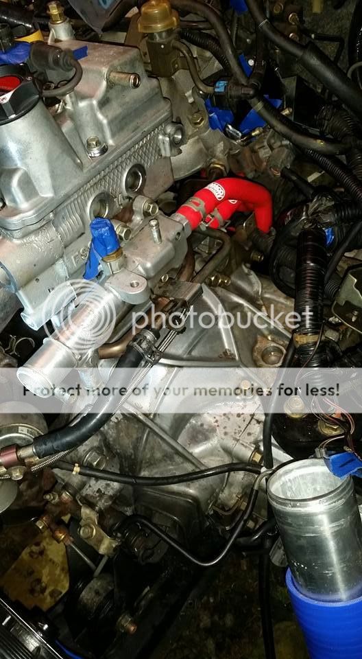

Bought this
Failed at motor mount.. all samco hoses fit though.. so thats a bonus.

I fricken STOLE that bumper. Time-wise and finacially.. The "ad" was up for 9 minutes. Paid $150. shipped.
SCORE.
