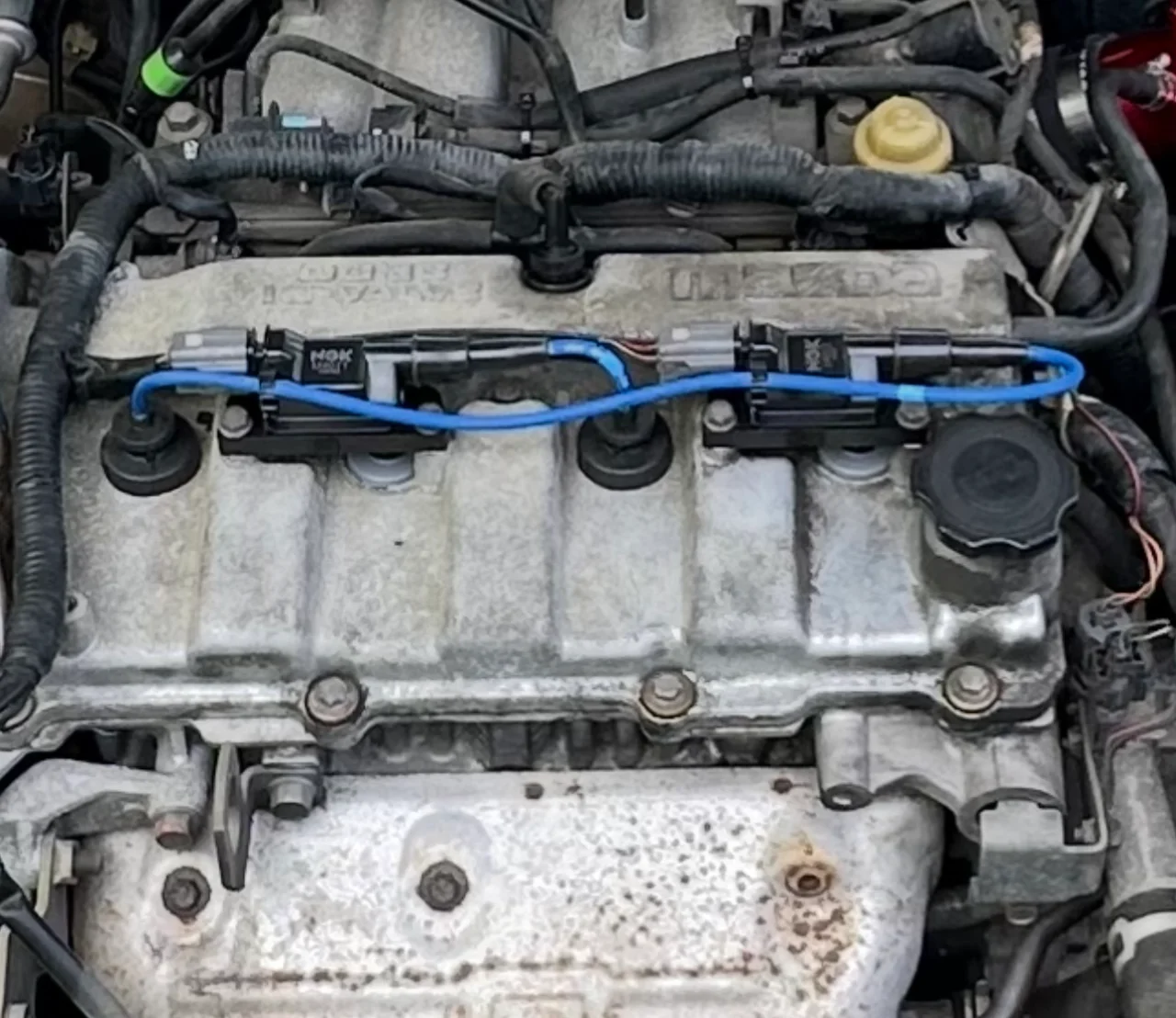

@misnblu I wanted to go do the coil on plug conversion as in the attached. Also, I read that the 626 calipers bolt on the front, but allow for the larger 626 rotors. But these calipers seem like they might be the same. However, when I search for 626 calipers online, I am never asked to specify V6 model. I am pulling a front wheel tomorrow to compare them to what is on the car.

You wanting to rid yourself of coil on plug to external coils with actual wires or the opposite?
Calipers may be the same but banjo bolt may be in another location so look for that.
I know the Kia Rio and Accwnt are basically the same but brake calipers fit with the only differences being the location for the banjo bolts on the caliper.

I see what you're doing and hate to infiltrate this thread with my ignorance of what you have but since you do have the 2 liter motor you must then have this same setup below from OEM factory for your car, yes?
If this is the case then you're using actual coil over plug system for one coil per actual plug.
I see the connectors for the plugs in your picture.
Are you planning on changing the ignition wiring harness to accommodate the would be coil over plug setup?
I've seen posts on other Mazda forums where they've taken coil setups from earlies generation Protege models and run spark plug wires from externally mounted coils.
This has my curiosity up as I had a Chevy Z24 with an OEM coil over that was prone to heat soaking the coils causing weak spark and firing issues.
I made my own external coil pack setup with spark plug wires to the plugs giving increased spark, larger plug gap, and dyno proven more power.
This became all the rage on the j-body.org forums in short time so now you know why I'm asking about your setup.
Thanks 👍
Interesting coil setup... Looks like instead of running 2 coils, you'll be running 4. That kit is only for the conversion harness, which really only looks like some connectors and split-wires. Not sure how much you actually gain from that conversion...

This is what I found on COP setups: "Coil-on-plug (COP) ignition systems provide superior engine performance and efficiency by placing an individual ignition coil directly on top of each spark plug. Key advantages include a stronger, more consistent spark, increased fuel economy, reduced maintenance by eliminating spark plug wires, and improved timing accuracy for better combustion".
I figured one coil per plug should be better than the coil per 2 plugs setup we have stock. I have the valve cover. I would need to get the harness and the the Toyota coils. But you are right. Will it be worth it in the long run for the cost? We will see if I go all the way through with it. The 626 valve cover was just a convenient opportunity when I bought the calipers I won't actually be able to use now.
For the coils you'd have to do some research on each setup.
What's the windings and ratings on the coils along with resistance.
They must be close enough to fire similarly but from my personal experience with my DIS coil conversion I did on my Z24 the spark was much stronger than the original coil on plug setup.
I went from a .028 plug gap for the coil over plug to a .060 with the DIS setup with more power to the wheels.

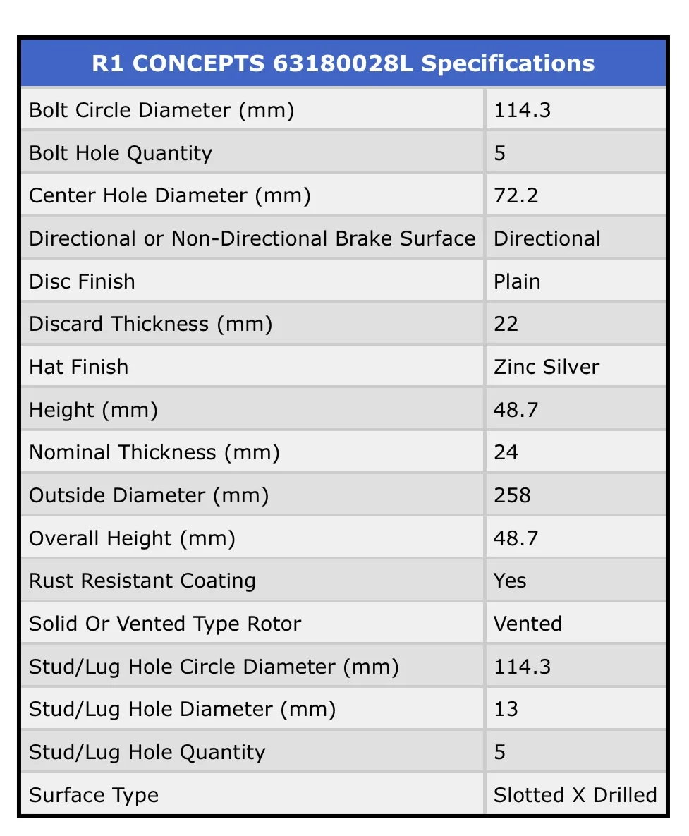

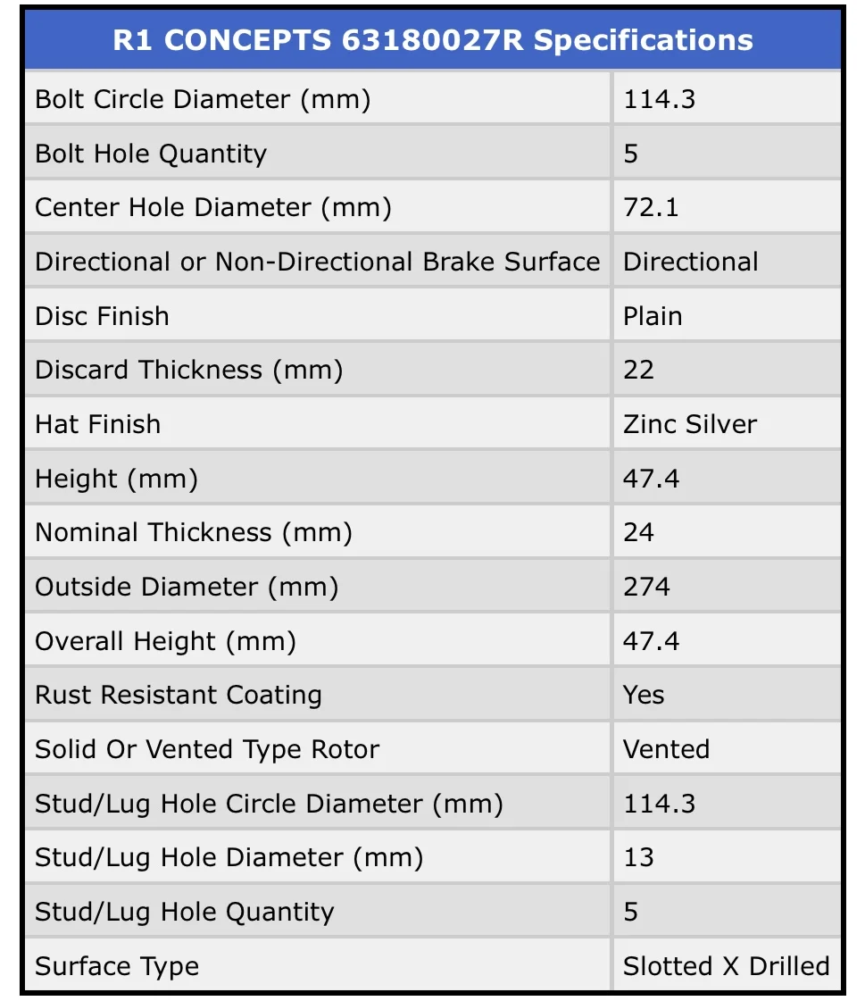

On the rotors here's the specs I found through RockAuto.
Below is the OEM rotor at 47.4 mm.
Here is the rotor for the 626 V6 at 48.7 mm.
I use RockAuto as a database I can compare between models for engine, suspension, or anything that's interchangeable for my Accent and the Kia Rio is a perfect example of how well it works.
Cross referencing like this saves time and RA has the data which has t steered me wrong yet. 👍

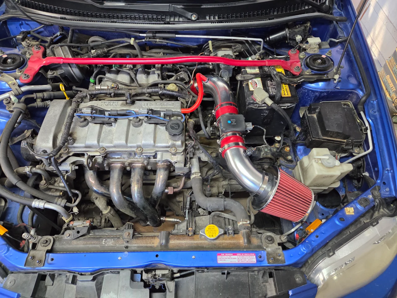

I wish I remembered. I had a bad experience contacting a recommended seller on here and lost my money the first time I tried to buy headers. After getting through that fiasco, I actually found some online and they were delivered in a week or so. But I cannot figure out where I ordered them from. Not Ebay, not Amazon, but other off brand auto parts site. They are ok; had a little difficulty getting the EGR attached as well as there was some welding flash in the upstream O2 sensor hole that proved a little difficult as well. Also, it's really tight to the bottom of the oil pan, enough so that the intermediate pipe flange was tapping on it occasionally. When I took that off recently to gut the second cat, I ground down that flange enough for clearance and now no more tap. Definitely mock things up and test fit before fully installing anything like this.
Looks to me like one of all the other 4-1 short tube headers that are available for the car. Back in the day, the one tog et was either the 4-2-1 AWR header, or the 4-1 long tube RActive header. There was also a long tube 4-2-1 JDM header, but that one required some re-work to the mid cat pipe to make it fit.
You could also make the 626 / MX6 / Probe 4-2-1 long tube header fit with some re-work to the EGR bung location. It might have needed some re-work to the mid cat pipe, too.
