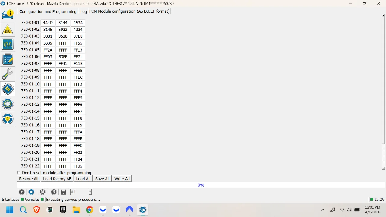

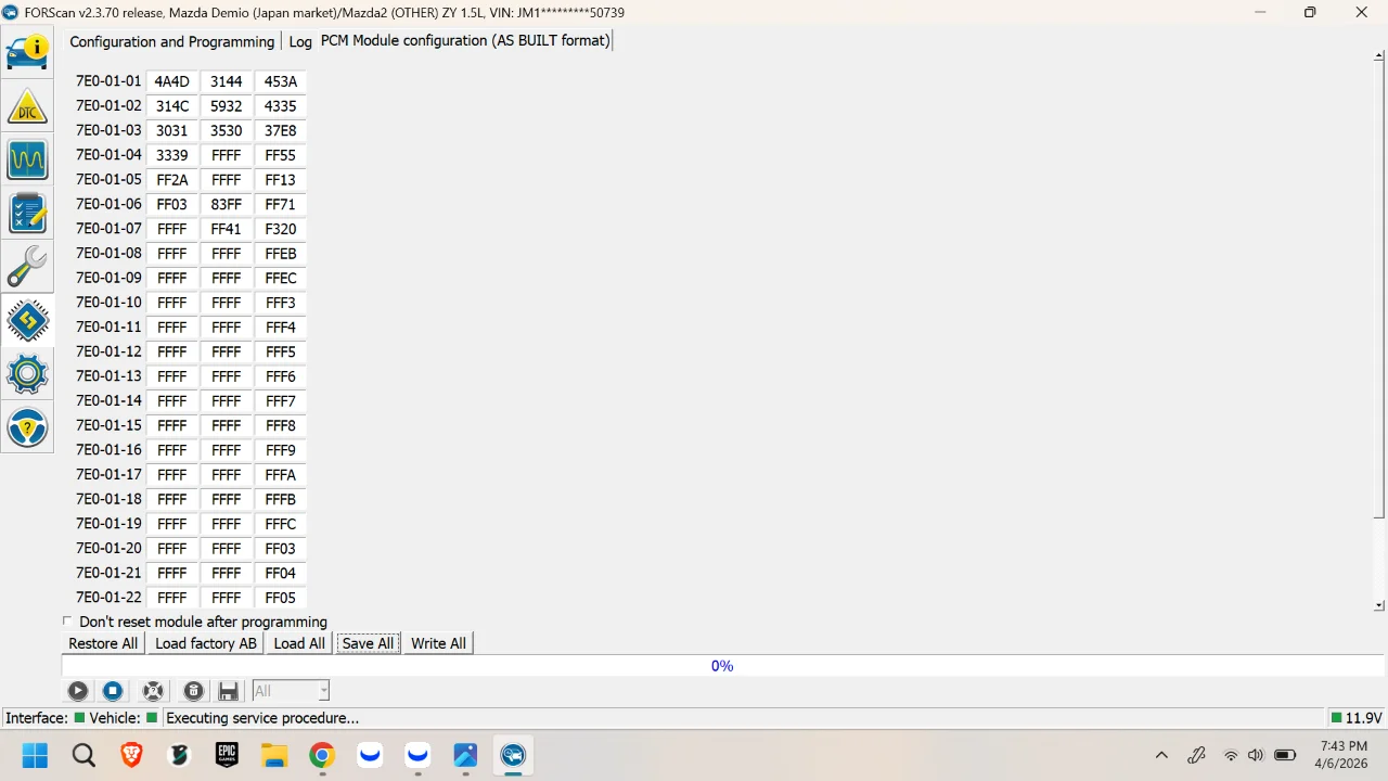

Not sure what you need to do exactly. My car was changing the line 25 as well, but I was able to get it when I changed them both simultaneously. I think I had to reset and try again around 5 times. Sadly I'm not an expert, I just got it working on my car.
What I've done so far:
-Swapped steering wheel and airbag
-Swapped clock spring (unnecessary)
-Checked wiring continuity from clock spring to the pcm connector
-Checked steering wheel cruise buttons with ohms meter
-Oscilloscope pcm test clutch and brake pedal
Everything has passed and functioning as it should. I still cannot get the cruise control to activate and when I change pcm line 7 and 25 I still get dtc code P0610.
Has anyone done this to a manual? Did these pcm values work for you? If anyone has a manual with factory cruise and can share their pcm data, that would be greatly appreciated.
