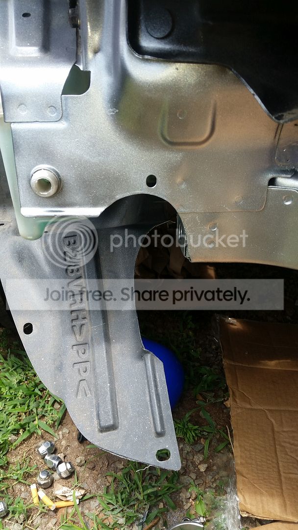

So I worked on it again today even though I don't have the radiator yet. I am taking my time and doing this pipe rerouting right. I don't want to revisit this again.
I really went out of my way to make this as clean as possible. THe I sprayed it with silver metallic so it wont rust
