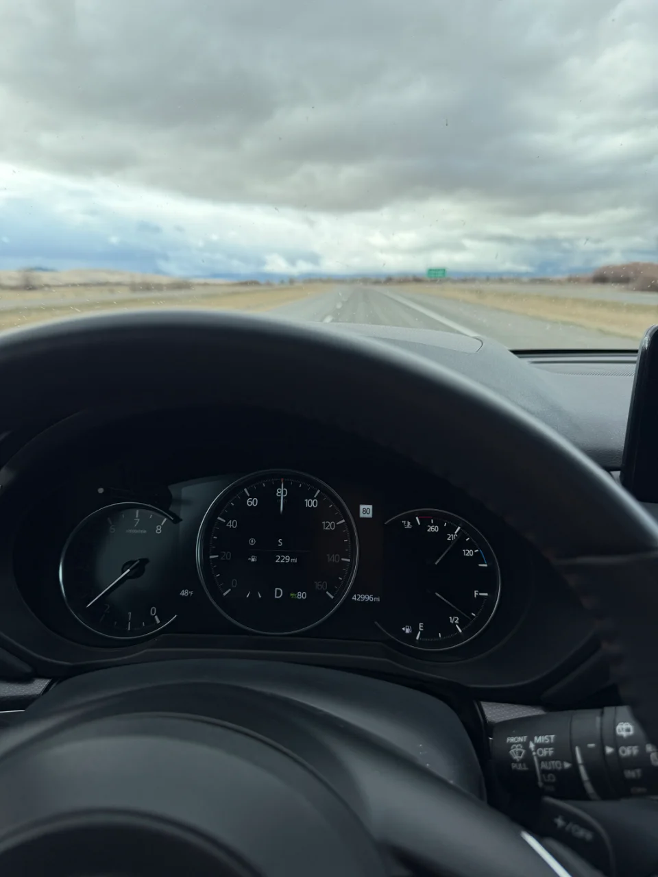

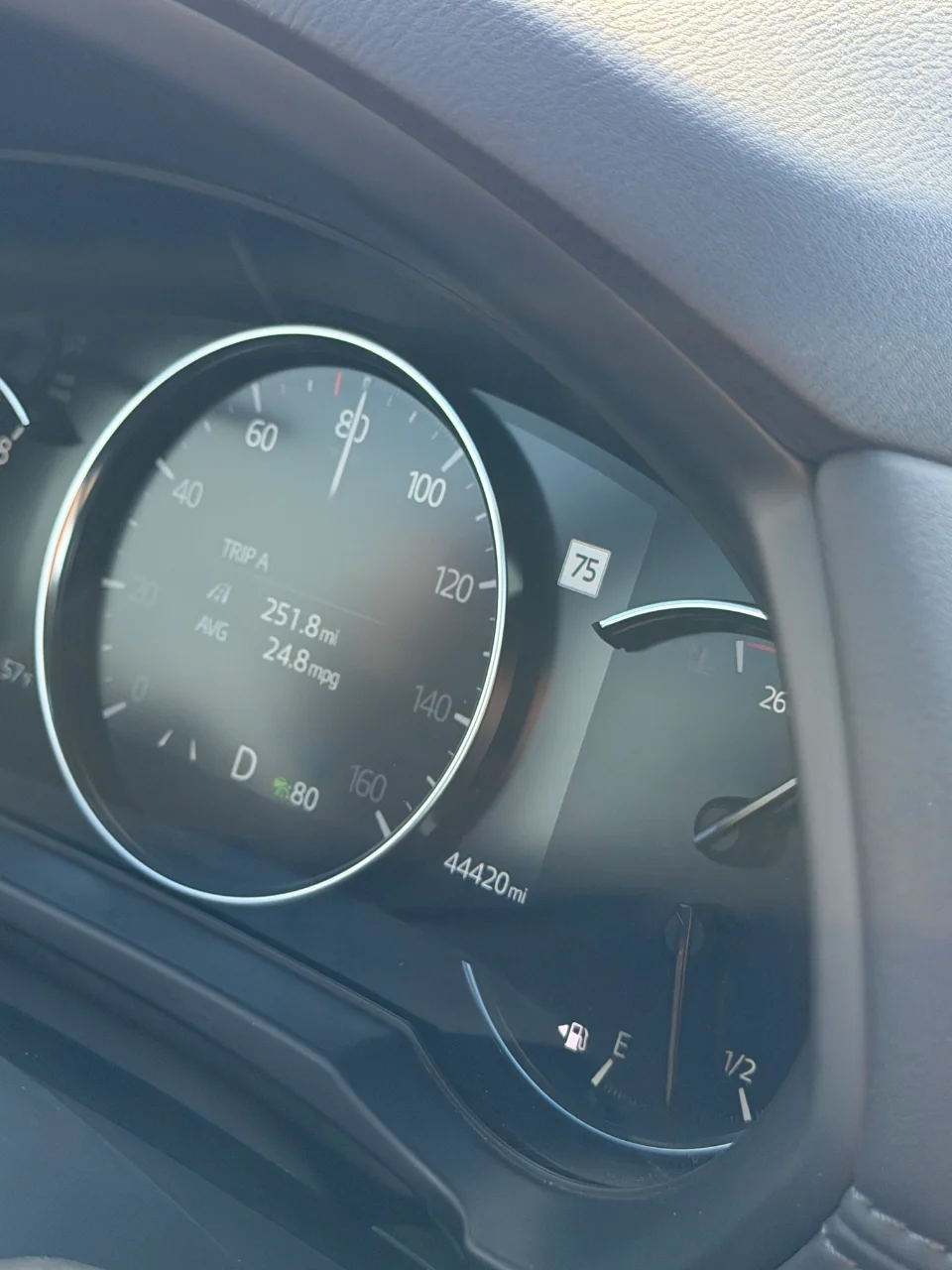

I think it's the opposite. At least for 6th, it only drops the RPM by ~350. That's the gear we need to stretch out on the interstate but it hardly makes a difference. Instead, we're turning 2500 RPM at 75 mph.
I actually think the 6speed gearing is perfect in my 23 cx5 turbo. cruising at 80mph I still have plenty of powerband to kick it up to 100mph very quickly to get around semi trailers that are cruising at 79.5mph.
Of course, power-wise, it is perfect for the turbo. You're right in the power band for passing without any downshifts necessary. But it's not ideal for economy.
mine still gets pretty good mpg. I get 30+ driving 65-70 and ~25mpg driving 80-85 with plenty of 100+ spurts.
