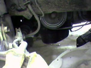

There is the heavy ass stock UDP:

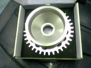

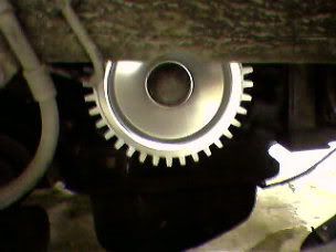

Here is the glorious new OBX UDP:

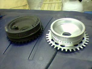

Comparison:

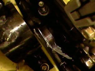

After having my dad put it in fifth gear and stomp on the brakes I was able to remove the stock and torque the new one on:

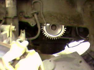

Got the belts on and we are good to go!
Comparison:
Did you have to adjust the plate on the back or not? Either way, how you like it? I love mine:)
no, the plate is just part of the pulley. Not even sure what it is for, some UDP's don't even have that plate in the back. My guess is it is in case the belt falls off or brakes it is just a guard
It's the crank sensor wheel & it has to have the gap spot in the same position as it does on the oem. They are usually held on with 3 screws to the back of the pulley. Some evidentally came with that in the wrong position & people's cars wouldn't run. Always good to pay attention to detail when doing these things & make sure all is correct or rinse lather repeat sets in.
They all have it, and its adjustable, its for timing and if the missing tooth on the back plate isn't in the right spot your car wont start. I installed it right out of the box and my timing was off, I had to adjust the back plate so my car would even run, all I was asking was if they fixed their problem or if it was probably just random, but I see yours worked right out of the box. Thx.
I just raced in a snow RallyX yesterday and ir ran great. Plus there were know screwes or anything, it is just fixed to the pulley. As you can see all you have to do is line it up with the peg on the crank and it is aligned.
There are allen screws on the back, don't make me dig up some pics... ;) Any retard can lign up a keyed hole, that has nothing to do with the question. Thanks anyways.
mine had to be adjusted before the car would even run. It seemed like such a small thing! it took a while to figure that out when PG was installing it
Mine too, I installed it and the car wouldn't start, took it off and adjusted the plate and everything was fine.
