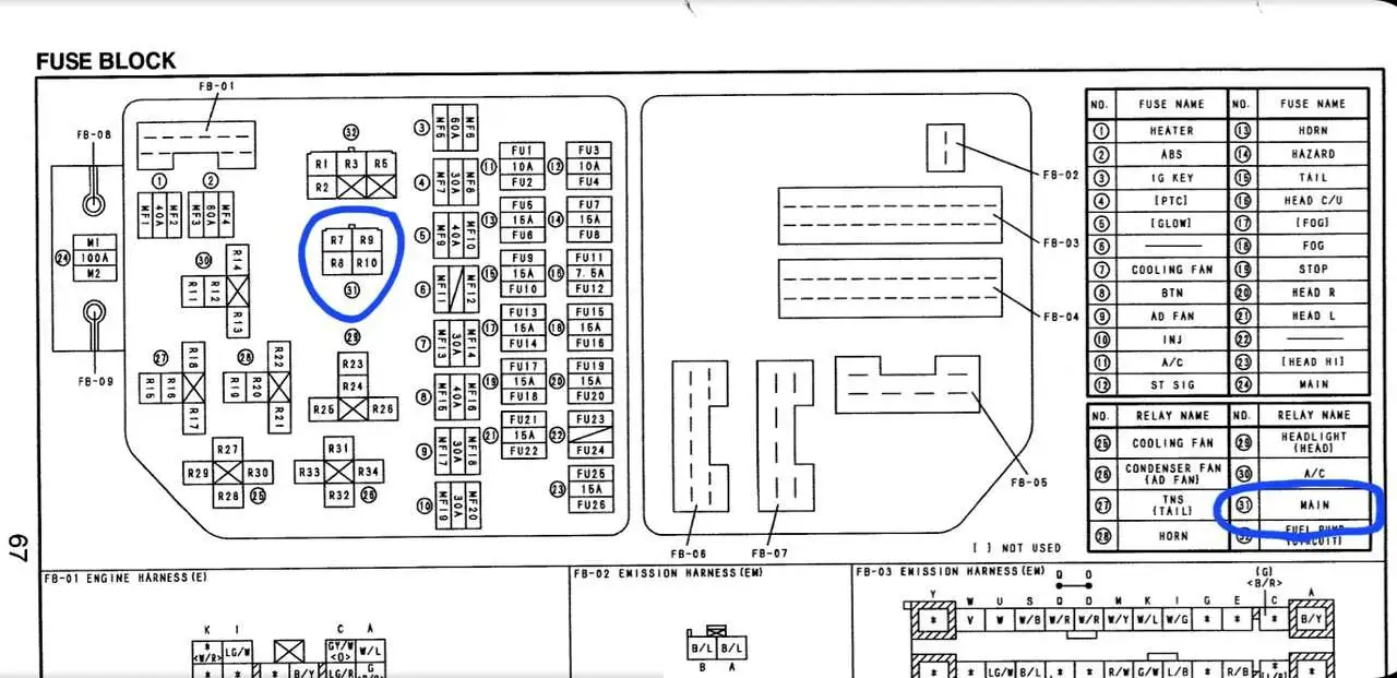

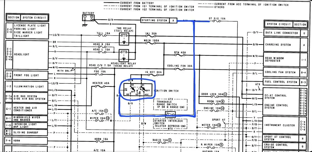

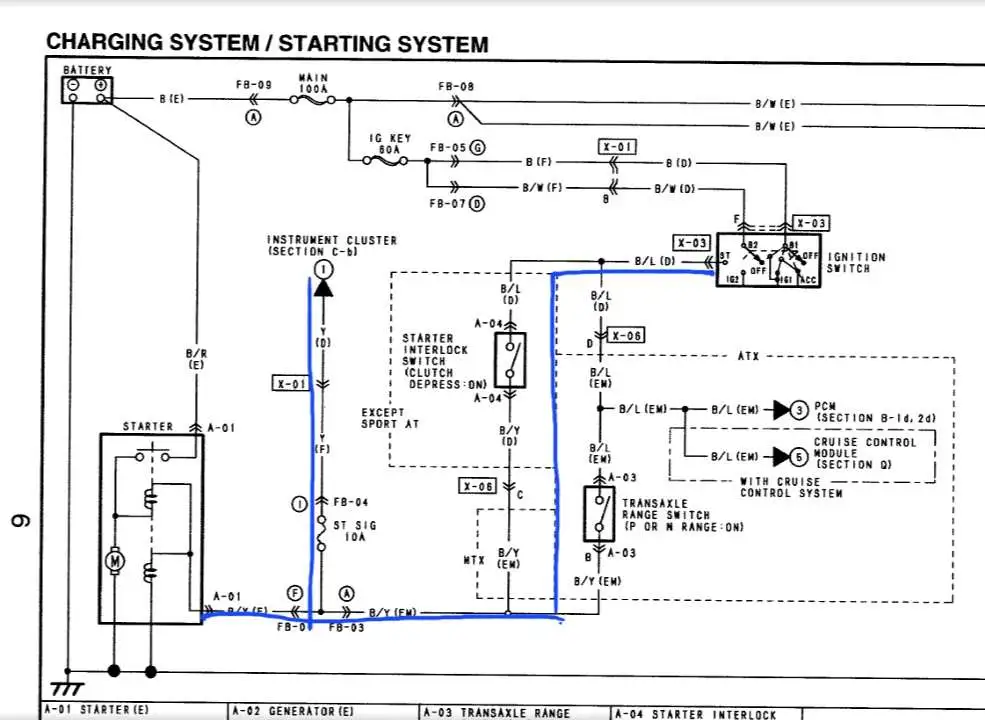

I checked out the wiring diagrams and I think that you have a sticky Main Relay.
As far as I can figure it, when your ignition switch is turned to "Start", the main relay turns off to allow all available amps to go to the starter motor.
There is still power going to the starter solenoid and to the instrument cluster from where I assume power is sent to the ignition system so that the engine will get spark.
I'm thinking that when your main relay cuts out during "Start", it isn't cutting back in to allow the engine to run when the key springs back to "on".

Relays can be difficult to test because they may only misbehave under certain conditions.
I had my fuel pressure regulator solenoid valve pop a code so I put 12V to it and it clicked.
I did it three more times and it kept clicking.
Then I touched the 12V to it really fast and after a dozen or so clicks, it stopped clicking.
The same thing can happen with the fuel pump relay. It may only fail during a full heat soak.
Maybe just smack that relay if it happens again to try and release it, or just replace it.
You could keep the new one in your car and quickly swap it out with your original if your car goes dead again.
That way you'll know that it was the Main Relay causing problems.

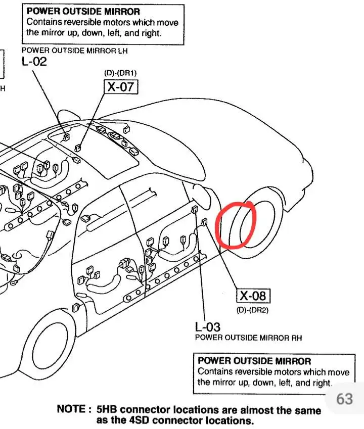

Ohh,..
I just remembered something.
There is a relay that clicks near the passenger side foot well when you turn the ignition key to start.
That relay may have something to do with it.
It's around here on the right hand side.
You peal down the carpet to get to it.
I forget what relay it is.
