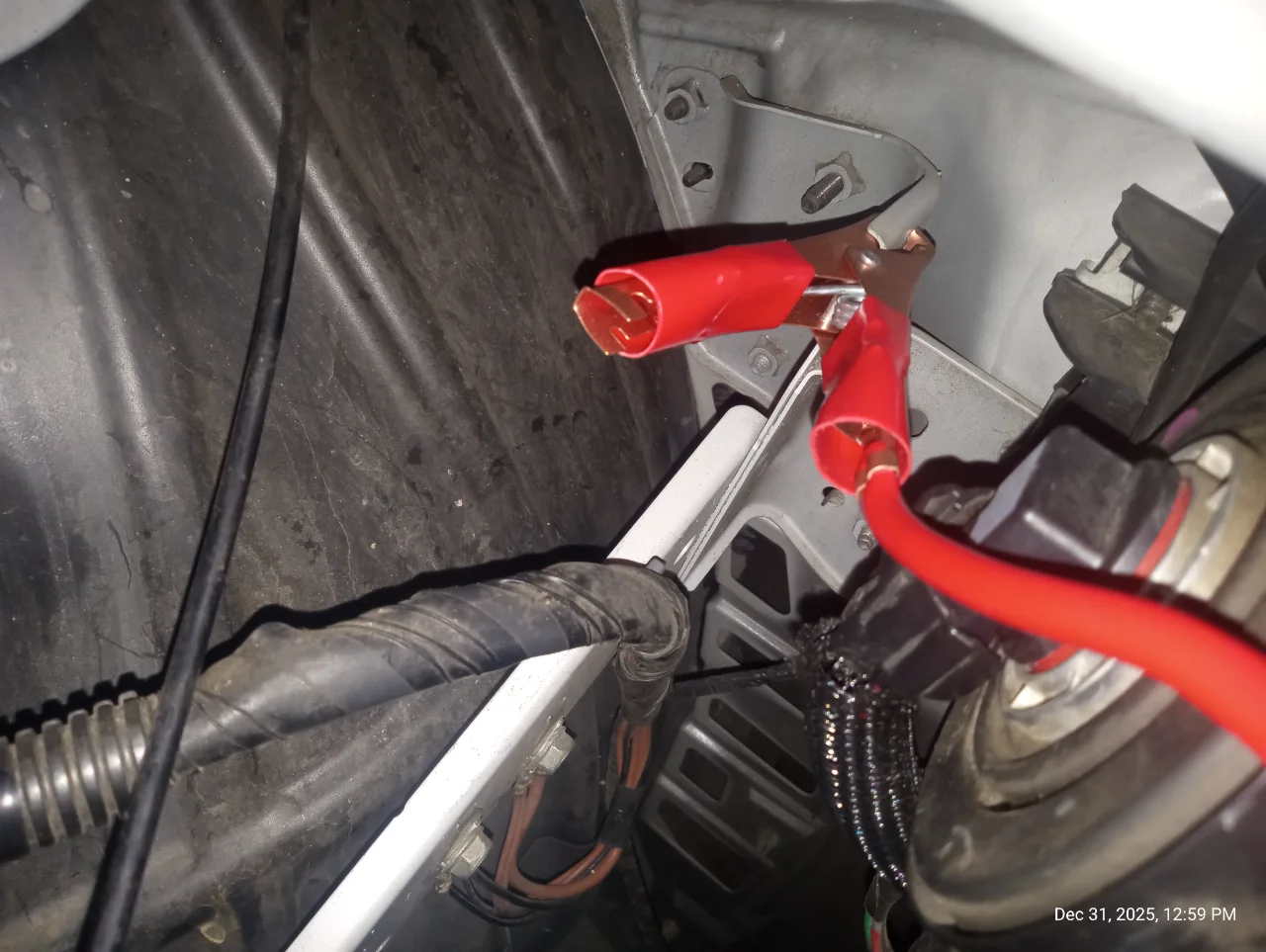

Will read the revised #63 in a bit. Found a few things in my tool box so tried this for now. Is it ok to use the same point to ground different wires? I wasn't sure because the other strut tower bracket offers multiple holes.
Yes, you can use the same place on the body to attach the ground cable.

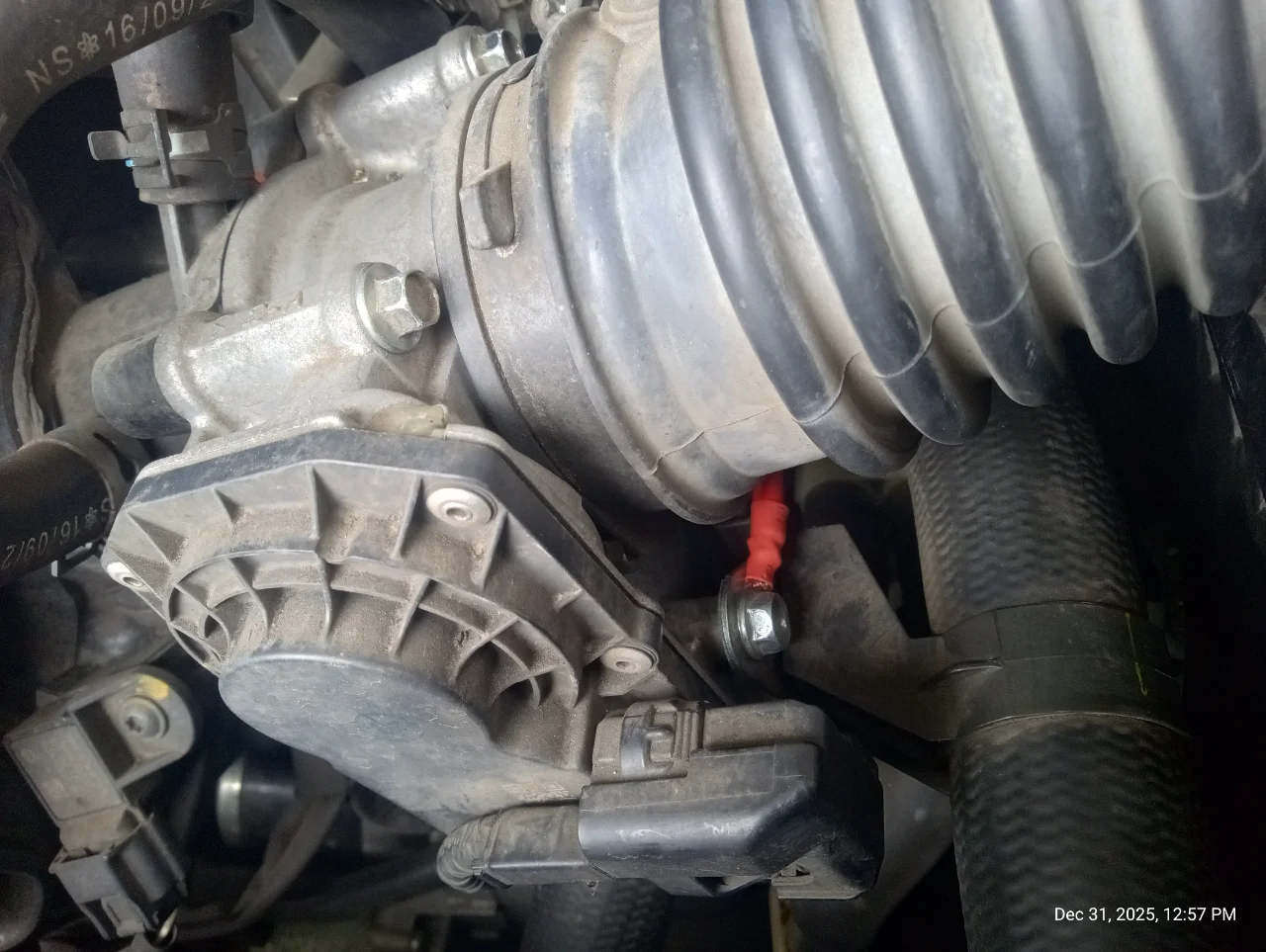

I added one today from the 5th bolt on the TB (that secures a bracket for the rad hose) to the driver side chassis. This looks wrong, I know. 😂

You really want to bolt the wire, just clipping it is not a good connection.
X2, a bolt will get a good connection. The clamp has to ground through the paint.
I use star washers that "bite" through for better grounding.
If @Nevada CX5 has a clamp on DC amp meter he can confirm if its working.
I would cut off the clamp and put a ring connector. I bought an inexpensive tool for making this connection. Its not professional looking crimp but it holds.

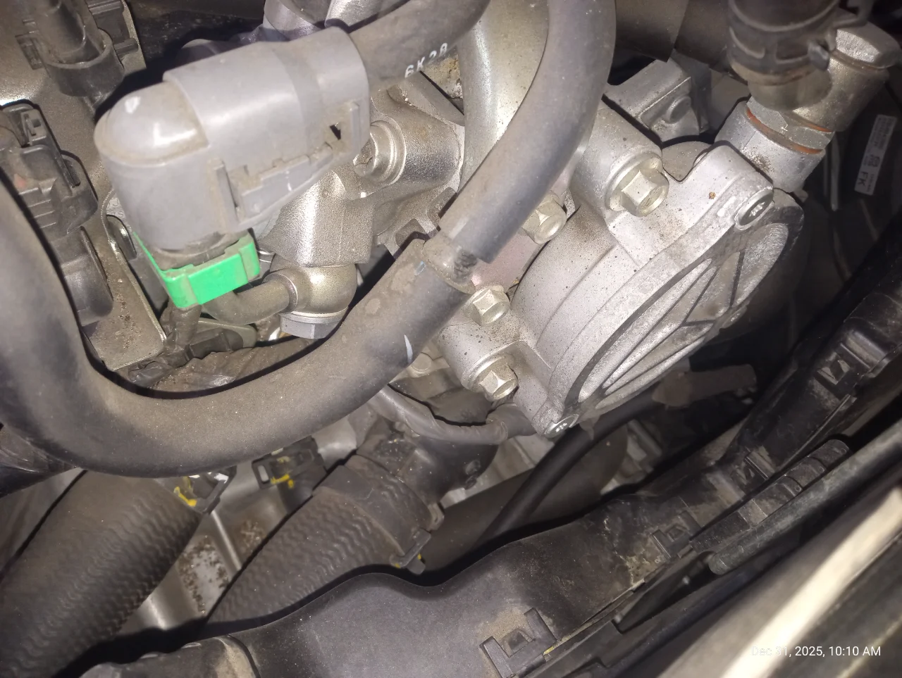

Are these bolts good points to ground? This is on the driver side of the bay.
For the hole on the back of the engine, I use a battery terminal bolt [square head] coming up from under because it's easier to tighten the nut from above. There isn't enough clearance to work a socket or open end wrench though, it's too close to the valve cover. Right now it is only hand-tight. I might have to choose a different spot.
What year is your car?
I'll have to open the hood and compare your picture. I don't recognize this area....
Does you engine have a factory ground bracket on the driver's side? Thats an easy place to attach.
On the passengers side on top of the engine near a coil over I landed a ground.
