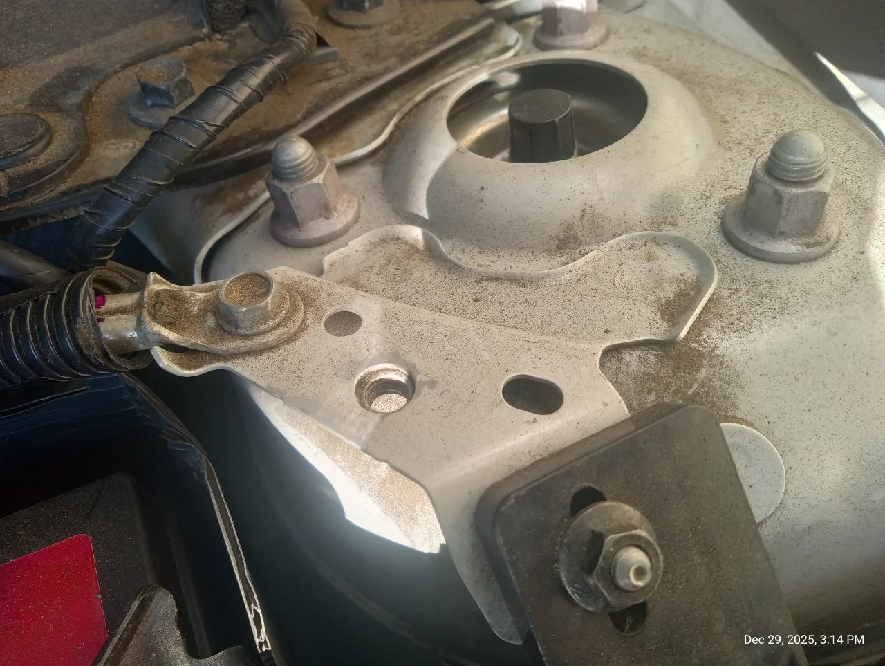

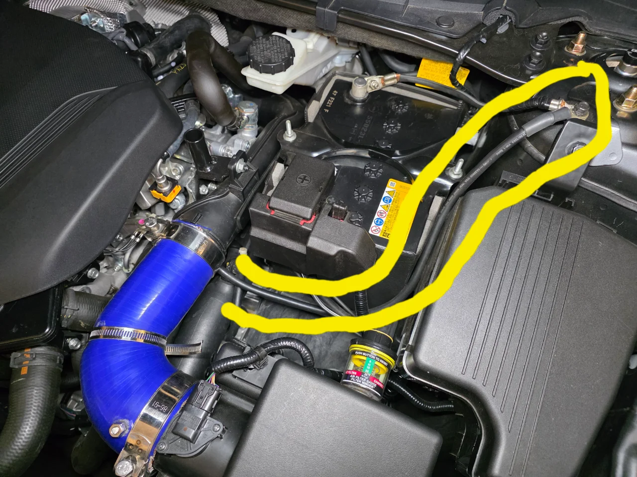

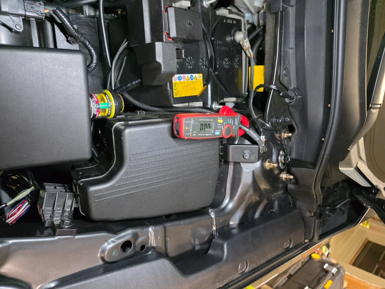

Drivers side, body is connected where the battery grounds. Engine side is where Mazda put some tiny grounds.
I have a clamp DC volt meter confirming the system "likes" these locations. I didn't start the car for this photo. It normally shows from 5 to 10 amps when it's on the correct locations or if the car will respond to more grounds.

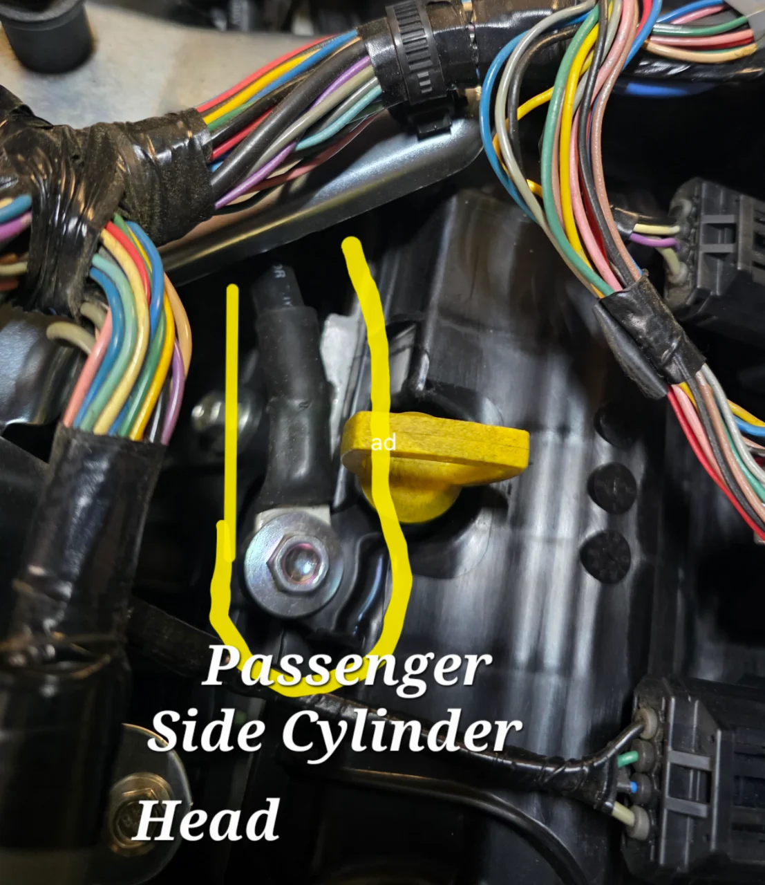

Here is the passenger side. I used star washers to help the cables bite into the mounts for a better connection.

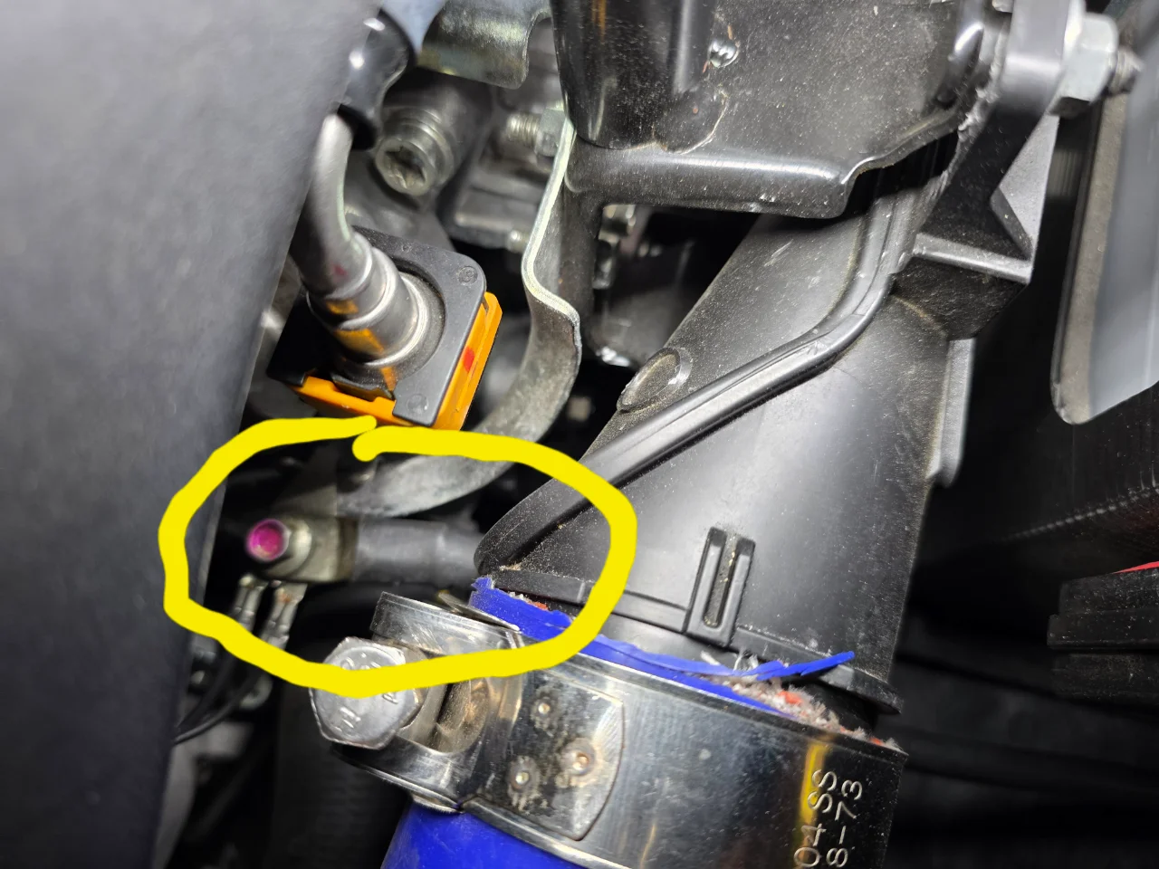

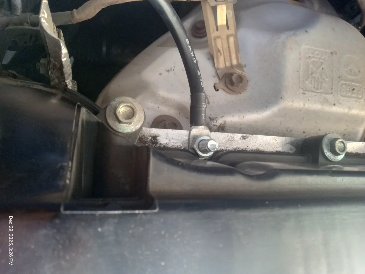

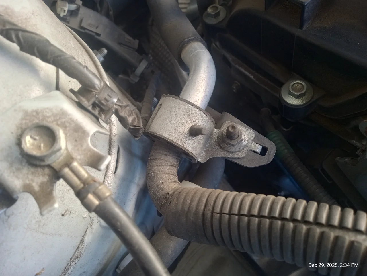

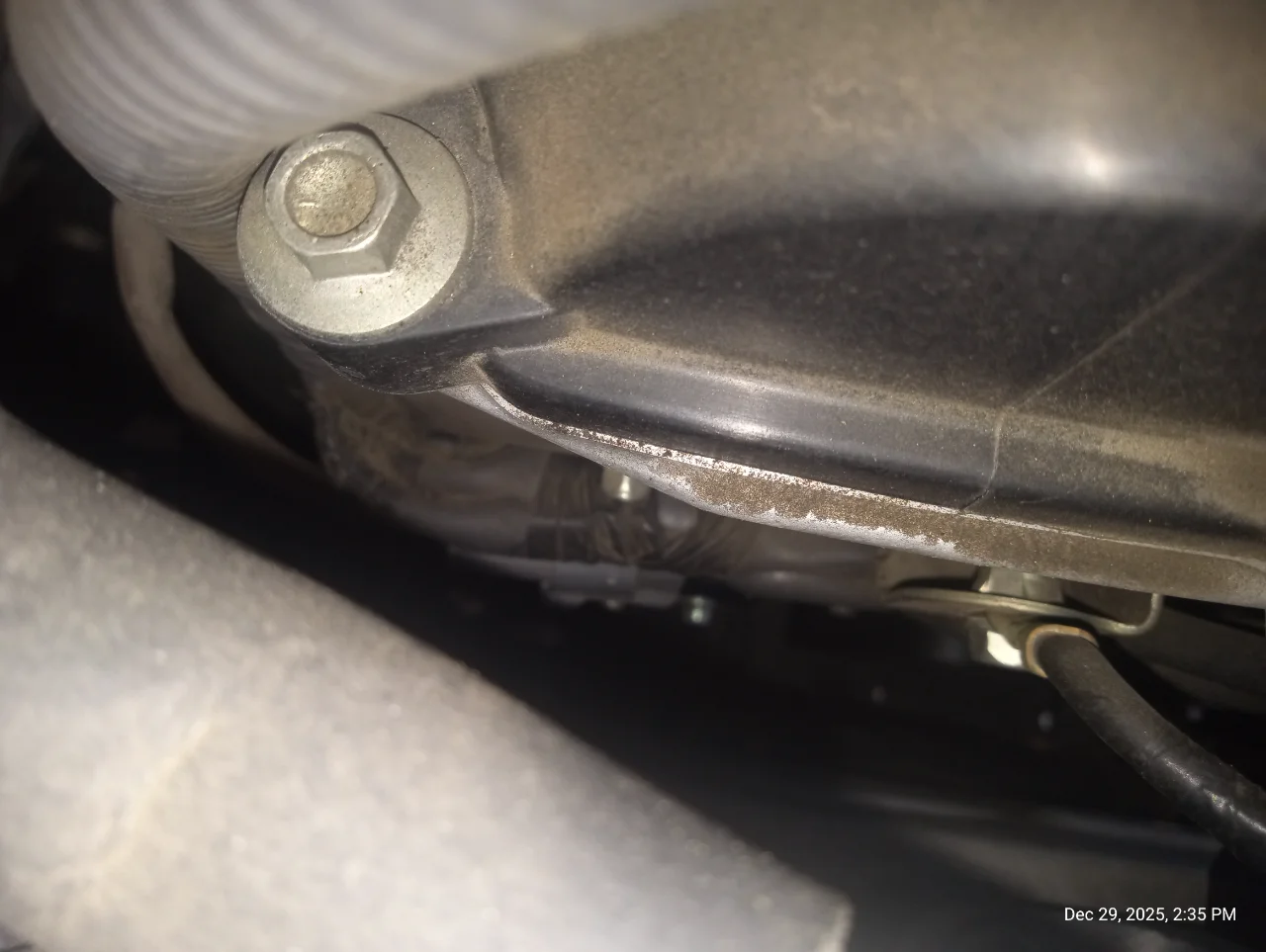

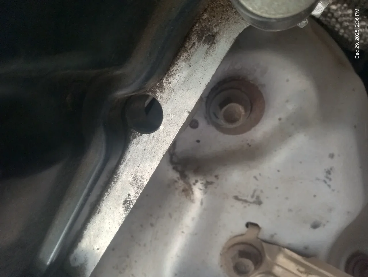

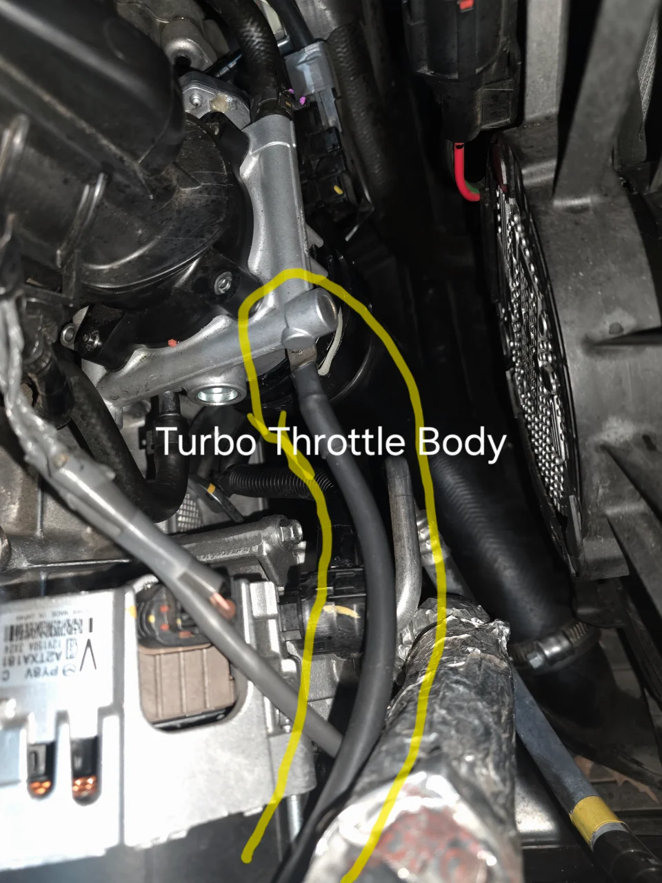

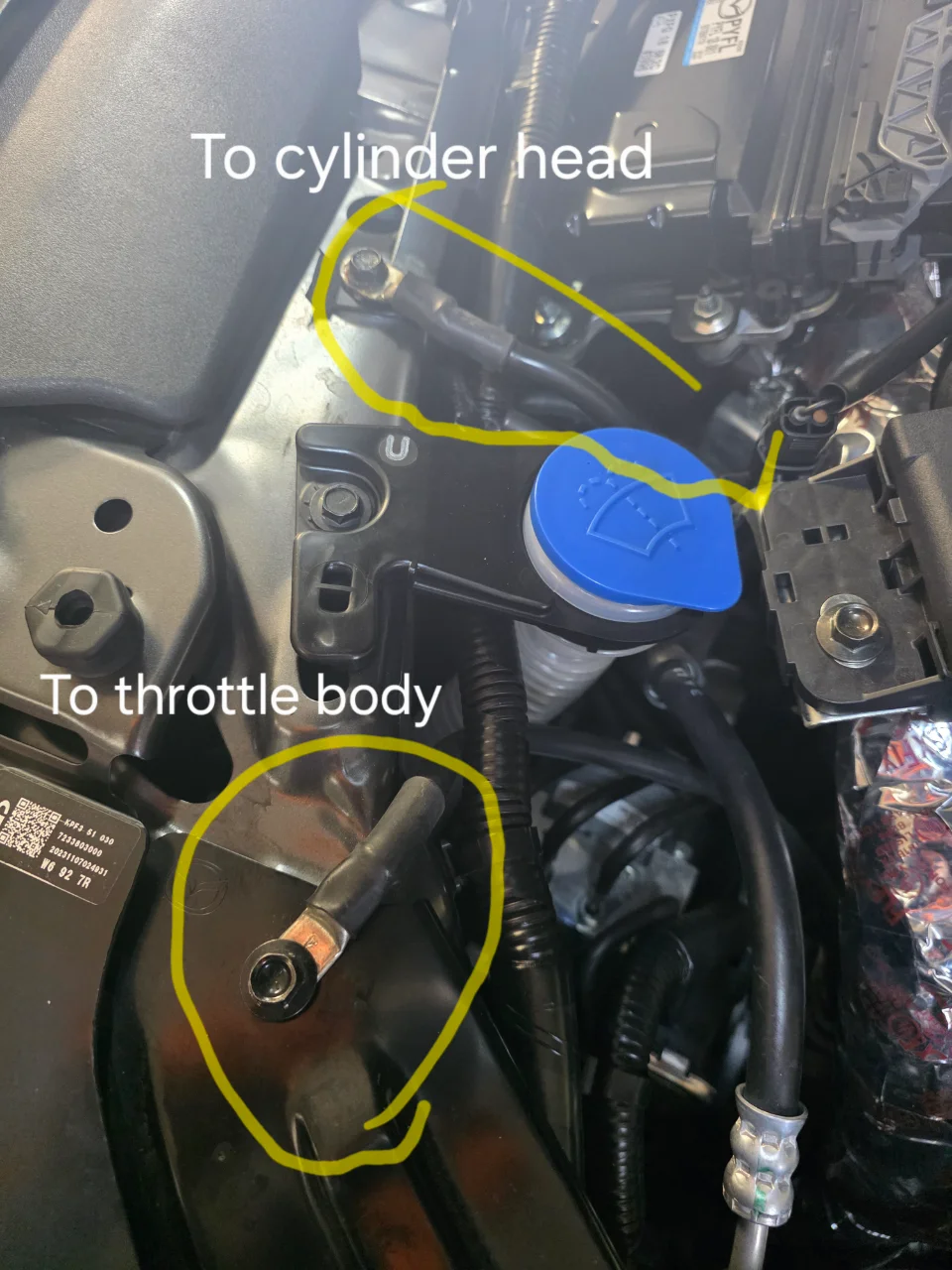

I started looking around and saw this wire on the passenger side of the bay that goes from a bracket on the head to a bracket by the strut tower. Also found two holes on the back of the engine, the last picture shows one of them. If that's on the head, then it's a pretty easy task. Two is better than one? Ready to order wires.
Please check out edited post 63 for revised pictures.

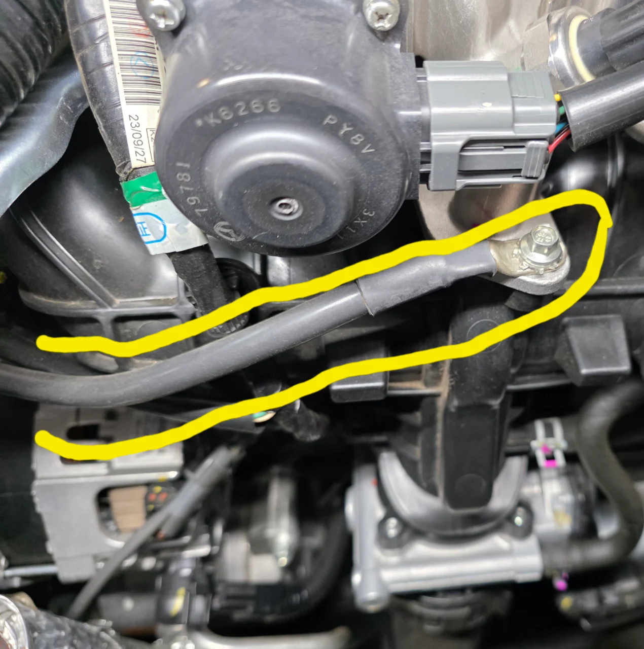

I made a correction on the passenger side and Throttle Body today.
I didn't remember putting 2 cables to the heads on the Pass side. Its been almost 2 years since installing grounds..
Today I moved a cable to the throttle body. Darn turbos stick the TB in a difficult spot and require removal of a fussy connection.

Now with a ground directly on the TB and reset the adaptive. Throttle and shifts are silky smooth, like it doesn't have a 380 HP tune in it. I didn't hammer it so it will be smooth for my wife. One 50% throttle confirmed it still has the T2 380 HP tune!
If we hadden revived this thread, I may not have ever put a ground on the TB.

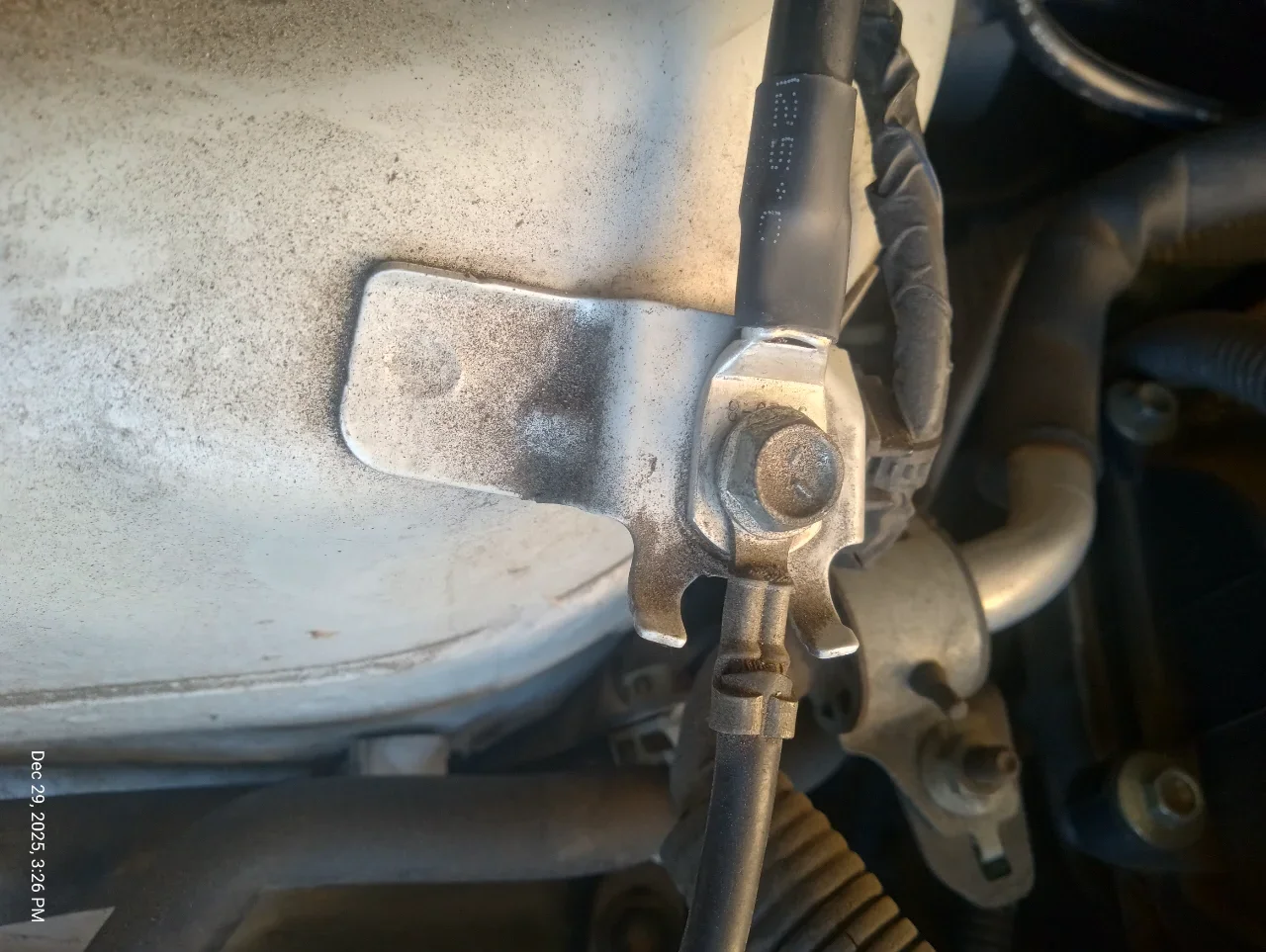

Will read the revised #63 in a bit. Found a few things in my tool box so tried this for now. Is it ok to use the same point to ground different wires? I wasn't sure because the other strut tower bracket offers multiple holes.

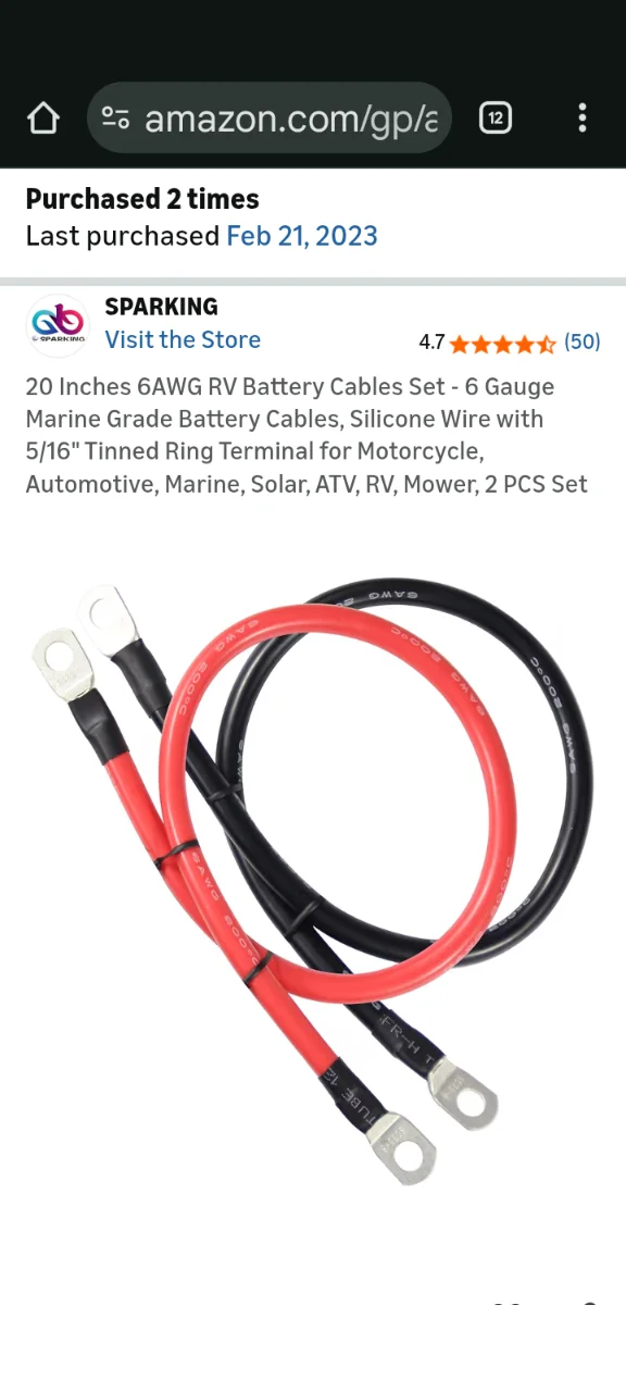

The grounding kits on Amazon usually come with 5 cables, 4 sets of nut/bolt/washers and a bracket with 4 mounting points. The cables look kinda thin though.
I found a few more sets of these cables from my solar setup and will try to add them today. Judging by the available mounting points on the driver side bracket, Mazda wanted me to do this. 😂
