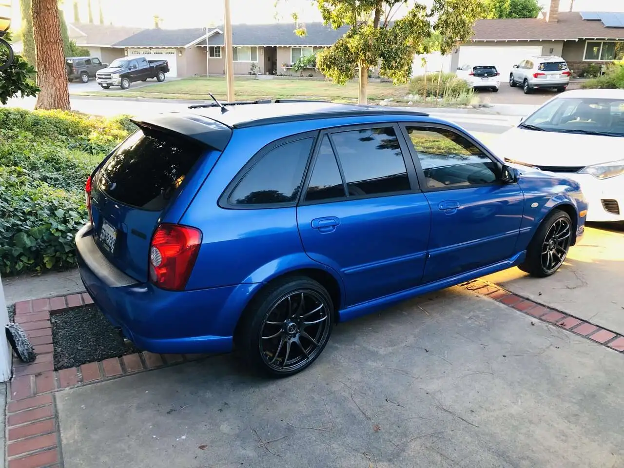

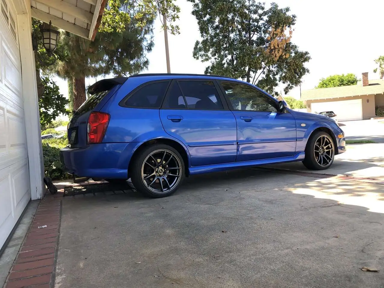

After 3 years of sitting in the driveway due to a blown engine, she’s up and running again!
I feel like a child on Christmas Day cruising around in it.
Low-mileage engine transplanted along with clutch/flywheel assembly, new motor mounts, radiator, pumps, pulleys and belts, plus an AC Compressor and lines.
I’m falling in love with it all over again. I found some wheels from a local enthusiast and plan to work on suspension and brake upgrades next.
The clear coat has failed on the roof and hood due to the California sun, so a gloss black wrap may be in the works for a temporary fix.
Oooh Laser Blue! I think that's my favorite color on a P5. Curious, what kind of low mileage engine did you get - is it a USDM junkyard engine or a JDM engine?
It was something sourced locally, still getting all the info from my mechanic.
It does drive and sound super smooth so I’m happy with it. Never gonna be a fast car, just a fun cruiser. 😃
The oil change place responsible for trashing my engine in 2020 replaced it with a JDM one from a local, reputable vendor. With all the mayhem during the early days of the pandemic, the shop never gave me any details on the transplant engine (e.g. mileage). Without my having access to the donor vehicle, a JDM (or USDM) used engine reseller (or the original recycler) can simply lie about the mileage. I've heard that reported mileage on used engines often conveniently seems to fall within the same Goldilocks range... But as long as the engine is solid (mine is, and sounds like yours is too) you should be happy. :)

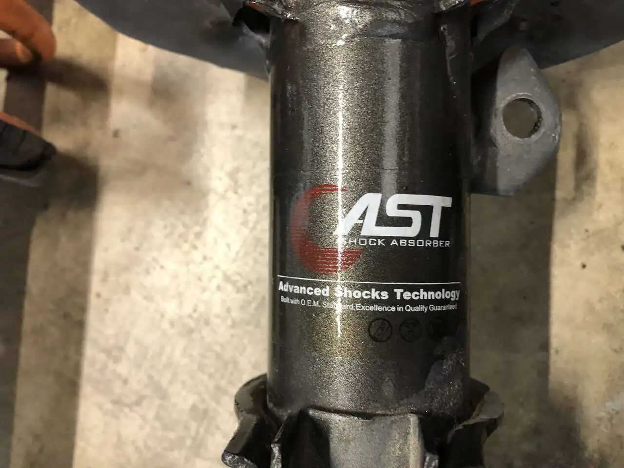

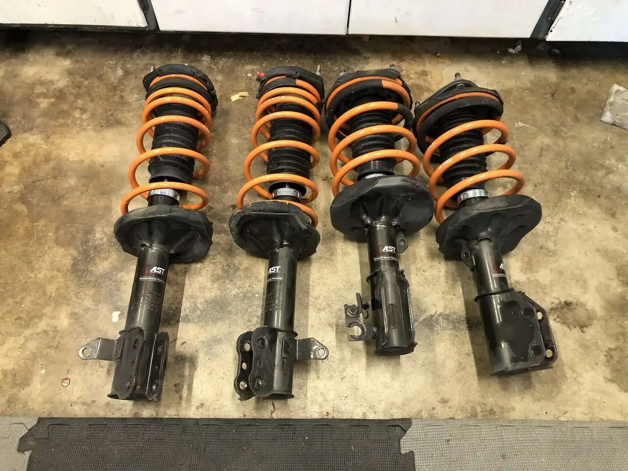

Interesting. Never heard of AST struts. Where'd you pick those up from?
From a member of a FB Protege5 group who is parting out his silver P5. They are from the Netherlands, I'd never heard of them before either. They are fairly new, in great shape, and were a decent price, so I'm happy to give them a shot.
Previous owner claims they were just stiff enough to be fun, but don't rattle the trim loose on your car, LOL.

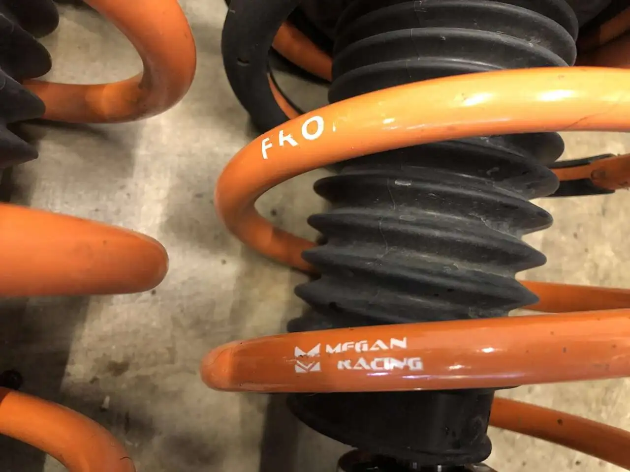

I just placed an order for the Delphi control arms and trailing arms, and some end links.
I grabbed a few camber bolts too just in case. I think the strut/spring set I just picked up has close to a 2” drop.
I’ll keep you posted when I receive the parts and start the installation.
