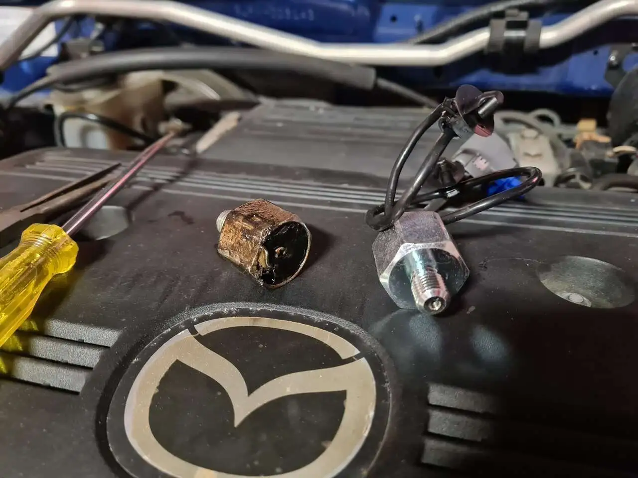

Knock sensor was a teeny tiny bit melted :P

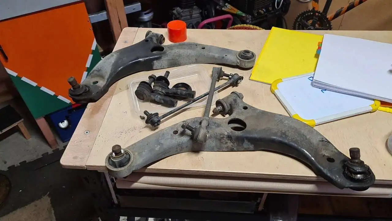

Front control arms, swaybar links and steering rod ends out. The RH ball joint was the worst part, wouldn't budge at all! Also did the gearbox seals while everything was out
New stuff in 👍 Front discs and rear shocks are the next big job

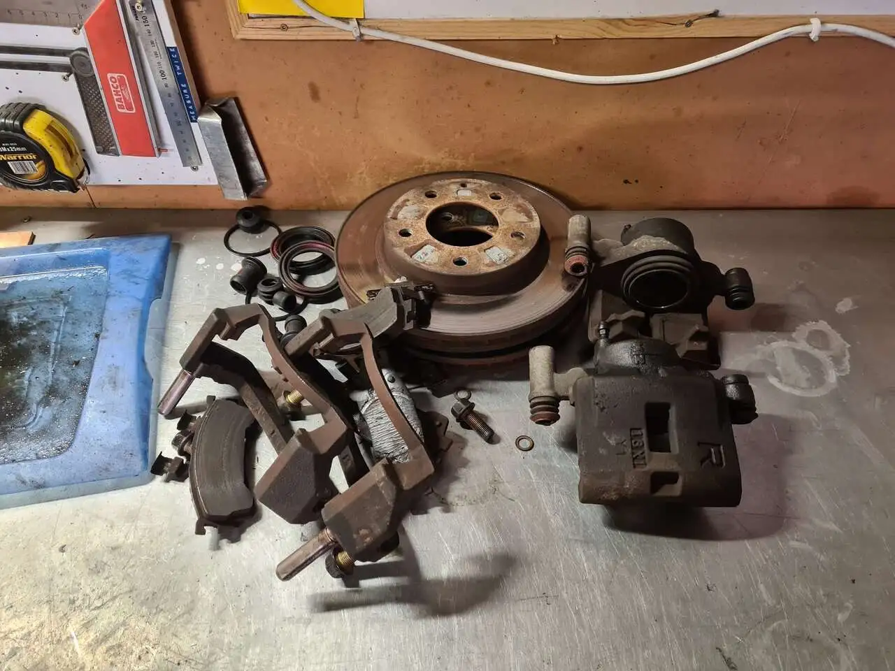

Car did NOT pass it's inspection :( blown park bulb and the front brakes were binding slightly.
I had the first gen mazda6 brakes from the red car with near new disks and pads so I grabbed a rebuild kit and slapped them on. Easy fix!
More offerings to the scrap gods:
Then I tried to turn a front wheel, the brakes bound up so tight the wheel wouldn't budge 🤔
Turns out the aftermarket control arms got reeeaaaaalllly close (just touching) to the old, worn disks and with the fresh disks it just jammed itself straight in to the disk face :( So I trimmed it back a bit and painted the edge 🤘

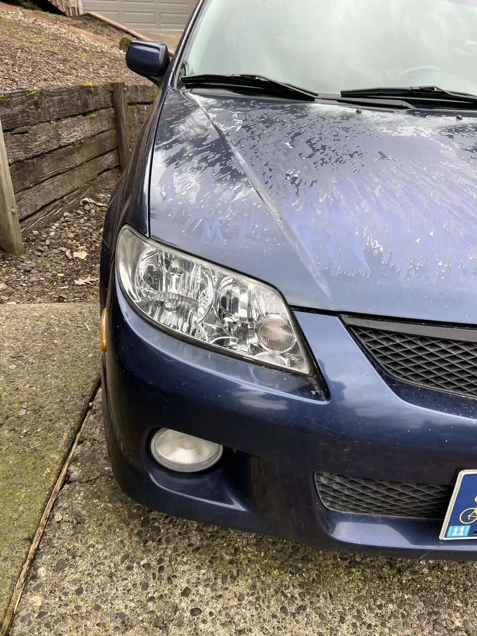

Aside from the P5 gradually flaking all clearcoat off with this weather, the headlights have been dodgy and yellow since I purchased the car. I finally sacked up and dove in and I am stunned at the difference. I have always loved 3M products, so I bought this very inexpensive kit on Amazon - https://www.amazon.com (commissions earned)
Frankly, they are stunningly clear now. Just shocked. I can't recommend this 3M kit enough. I also did one of the lights on my MSP and both lights on my CLK320 and there is a ton left over.
