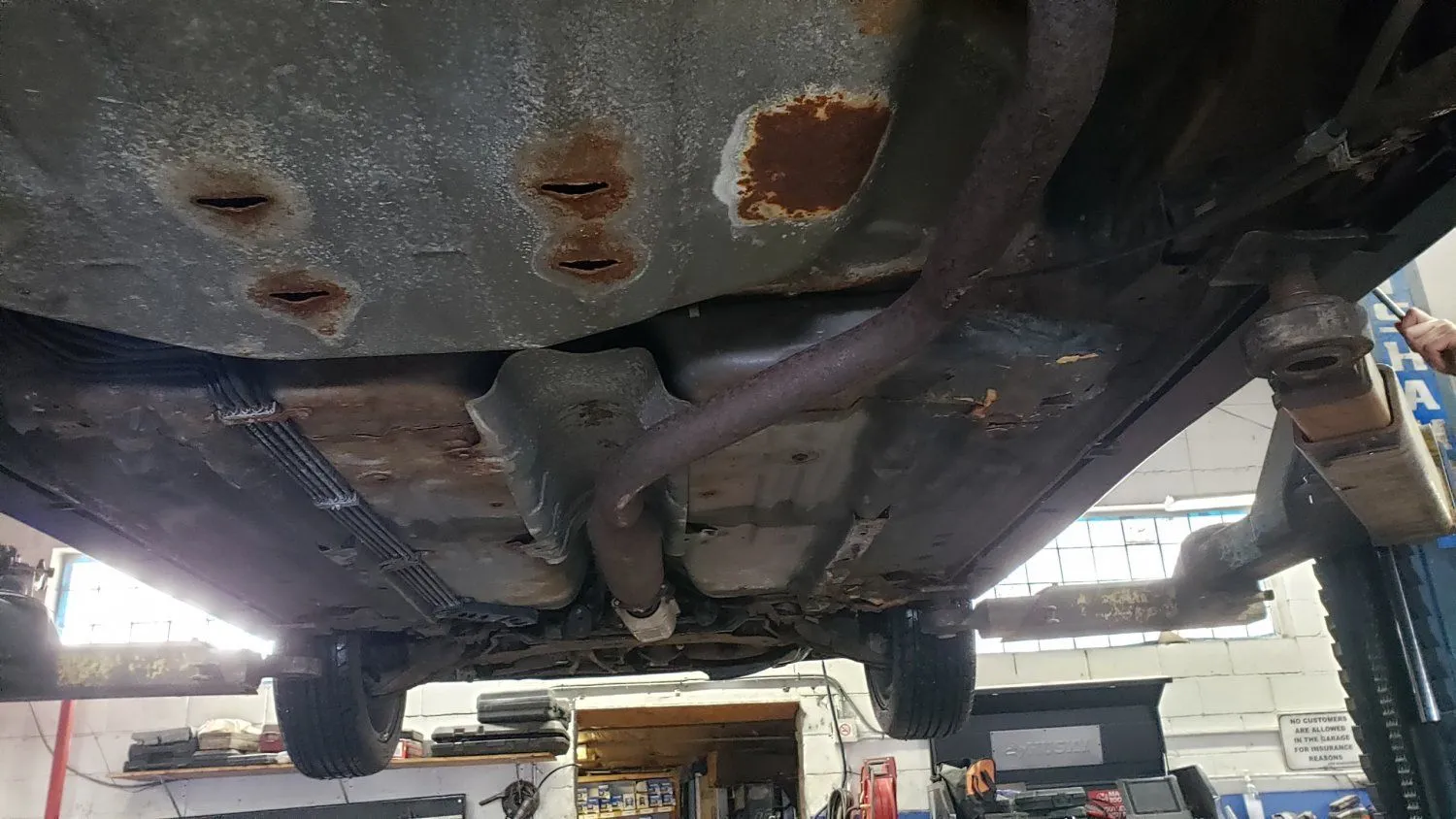

What I thought was the noise of a grenaded transmission from me driving like an absolute jackass turned out to be a bad cat! Now, I've got the option of gutting the cat or getting a new one. I'm leaning towards new cat because I do not want this rice rocket getting any louder than it already is, but let me know your opinions on it.

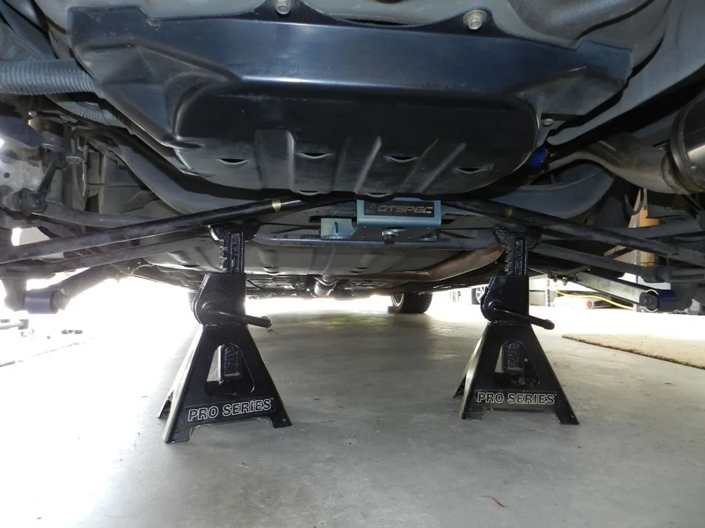

And here's a bonus: A photo of the undercarriage in my rusty, 18yr old New England Protege5 . I told y'all it was rusty!
Thats cute, you think your p5 is rusty :)
Having my cat gutted by my mechanic, because I do not have $215 to pay for a new cat plus labor. And who knows, maybe I'll like it how it sounds + the added performance of a gutted cat.
Probably not much HP, but it might help your throttle response by letting it breath better. More responsive throttle = more fun to drive.

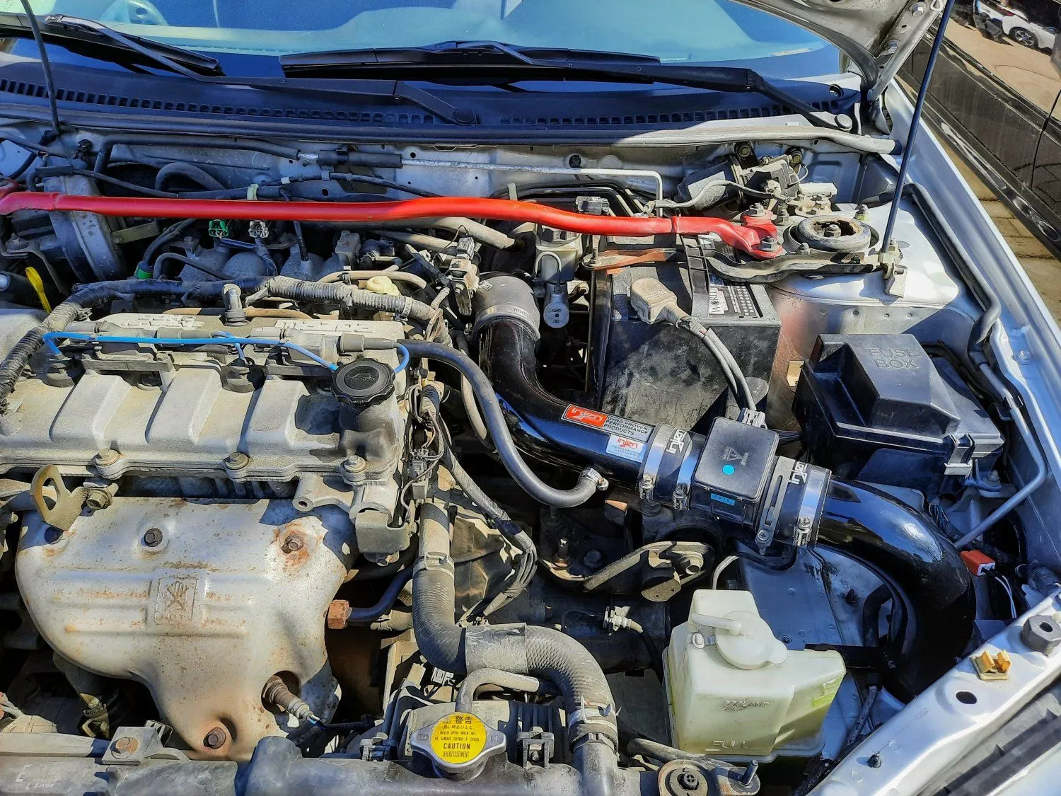

Done a lot today for Nezuko:

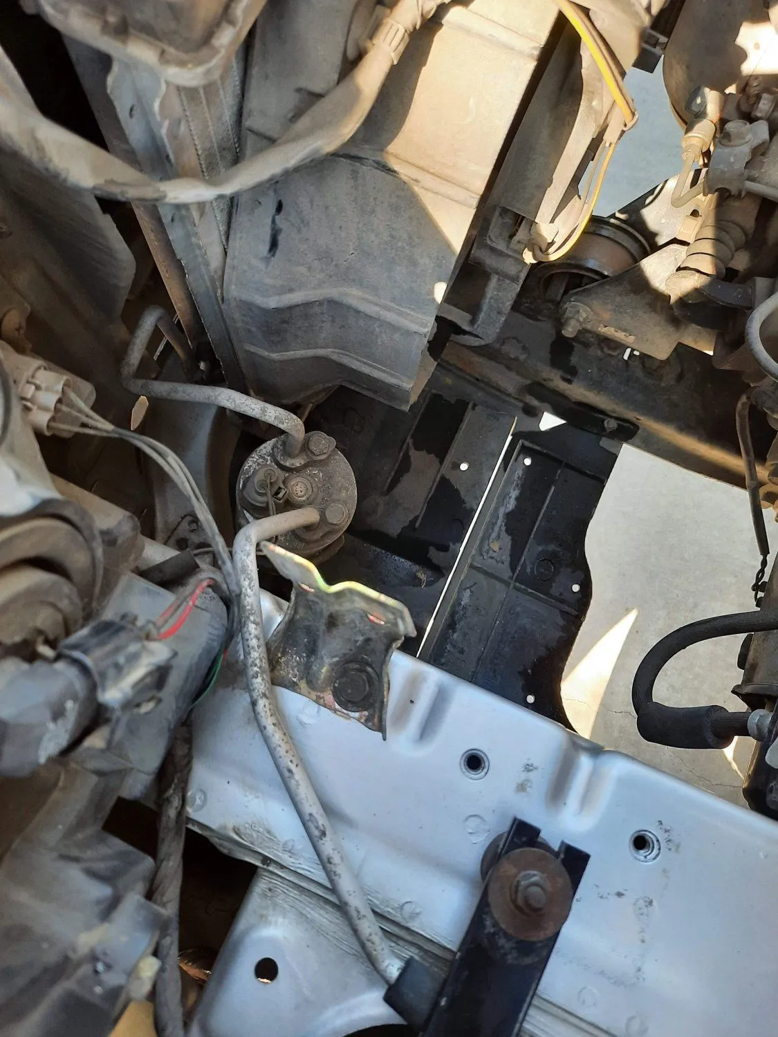

-Used Injen cold air intake came it. I bought a K&N conical filter replacement and installed seamlessly. I was thinking about the coolant reservoir relocation as my used intake didn't came with the relocation bracket. I do not like hacking into original parts but I just cut the factory intake bracket. Turned out well and the relocated reservoir is secured properly.

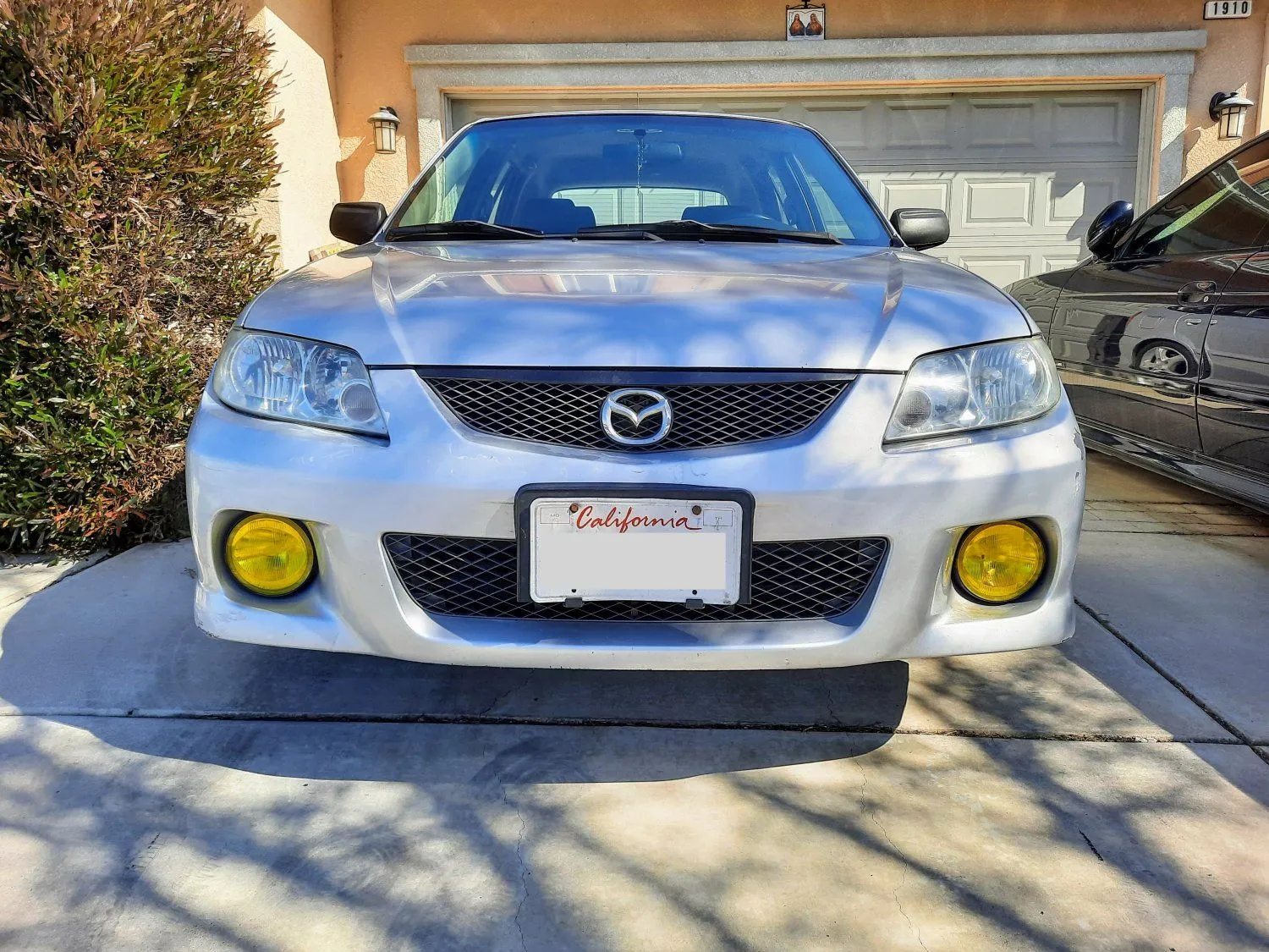

-Installed Lamin-X yellow fog covers. I really like the look; the front pops more:

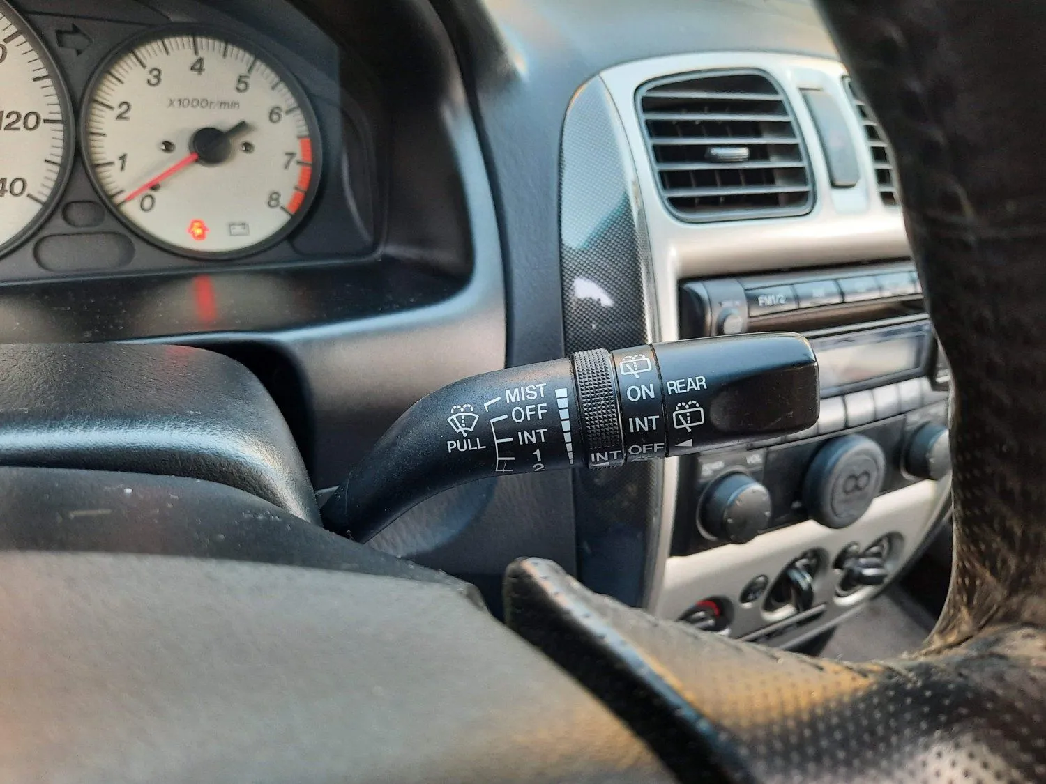

-Installed Crux bluetooth interface. Sound is much more louder and cleaner compared to bluetooth via radio frequency. Also installed the intermittent wiper upgrade off a 2005 Mazda6. Works as advertised.

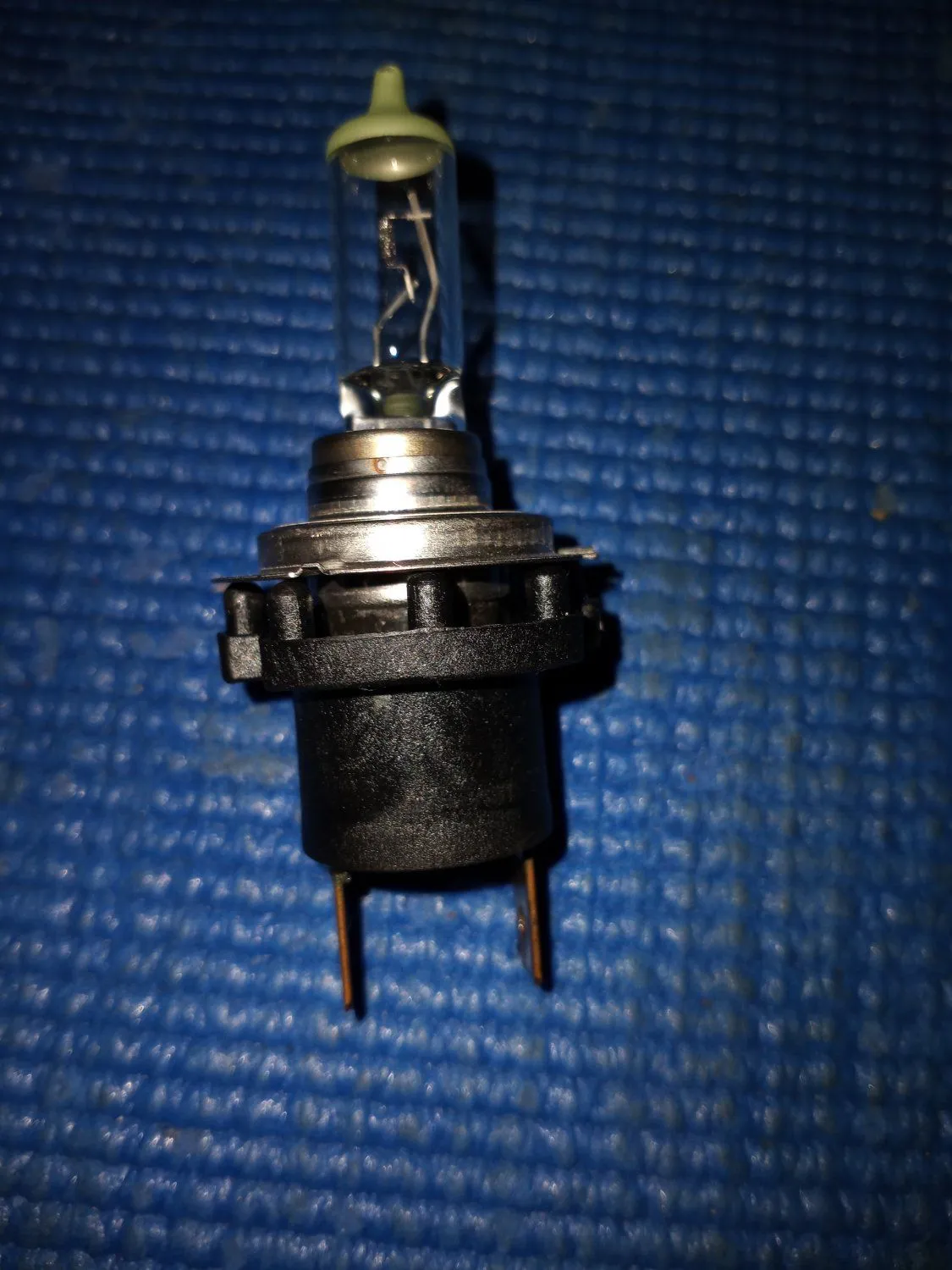

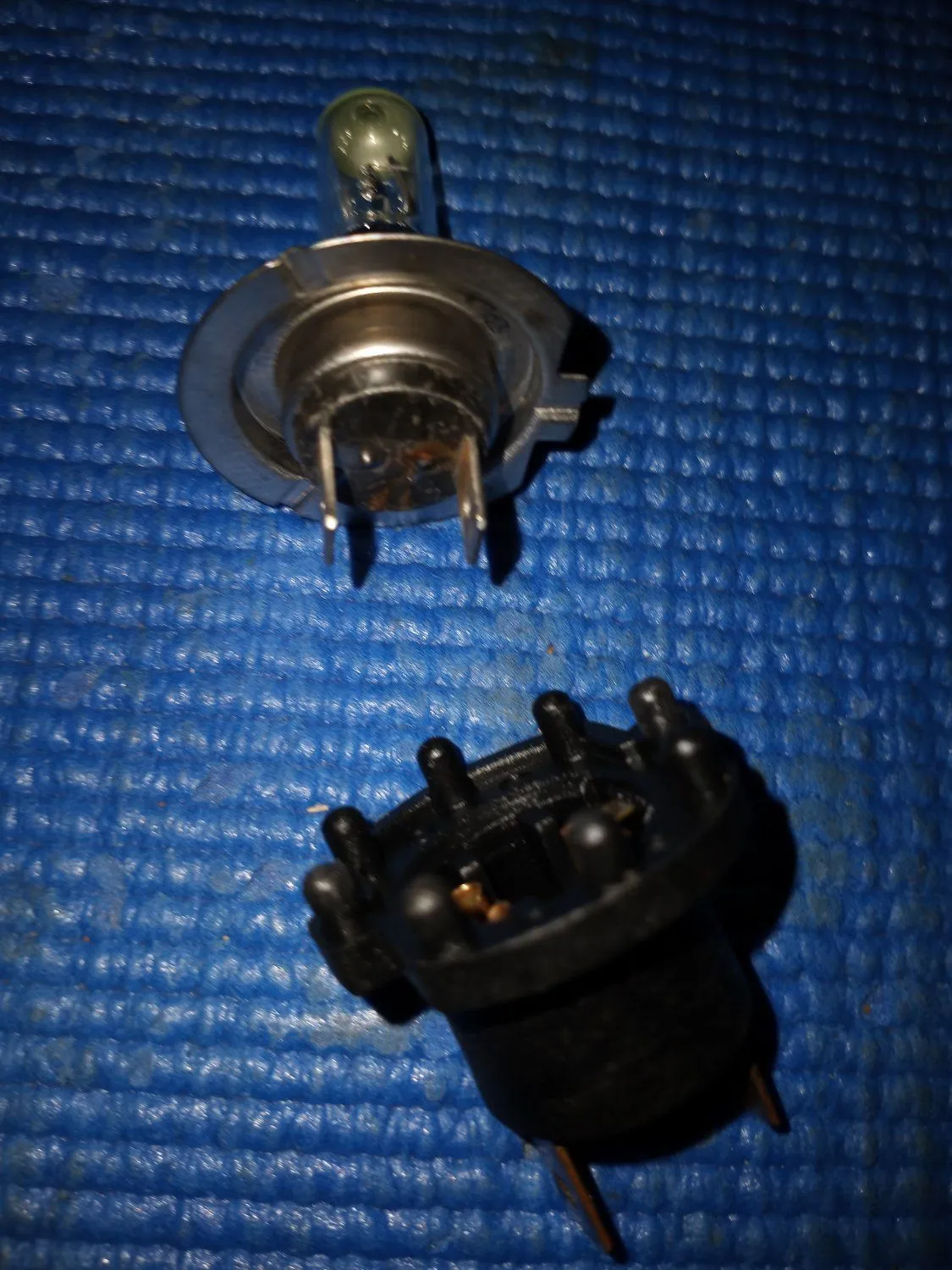

one of the headlight bulb went out- went to a local automotive store without doing my research and blindly trusted the associate's recommendation. Turns out it's the wrong bulb. Back to the store I go.
The low beam bulbs have a plastic bulb socket on them.
You may have the right bulb.
Good looking out though because I had no idea what that socket was when I first pulled it out!!
When I changed my first bulb, I did it in the parking lot of the auto parts store and threw the old bulb and socket in the garbage can.
I had to dig it out of the garbage after I tried to install the new bulb.
I thought the socket was part of the bulb.
Yea. the one they sold me was just a tad too big to fit into the socket. Went it and got the right part.
You probably had a bulb for the sedan.
My parts car had the wrong bulb installed and it wasn't locked in place. It was too big like you said, and wouldn't clip in.
It plugs right into the electrical connector if you don't use the adapter.
I don't know if it's the high or low beam that illuminates if you plug in the sedan bulb?
