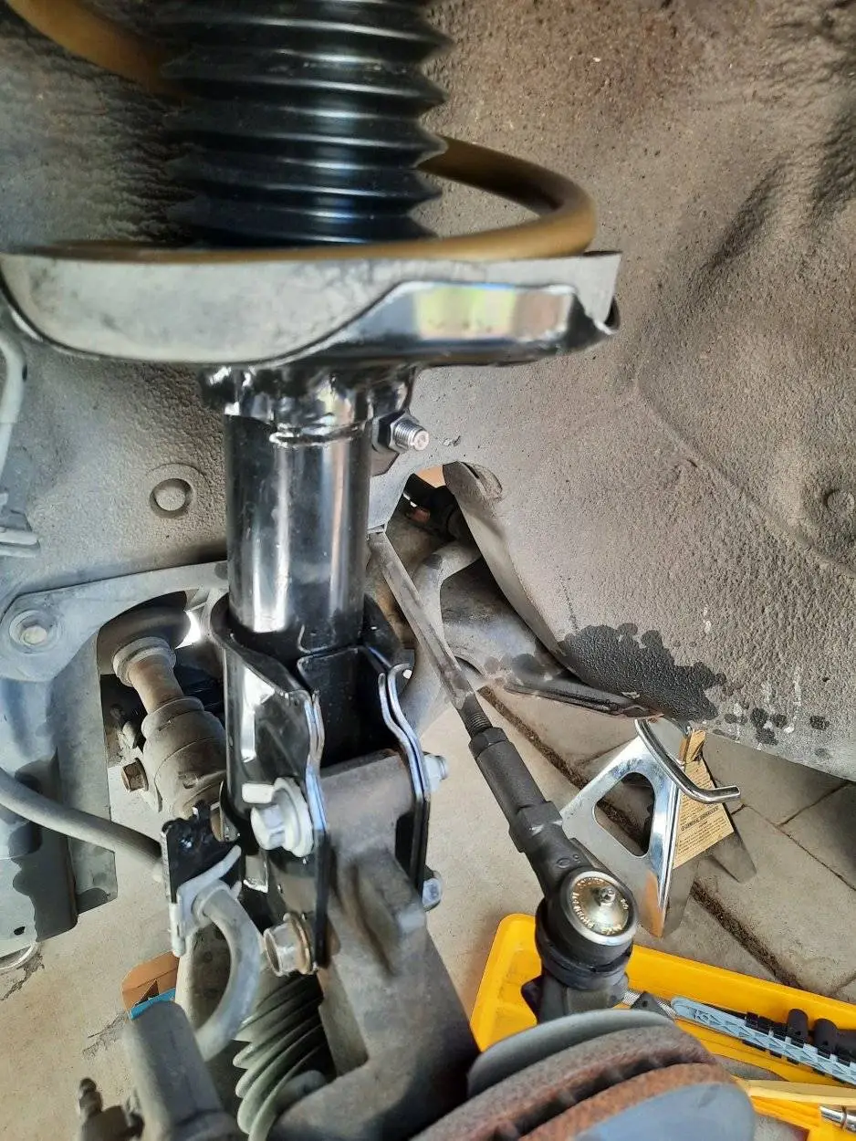

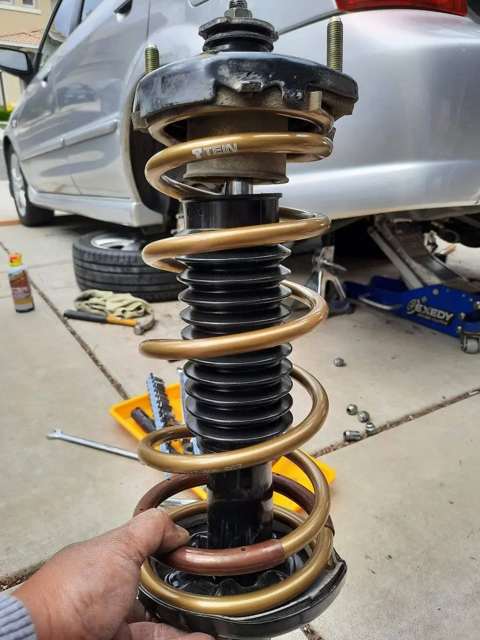

I installed the GR2's new along with the springs. Ride height is just right as this is my daily driver / kid hauler. I would say The Tein H.Techs paired with the GR2's are the edge for me for ride comfort. It feels so much better in the corners though.
Rears are already installed and their is not much difference than yesterday, it just leveled out front and rear.

I installed the GR2's new along with the springs. Ride height is just right as this is my daily driver / kid hauler. I would say The Tein H.Techs paired with the GR2's are the edge for me for ride comfort.]
You can’t use regular length shocks with lower springs because you’ll spend too much time at the compression limits and blow out the seals. Especially the terrible KYB’s. We used to call them pogo sticks.
While I agree with DiamondDave's statement I will add that that is more evident on something lowered more than 1.5". The H techs are like 1" and are far less susceptible to premature wear. Most likely theyre just stiff from everything being new. Give it a few hundred miles and itll soften up a bit.
The ride is a little stiffer but far from a pogo stick. An inch drop does not really necessitate short stroking the shocks, that is why I specifically chose the H.Tech of the S.Tech.

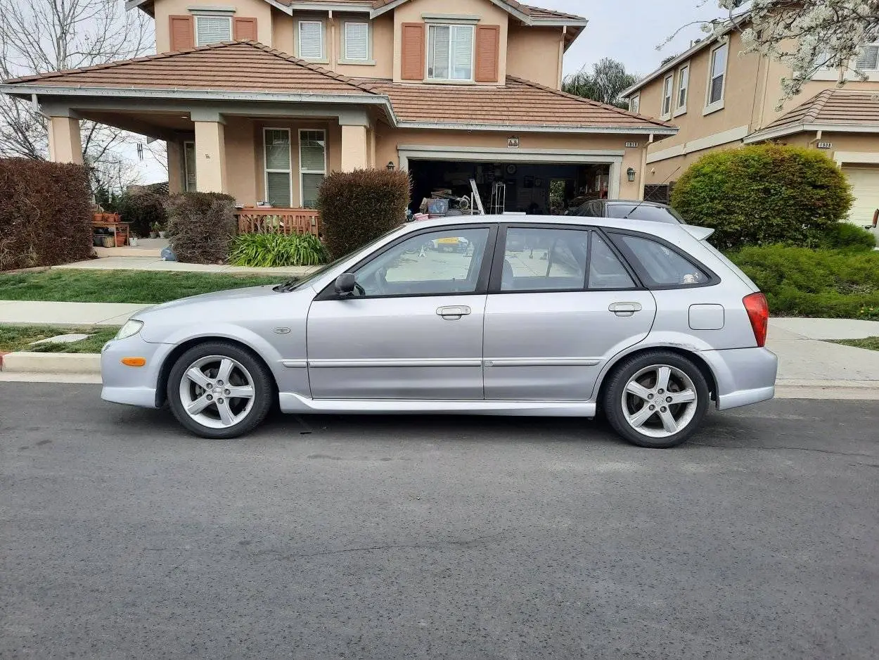

I sadly missed my estimate of pulling into my driveway at 260k yesterday by one mile :(
This will be the last major milestone for this cars life at this point. I drive my miata or mk4 tdi much more often and after nearly 12 years of reliable service, the p5 is really just back up transport.
I replaced the heater core hoses in it the other day to get rid of that leak though finally!
I swear the laser blue color is especially bad with the rust.
Congratulations at 260k!
thanks! I know a lot of the rust is on me just not taking care of it like I could with regards to regular winter washing and such. Really a shame since the motor, transmission, and clutch are still all original and work absolutely great. Consumes oil but just top it off and keep driving! Just wish it rode smoother but even new suspension didnt fix it :(
Yea I feel the same way. It's. Really fun car but everything else is such a bummer. The newer mazdas doesn't seem to offer the same "fun per dollar" as the p5. Maybe I'm just being a little bias.
The only real rust that I have are the door trims and it's almost rusted through. Every blue mazda that I found at pick n pull all have rust in the exact same area.
