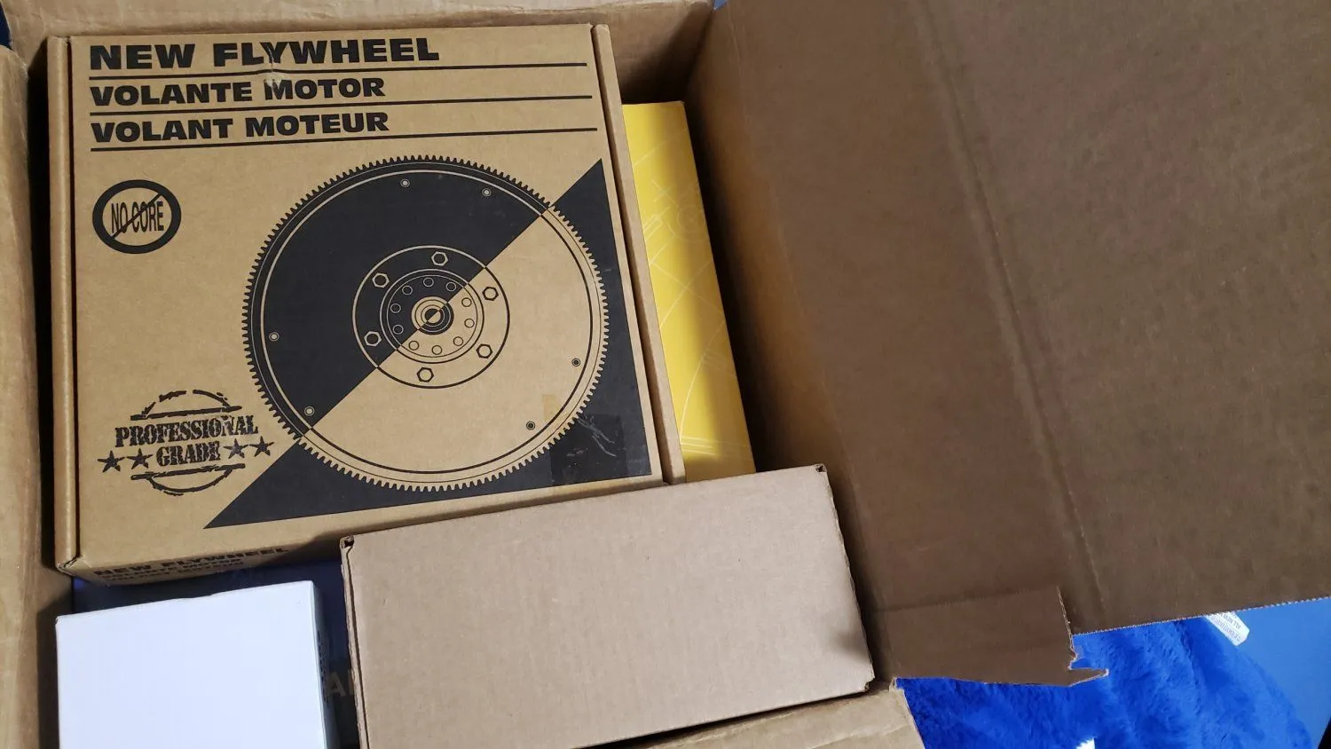

Clutch goodies arrived! Also, me struggling to get this box inside my apartment reminded me of just how out of shape I am🤣

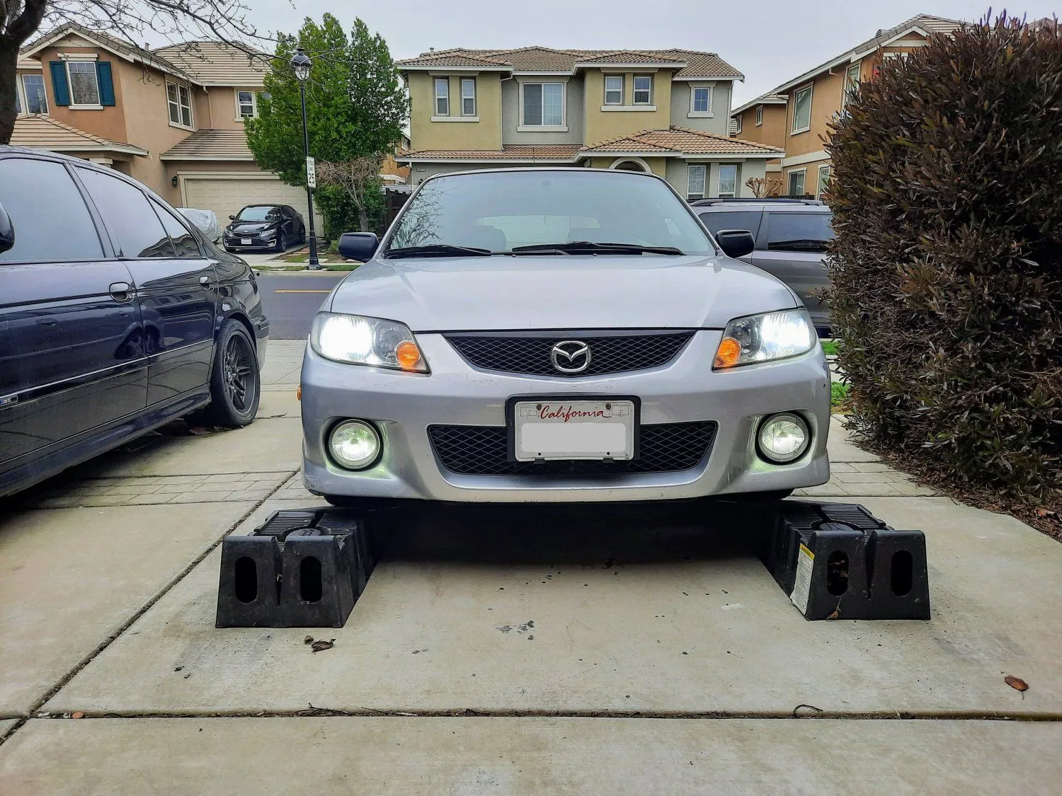

Questions:
1. Trying to change a low beam bulb today and can't seem to pull the power cable off. Is there a clip that I am not aware about?
My understanding is that I should be able to pull that white plastic connector off.
2. Is there a way to service the fog lights without pulling off the bumper? I'm concerned all those plastic clips will not survive if I try to take it out. One fog light is cracked and the other needs a bulb replacement.
As always, your advice and guidance are always appreciated.
Questions:
Just replaced a low beam bulb yesterday and had a struggle getting the plug off too. The plug comes straight off with that rubber seal thingy, and yes, it's very stiff. I pulled the rubber seal thingy back to get more grip. Once it's unplugged, there's a wire clip thing that you need to unhook, and you'll be able to remove the old bulb which is plugged into like an adapter of sorts (goes from H7 bulb to white connector).
Edit: I'm sure someone can suggest some sort of dielectric grease to make the removal/install of the connector easier. Didn't do this myself though, so can't say personally.
You don't need to pull the bumper off to remove your fogs. In fact, while some people say that you need to jack the car up to reach the fog mount bolts from the bottom, I've done it several times by just reaching under and feeling around. It's been a while but I believe you have to move the plastic under tray out of the way a bit by removing some screws, and then you'll be able to get to the plugs and bolts to remove the fogs.
Edit: OH! Be very careful with the two philips screws that hold the lens onto the housing of the fogs. I ruined both on my car when I bought it because they were extremely tight and I stripped/broke off the heads. Your mileage may vary.

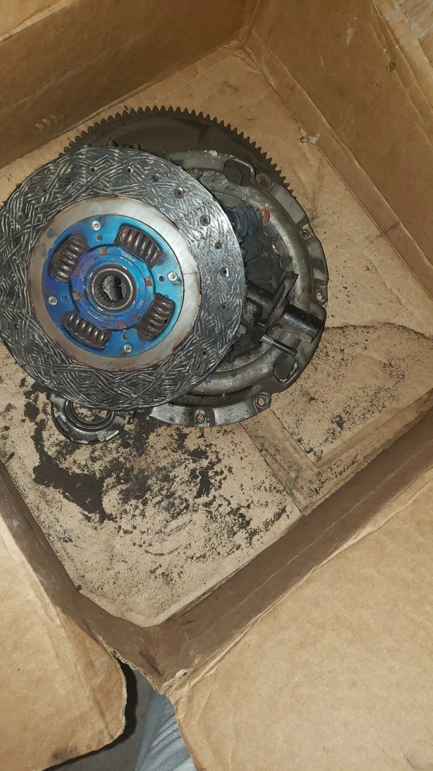

Finally got my go kart back! I mean, Mazda Protege5! And wow, is a new clutch a world of difference. The clutch takes basically 0 effort to push in, the gates feel loose, and it doesn't feel like the car I'm used to at all. But anyways, here's my old clutch and everything in it so you guys can see how bad I roasted it! 🤣

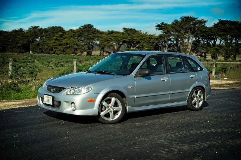

First family trip and photo op with Nezuko. Man, this car is fun on the twisties. I'm just holding back or else my son will puke, hehehe.
