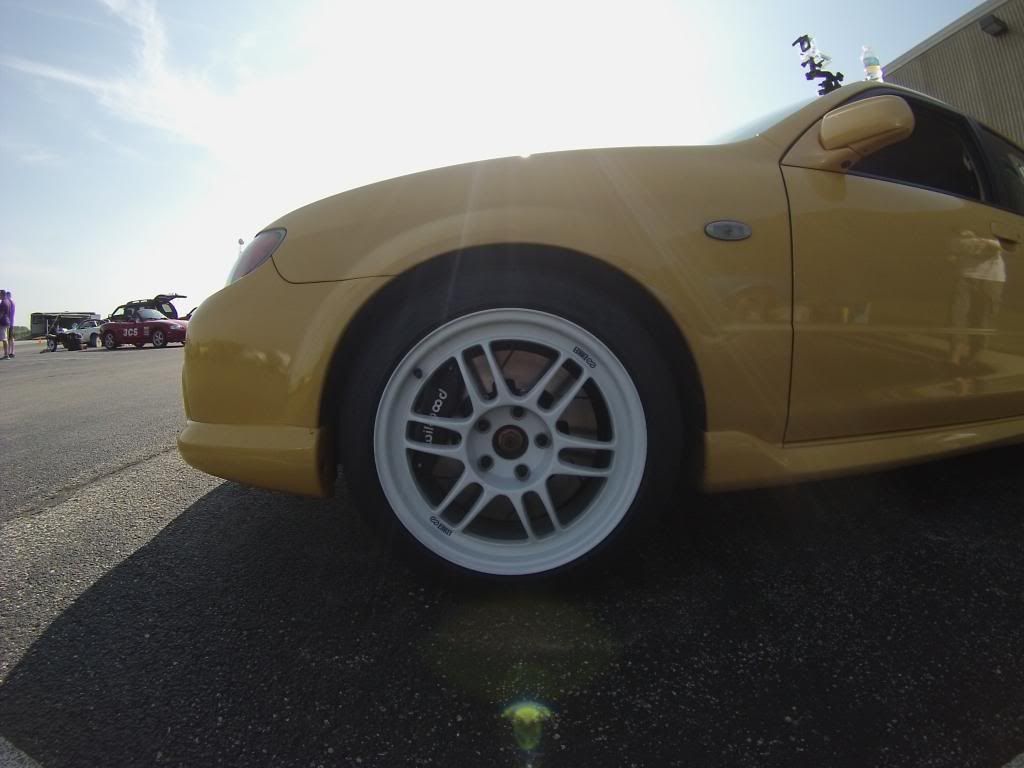

I'm curious how you managed to shave that much weight...
CF hood, 12lb battery, no powersteering, A/C, radio, speakers, lighter wheels, lighter seats, subtracting rear seats, coilovers are lighter than Tokicos. It might not seem that much when you look at individual part weight difference, but it adds up fast when you look at the over weight.
Is that an estimate or do you have hard numbers? I'm not trying to come across doubtful it's just I too have done a bunch of things to shed pounds and I don't believe I'm anywhere near where you're at...
