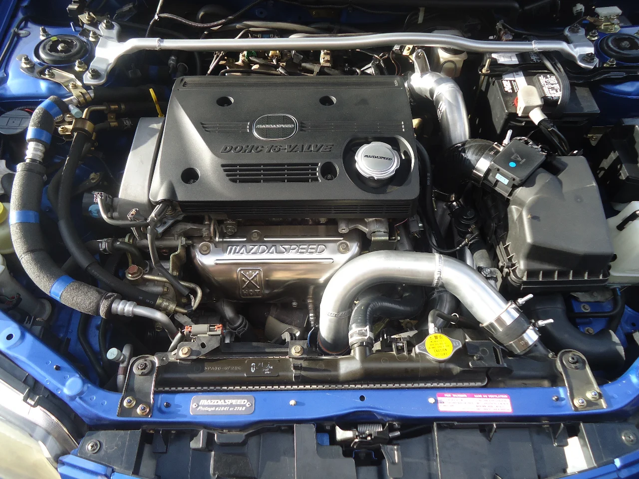

Welp, the shop conducted a smoke test and discovered a crack in the OEM plastic MAF to Turbo hose. Online research showed silly prices wanted for OEM 'duct' hoses and my setup was all OG so decided to go with hard pipes as I plan on keeping her for a long time and don't want to do this again if/when the other pipes develop any cracks as well.
Fresh oil change, had the valve cover replaced as well and test drives show the P0171code has been cleared and getting on the gas has a nice whistle and pull around +/- 4k !
I've always aimed to keep her as original and stock as possible with minimal mods but figured this would turn out nicely. Picture of the new setup attached for posterity :)

Nice! What did you use for the pipe to factory air box? I want to run the factory airbox but would like to ditch the plastic tubing
The shop used 16 Gauge 6061-T6 Aluminum, silicon connectors and T-clamps for my upgraded piping setup.

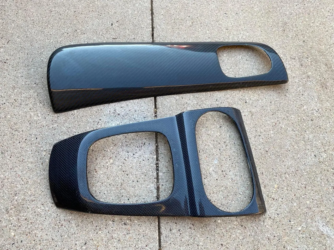

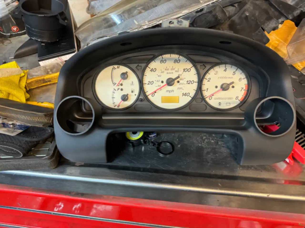

New amber LEDs and pod surround on the cluster and some carbon fiber pieces to round out the interior

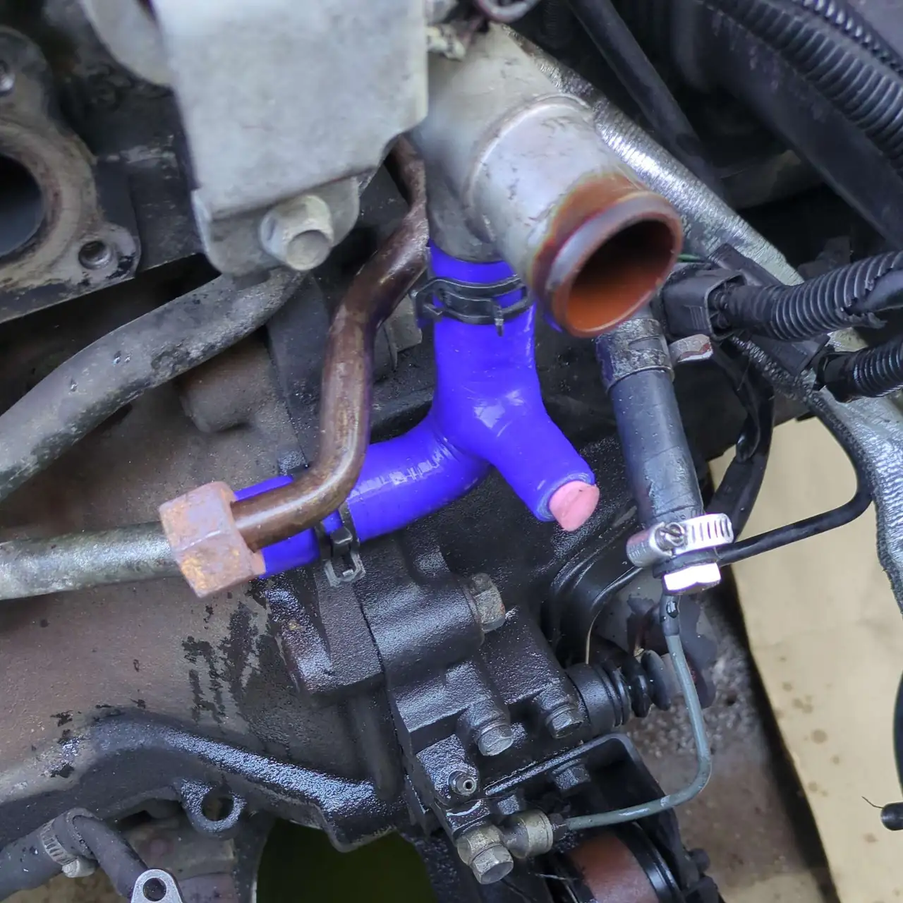

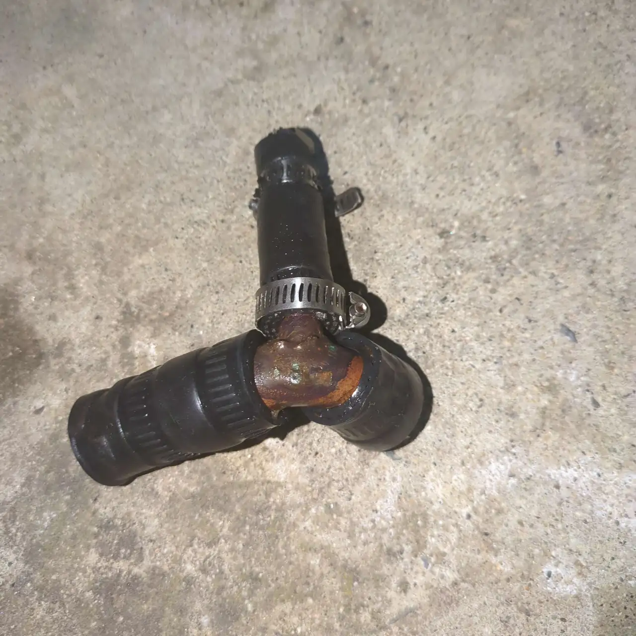

Replaced the turbo water elbow. Ngl the previous owner must have been pretty good at welding, because this is a custom made copper elbow. Still, I trust the new one more lol.
Got the remanufactured reinforced elbow from Castilleja Performance after I saw it in a fb group, 100% recommend since Crossover Auto doesn't make them anymore (i think).
(yes that's an ear plug, surprisingly good for temporarily blocking coolant lines)

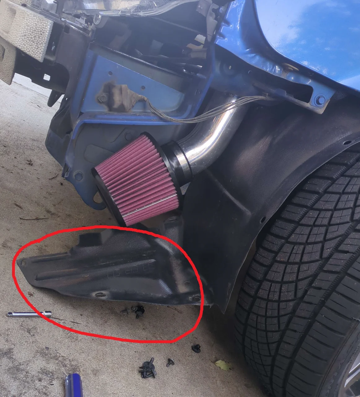

Finally put in weapon r hard pipes and an injen cai. Honestly wasn't as annoying as I expected, hoping to not have any issues with the pipes popping off. I'm running stock psi, so I suspect it will be fine. The turbo flutter coming off this thing is absurdly loud now, sounds sick.
Here's a picture of the intake side. If anyone here has experience with this, does cutting this part of the fender liner benefit the cai? I live in a pretty dry place so water splashing isn't too big of a concern, still though, I'd rather keep it if cutting it doesn't really do anything.
You could perforate that section for better air flow for the intake by drilling or cutting some holes.
You'd have some water protection and try to stay away from bigger puddles if possible.
If there's an opening from a not used fog lamp that too would work so the fender lining wouldn't have to be modified. 👍
