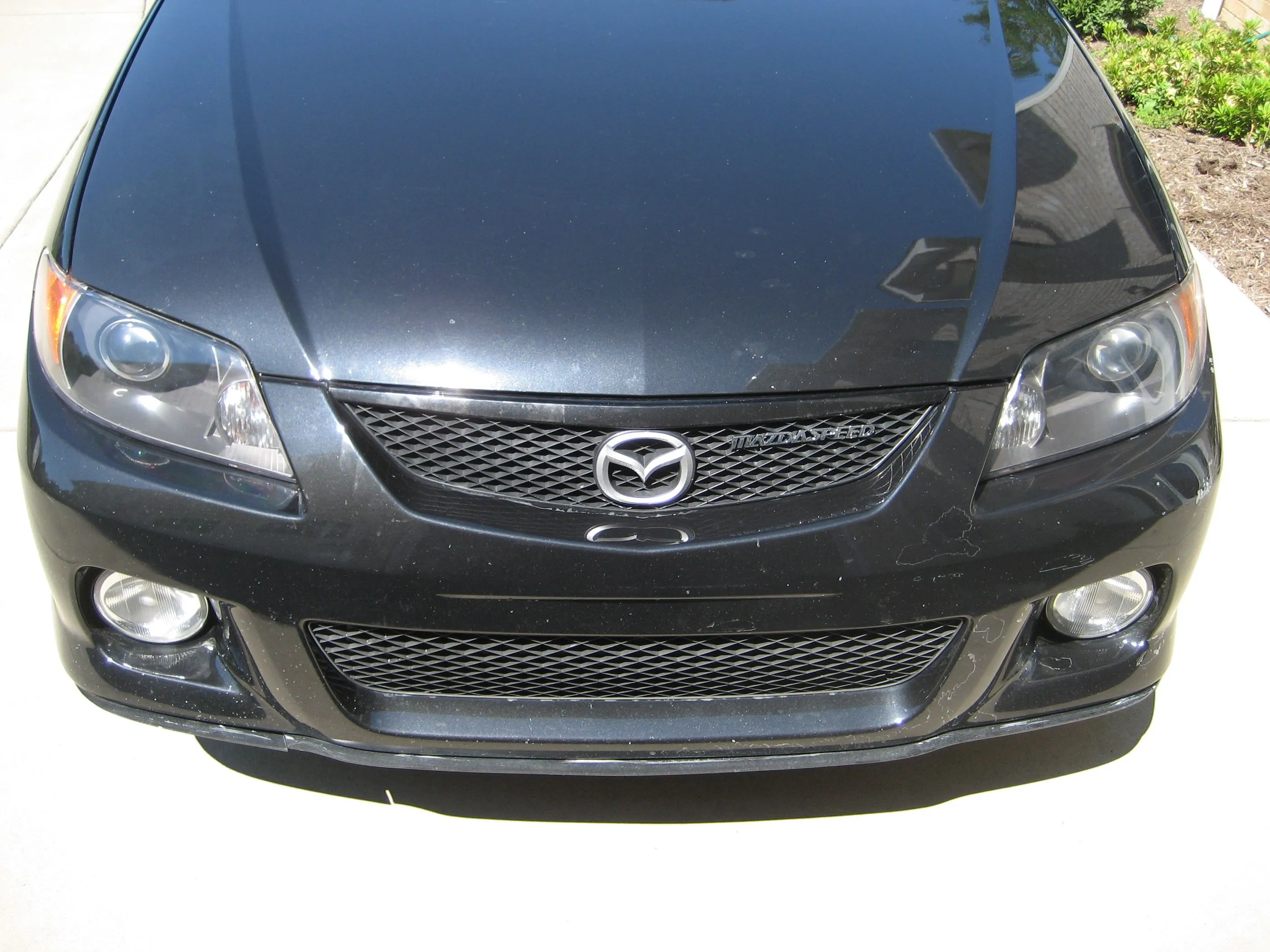

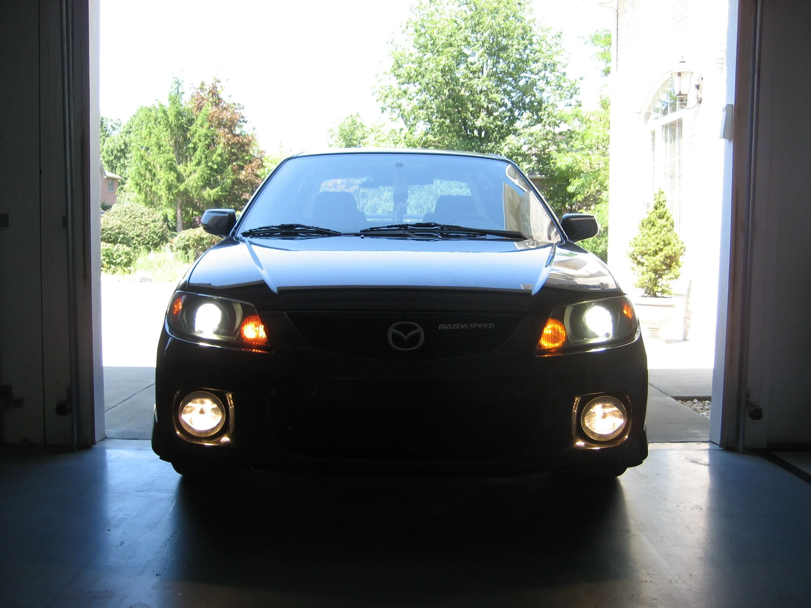

Retrofit my Headlights!
Well it's not right at the pin that my problem lies. The wire is damaged and my dad soldered it but I still think the connection is ******.
and those headlights are sexy!
