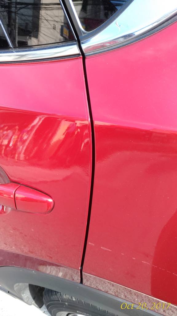

2 weeks ago, installed Xpel on door edges. 10 feet is short so I bought a new set from Amazon. 100 feet. Good enough for 6 vehicles.
