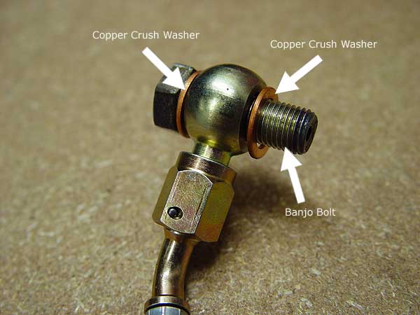

i double checked, and believed to be the #19 water feed line's bolt/washer leaking (that bolt are wet all day)
cant fit ratchet/ ratcheting wrench in there, actuator and some other bolt are in the way.
19mm socket fits in there, but ratchet cant go in the socket because actuator is in the way

You will need two crush washers for each line and install them like this. napa auto parts should have crush washers in stock

but i am sure the banjo bolt at the rear of turbo under manifold is still wet after i parked it for 2 days. the one in front is dry like dusty.
i just got my water feed line washer/ banjo gasket thingy $4
