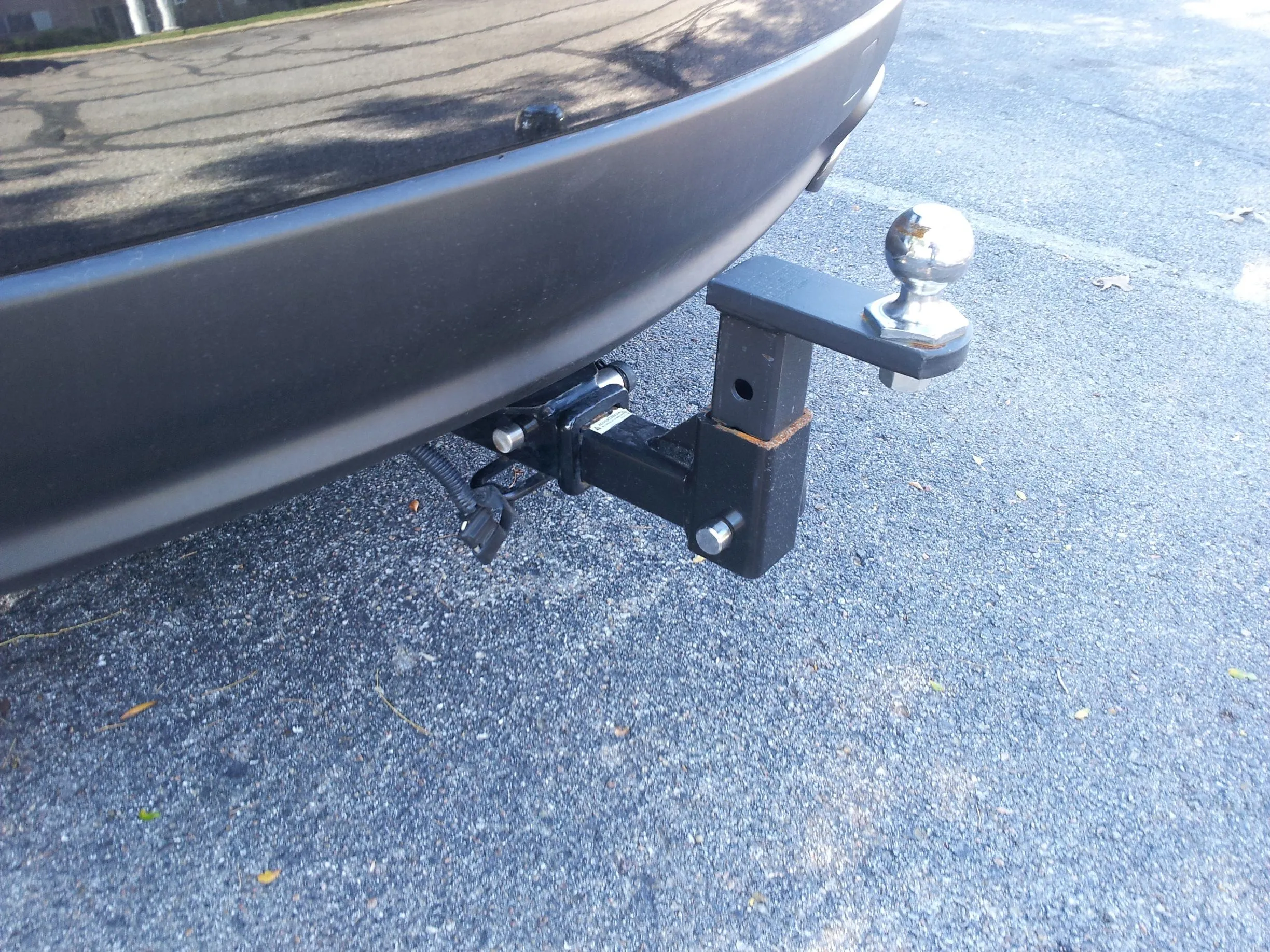

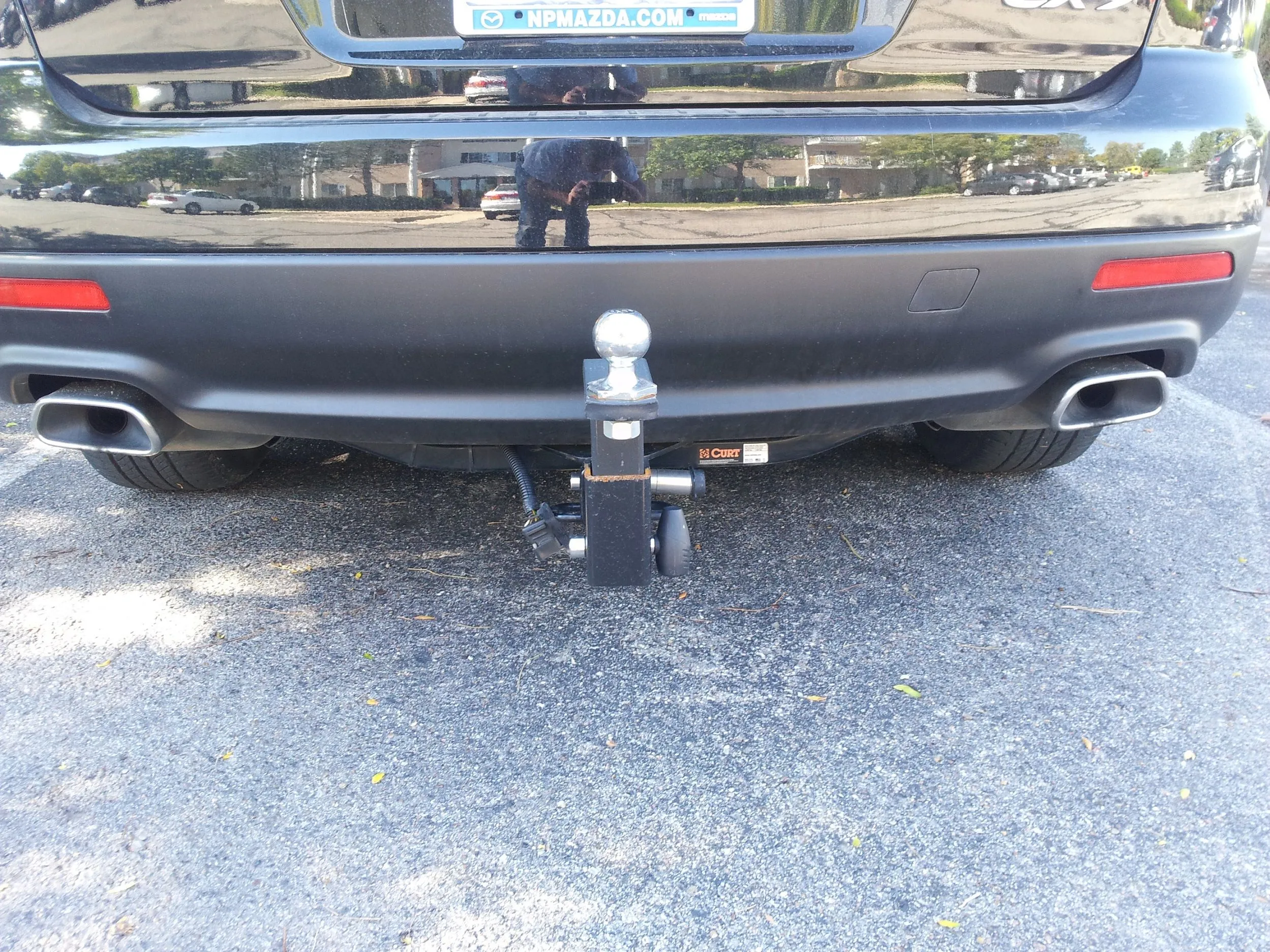

Curt Makes a bolt on hitch for our vehicle, which is what the dealer installed on my CX9 in lieu of the standard hitch that Mazda offered.

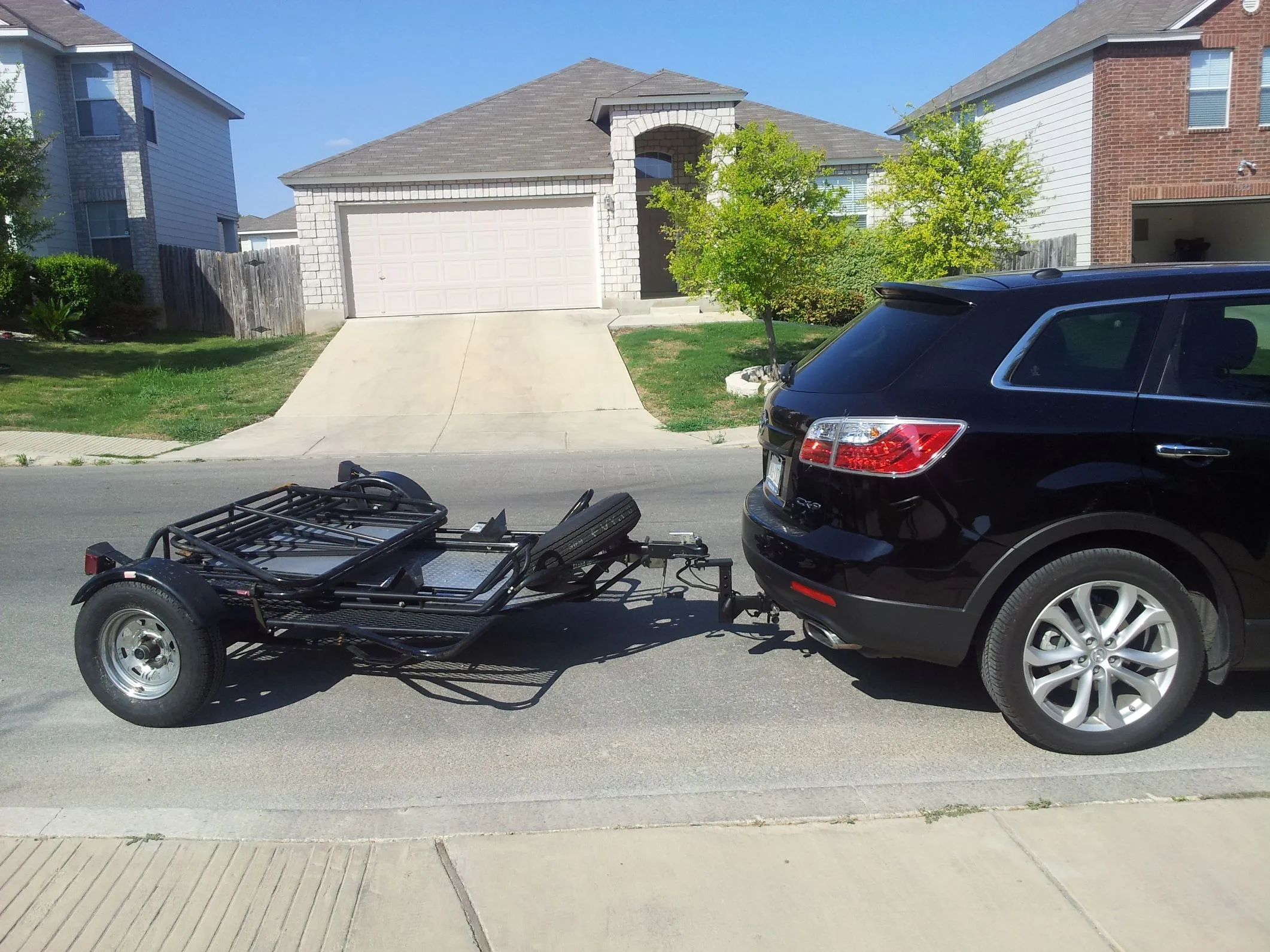

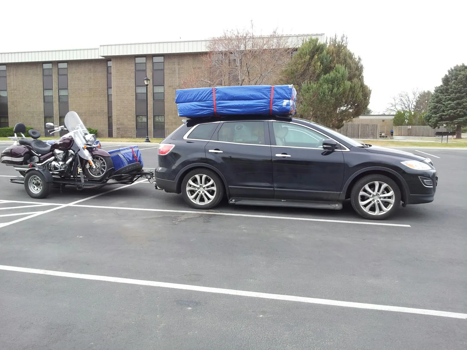

I also pull my Motorcycle(s) across this country due to my work taking me to different places.
I have a Kendon Trailer and would recommend that trailer to anyone looking at trailering a bike anywhere.
The Kendon Trailer folds up when not in use and can be lifted up on three castors on the back end of the trailer so it can be moved around easier when not needed.
Takes up about 24 inches of wall space in the garage when lifted up.
It weighs about 400 Lbs empty.
A two bike unit can carry two full size baggers if needed, I have had my 1800 and 800 on it for a trip to Kansas.
I used it in my moves to Washington state, to Kansas and recently to North Carolina. The trailer worked great hauling the bike and other items.
You can also use it as a standard utility trailer if needed, the guy I bought it from said in lieu of taking off the rails for the bike you just need a wood pallet (or two) and set them over the rails to give you a flat surface.
They are made in California and well worth the money if you plan on taking a bike to many different places then it will pay for it's self in the long run.
I bought a adjustable Hitch from either O'Rylie's or Autozone that brings the ball up around bumper level and levels out the front of the trailer while it is being pulled.
Makes it easier to load the trailer with a more level platform to work with.
Here are a couple pictures of my CX9 with the trailer and Hitch setup.

I have that same Curt hitch and it has served me well. I have the GT so I had the pre-wired option to work with. It was very simple to get it all installed and I am very happy with the results. I just use it for a utility trailer when getting stuff I would prefer not to throw in the vehicle, Home Depot runs and etc...
