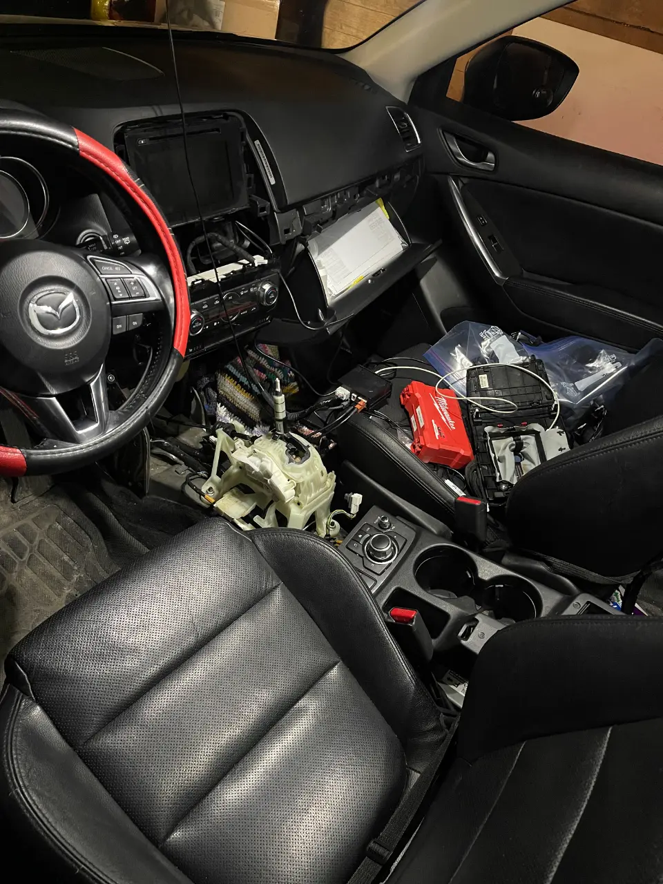

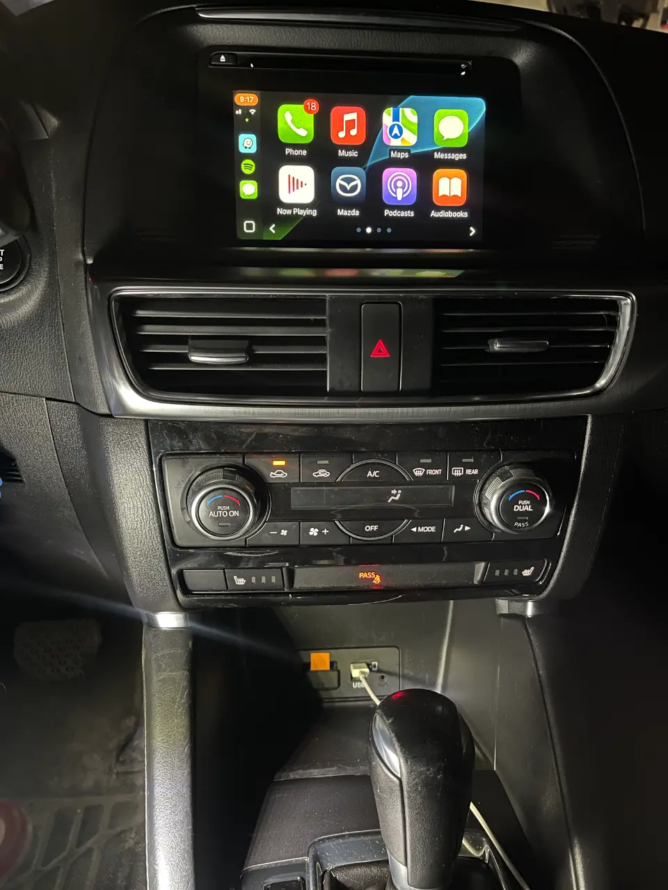

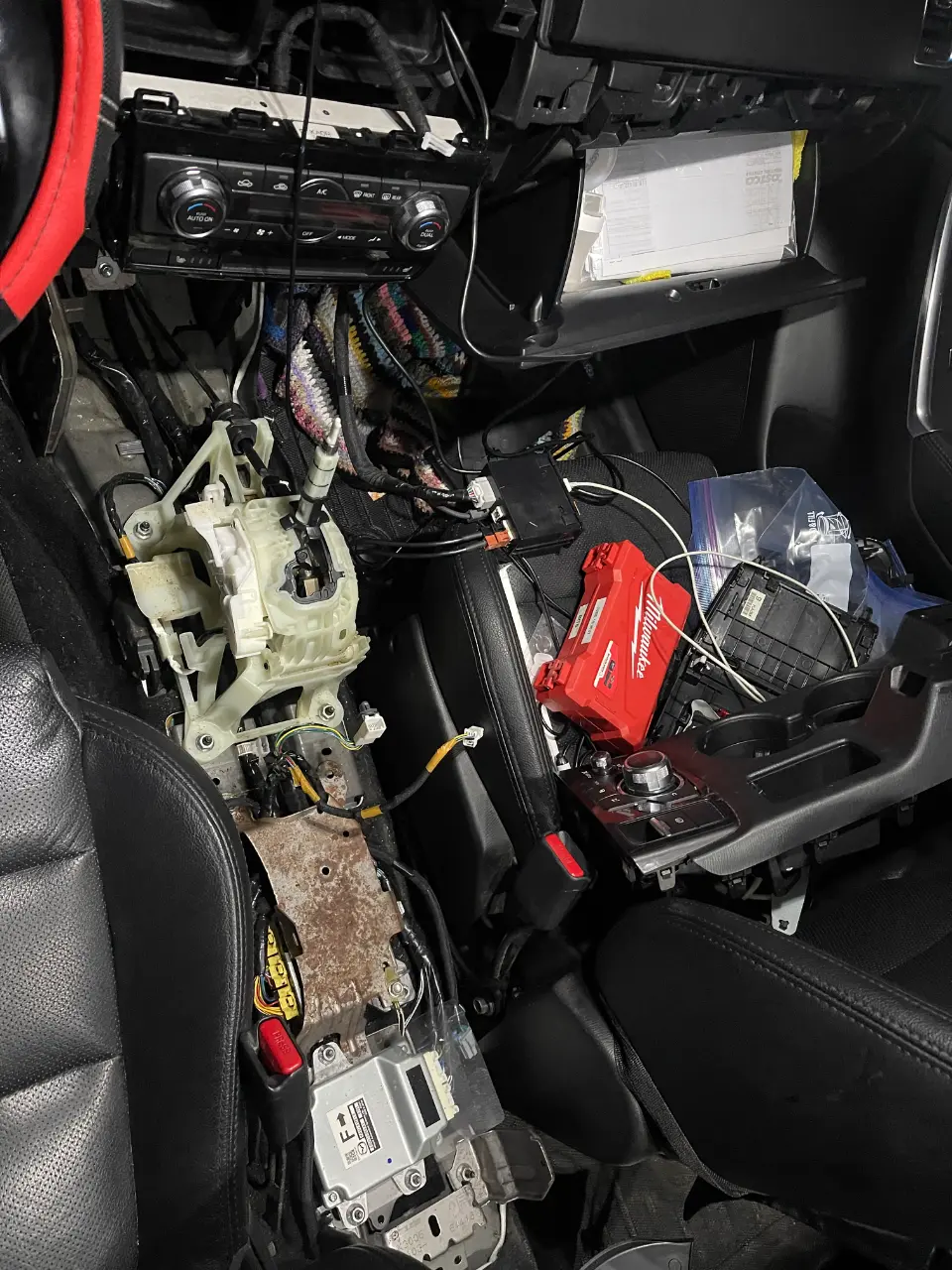

Added Apple Car Play (and cleaned in process). First time taking it all apart. Found lots of gunk, broken plastic tabs, and missing bolts in the process from previous owner. Time to start hunting for replacements.

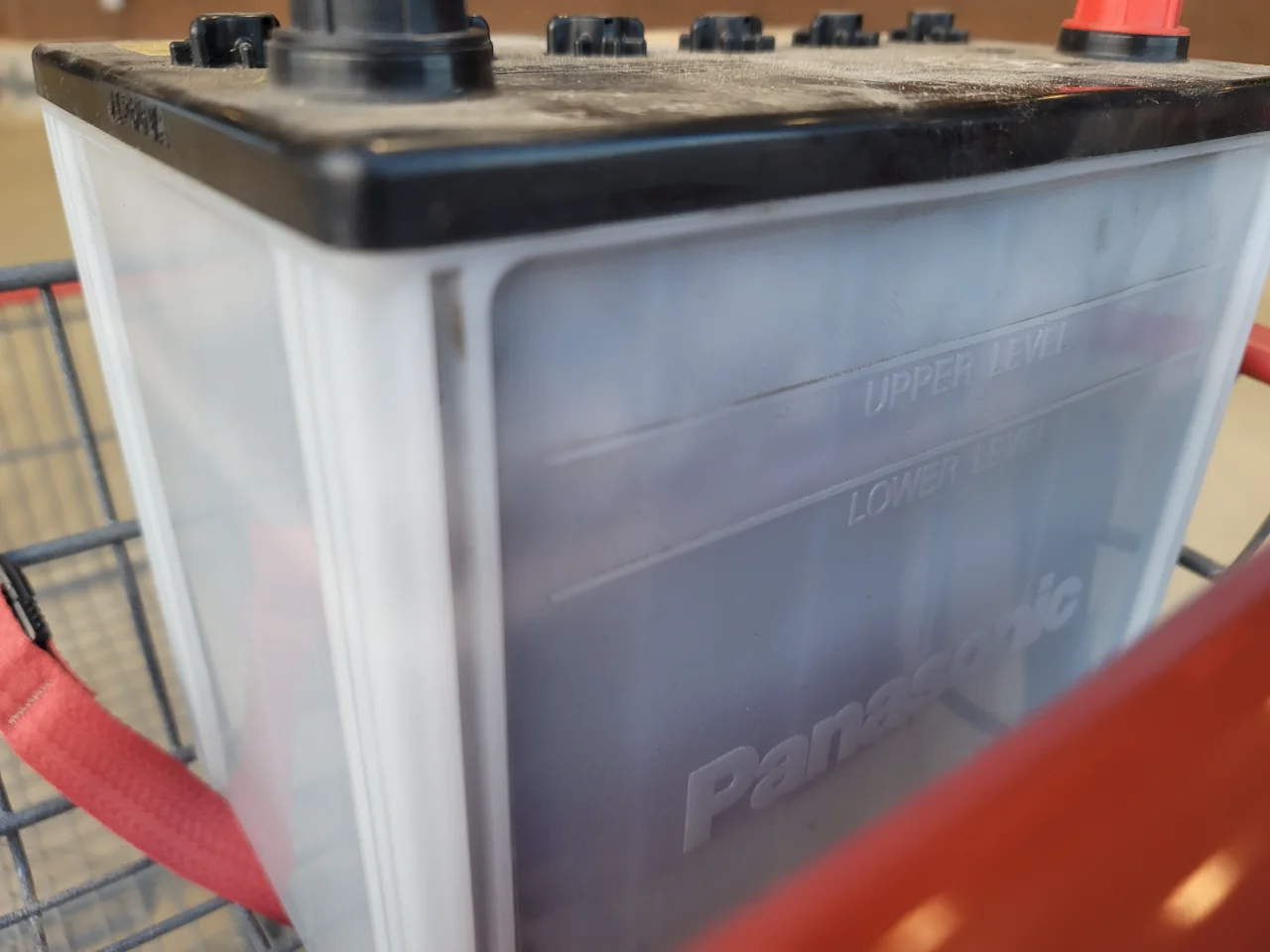

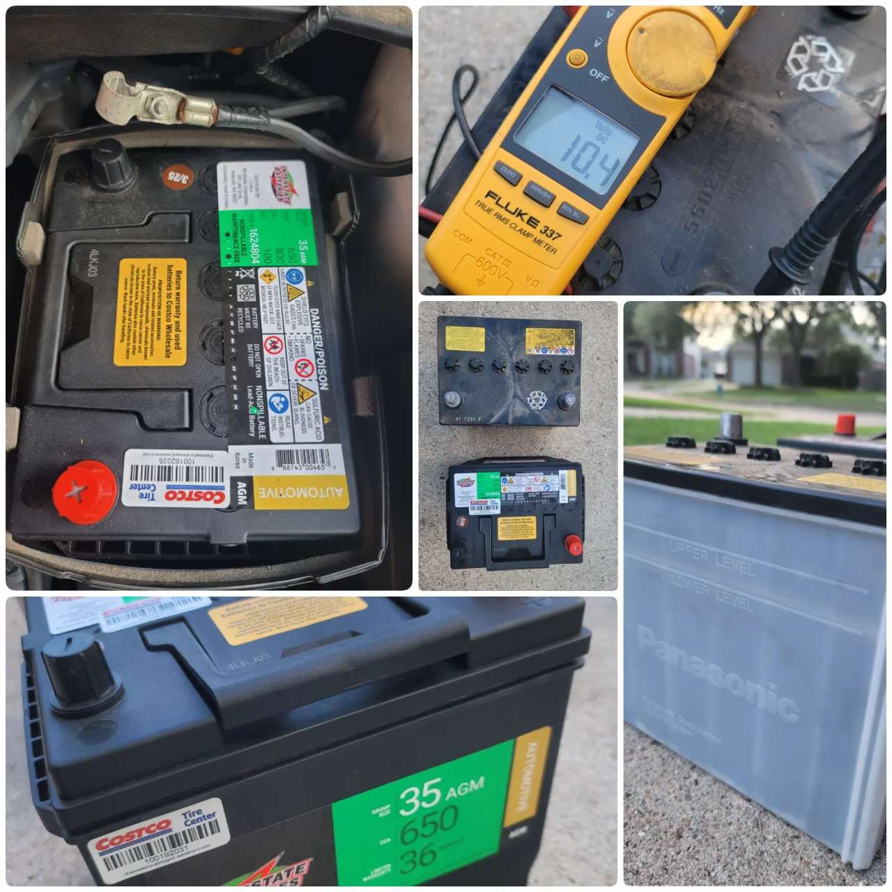

Just replaced the OEM battery on my 2019 CX5..... I didn't have to but I did, went with a AGM from Interstate at Costco for $179. Hopefully this will last as long as the OEM (I doubt it).
It's was due. If the car was not used, daily, I had to jump it..... I also noticed that even the fluid level was at low. Battery was at 10.4 volts.

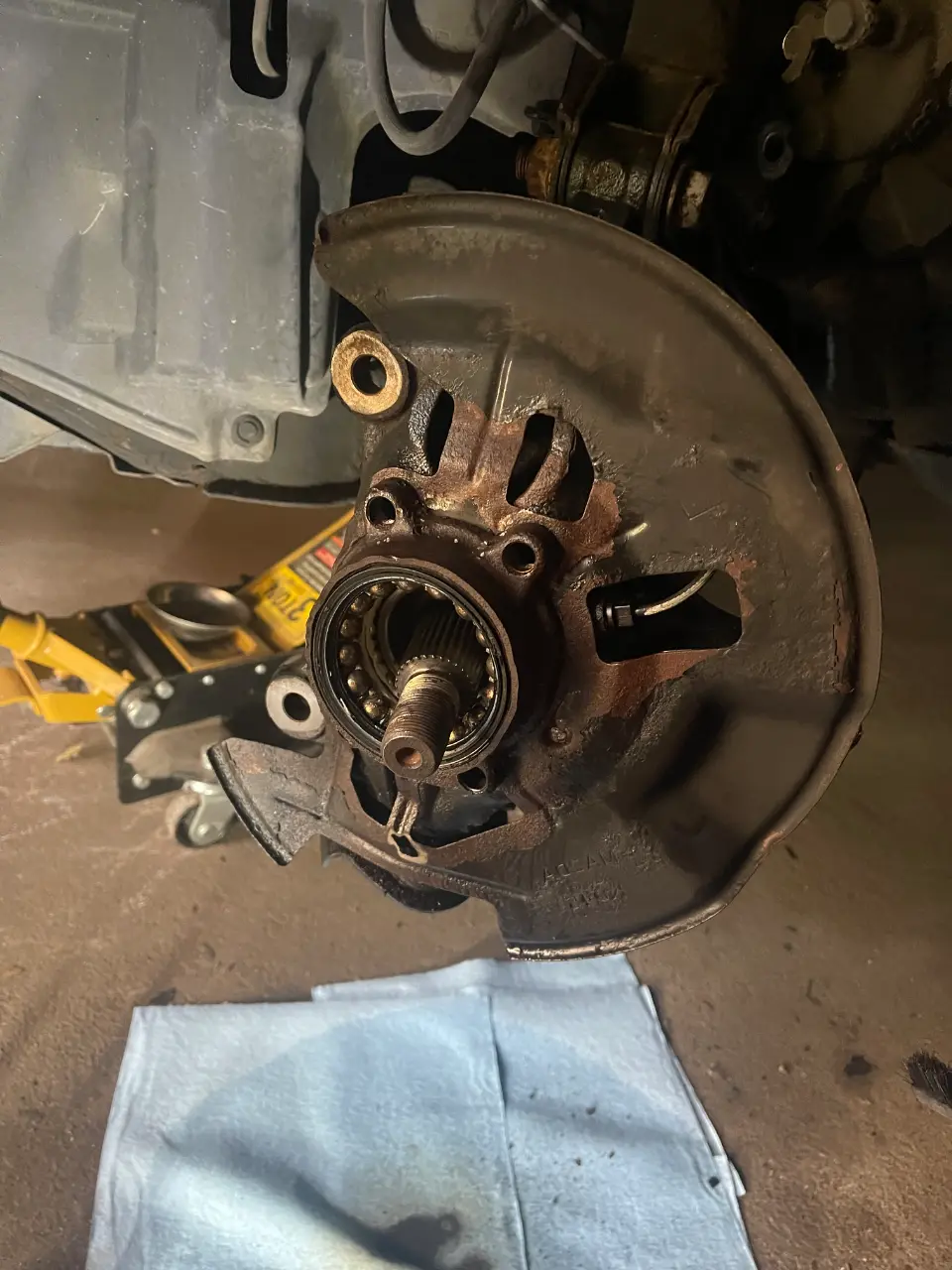

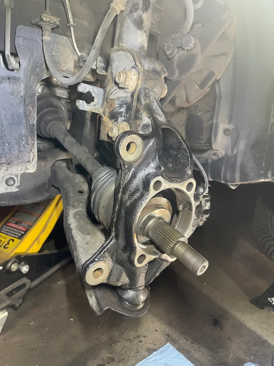

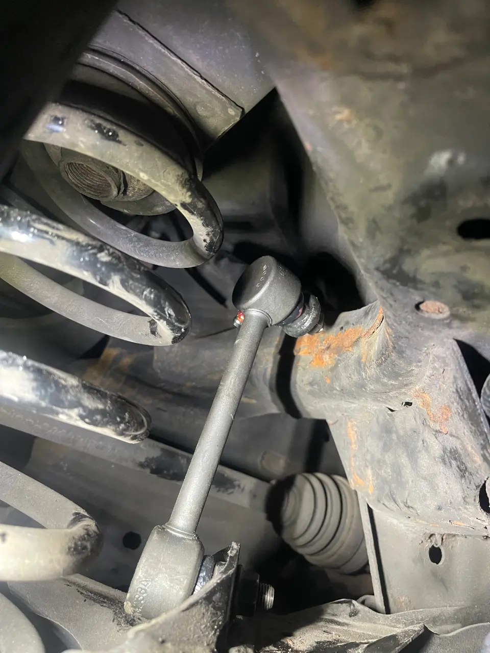

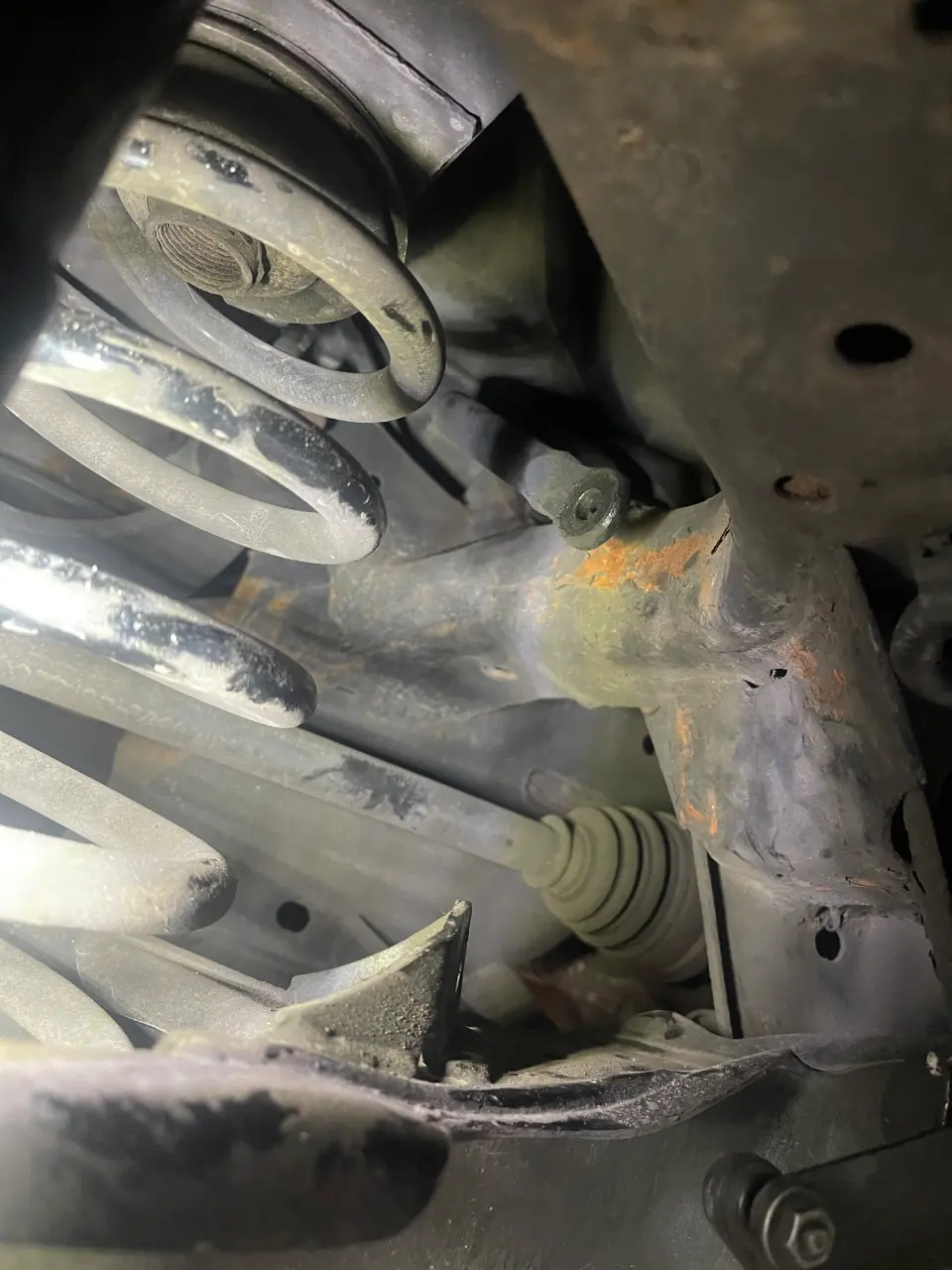

changed front driver:
- hub
- cv axle
- outer tie rod
- inner tie rod
- cleaned up the knuckle a bit
Inner tie rod was warranty work. Outer tie rod I broke the boot by accident. Hub because of wheel play. Cv axle as I found some teeth damaged. Lost about 1L of ATF … good thing I had some backup bottles…
The wheel still has some play in 9 and 3 when compares to passenger. Trying to figure out what’s doing it and if I can’t … it’s going for a diagnosis as the steering rack diagnosis is beyond me atm. I’m thinking it’s not the rack as I think that there would be play from passenger side as well… and that side is solid. Ugh.
I didn’t take many pictures but here are some. The video has some music so you can watch that muted if you like.

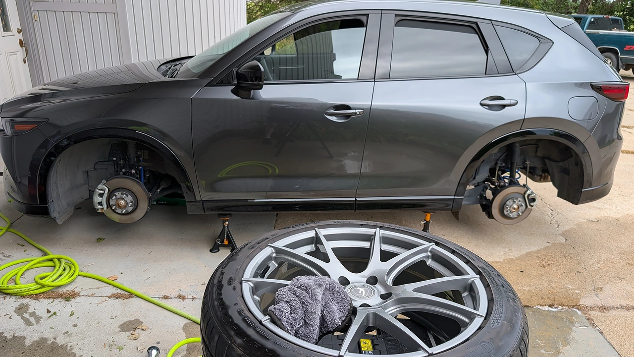

Done and done. Oil changed, rotated wheels and aired up the tires...retorque after driving tomorrow.
