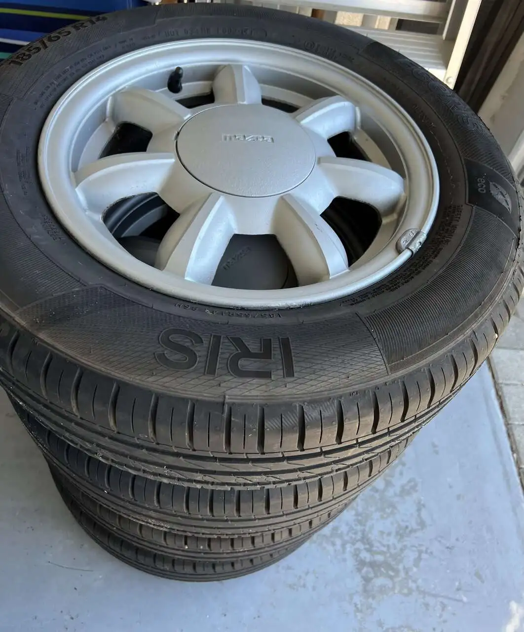

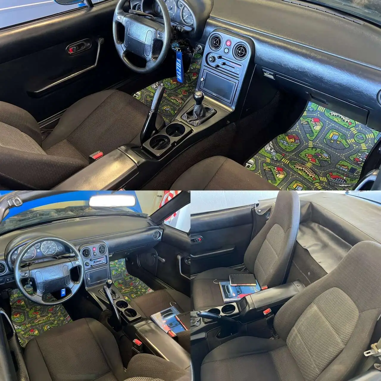

Seats go back in third Off to buy some like new daisy's and a spare tomorrow.

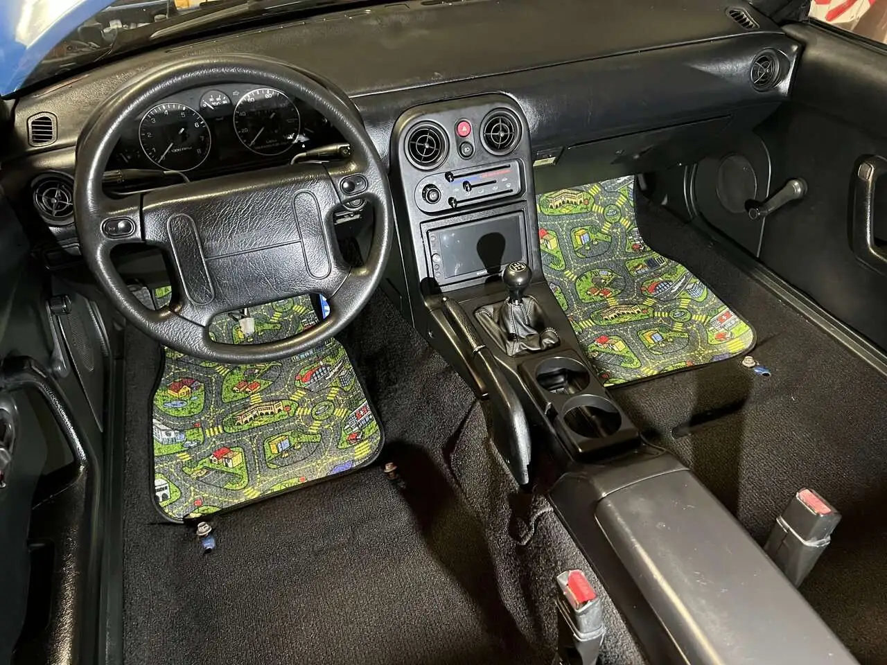

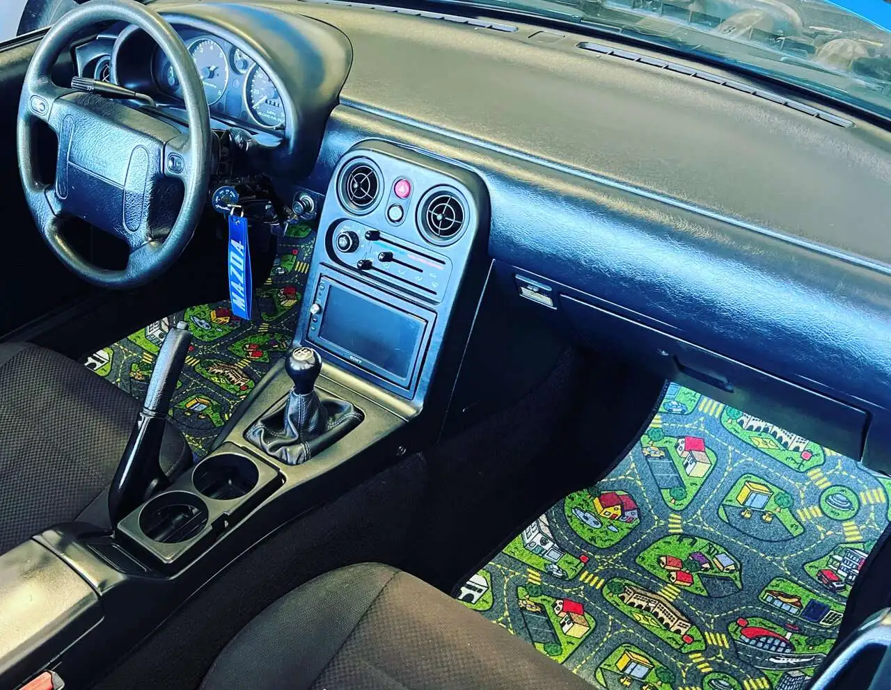

Interior complete….new ignition switch and connector Saturday.

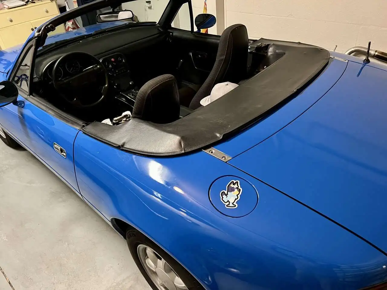

Bluey…..
Ready, set , go!

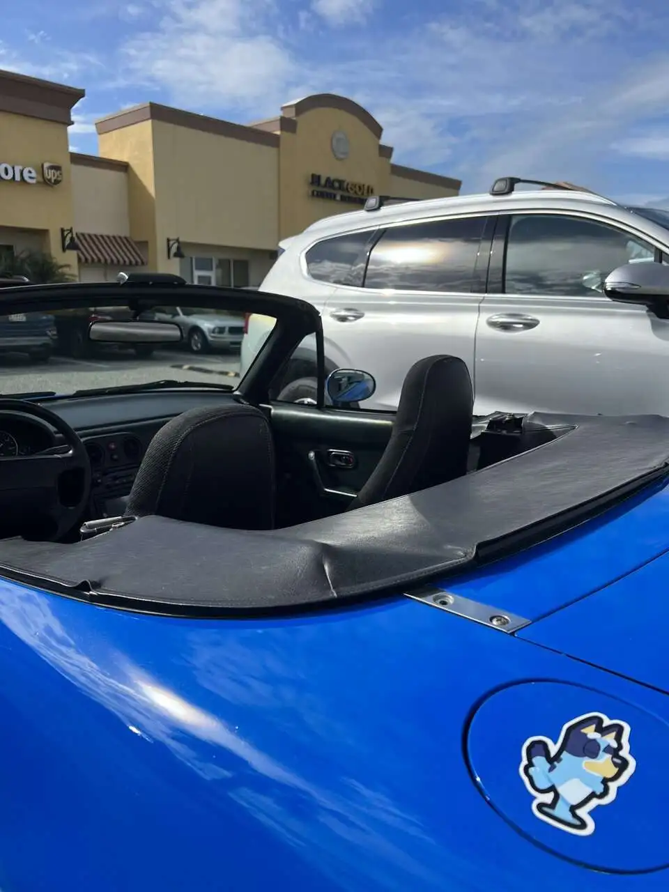

Just finished the exhaust! Out for my first ride! A latte at Black Gold!

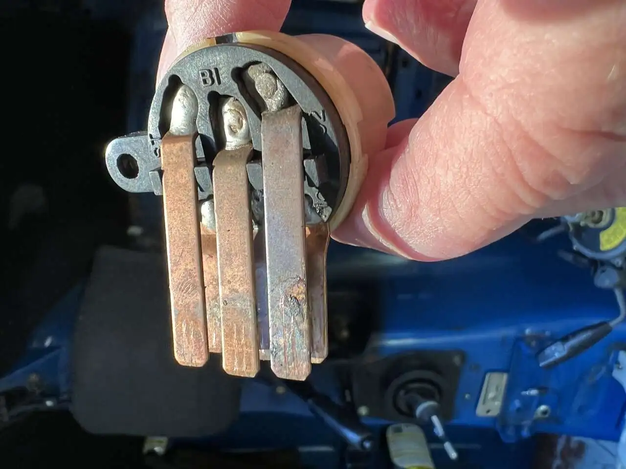

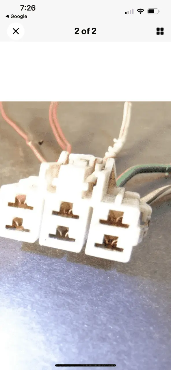

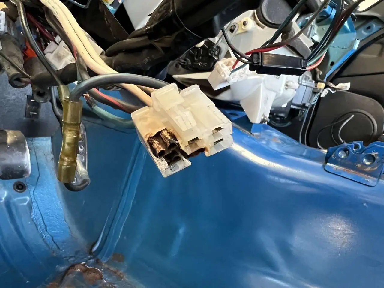

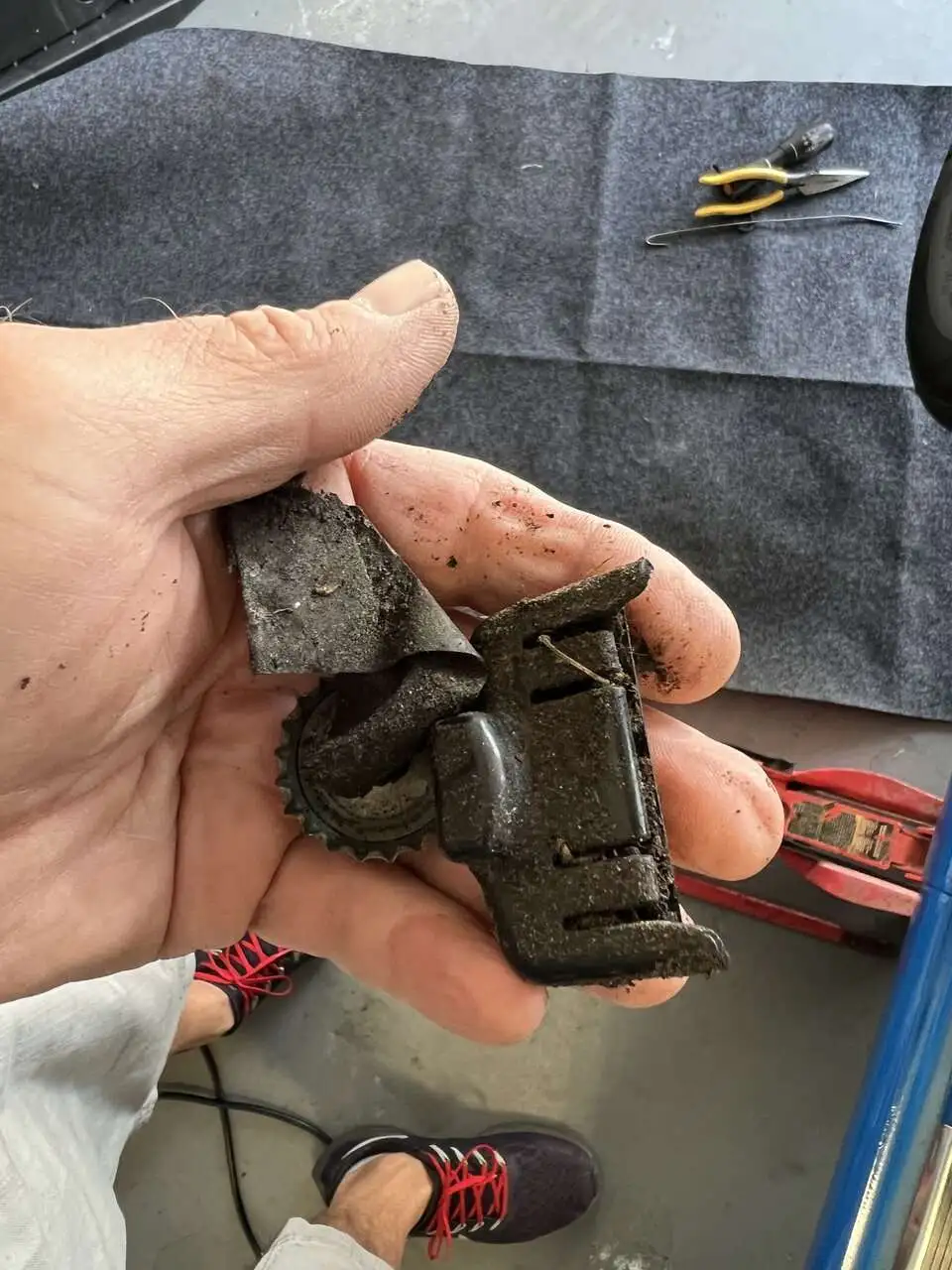

Nice work Mark. Why was the ignition connector melted?
Apparently it’s a known issue with the early NA. Years of constant use, connection becomes loose from vibrations and it overheats.
First pic is my new/old stock connector. Second is my melted connector and third is the ignition switch end where it plugs in.

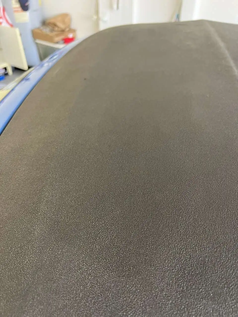

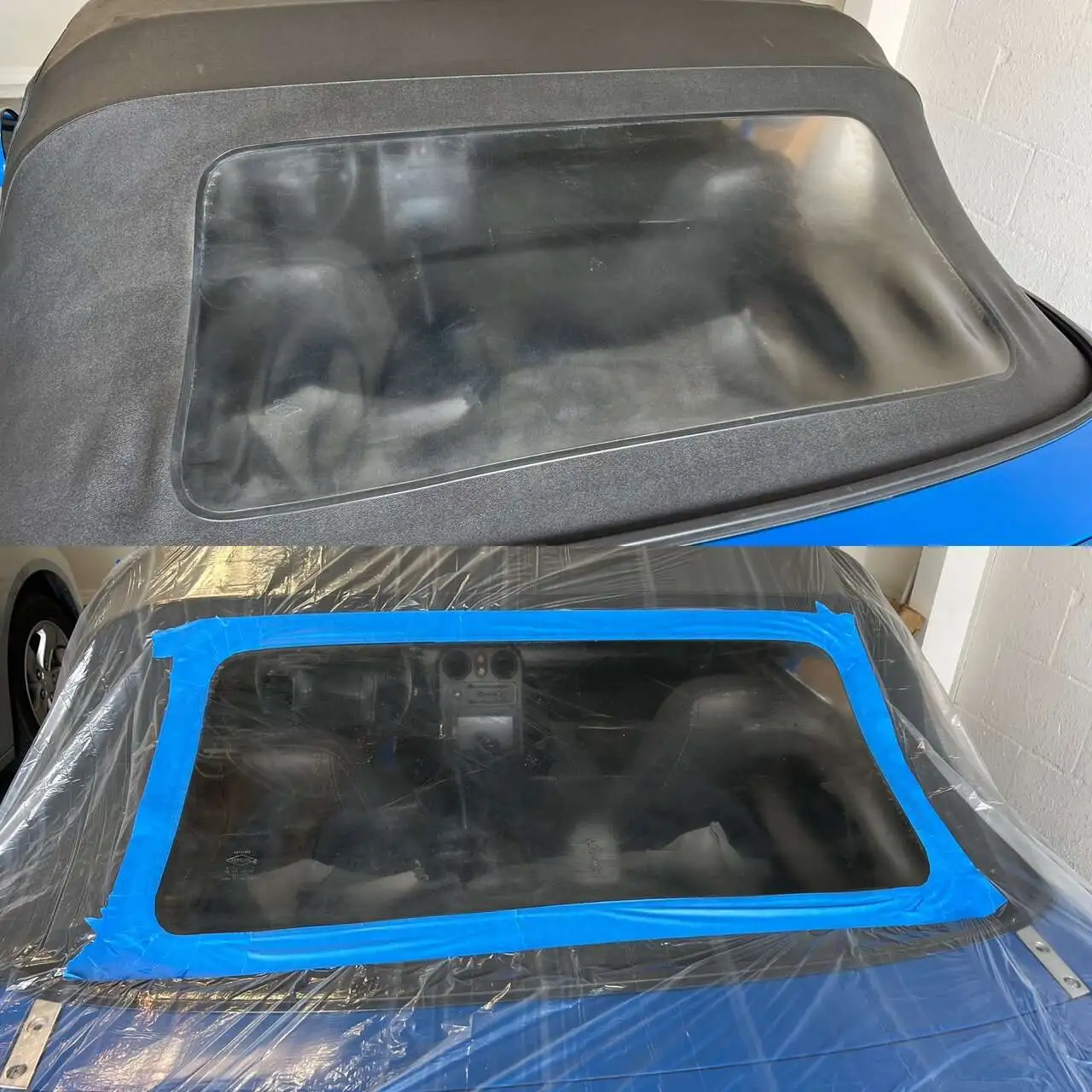

Did some vinyl top restoration today, come out great! My vinyl window is trash though☹️. I was thinking of tinting it, to take the curse off it? Looks like someone cleaned it with a wire brush!

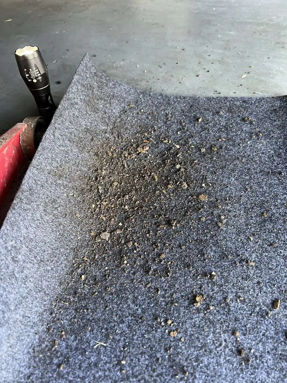

While on the roof cleaning I thought I should check the drain holes/lines. 😬 Well clogged solid, both ends! Bottle cap, plastic bits and pieces, and a tape measure!!
Got ‘em cleaned out with a coat hanger.👍🏻

Top looks great which means replacing it for a new one with a glass window doesn't make much sense. I'd tint the vinyl for now. Oh man, that is crazy what you found in the drains, a tape measure? At least they are easier to clean than the drains on the ND. lol
Window tinted, it look better but not ideal.

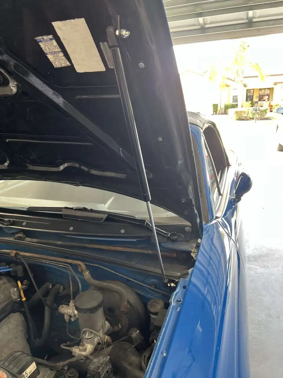

added a hood strut too.
