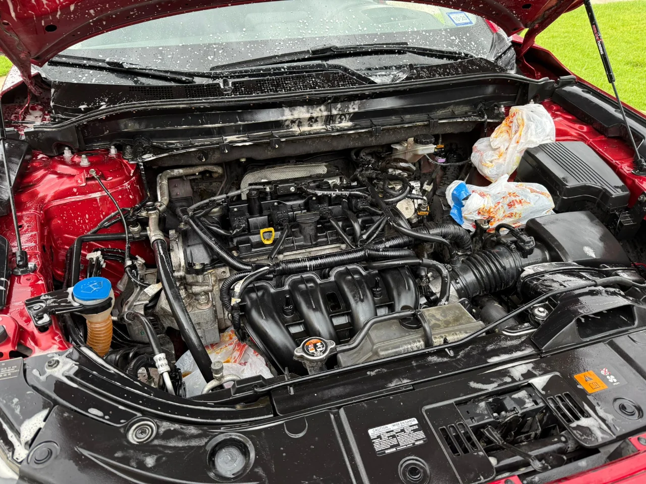

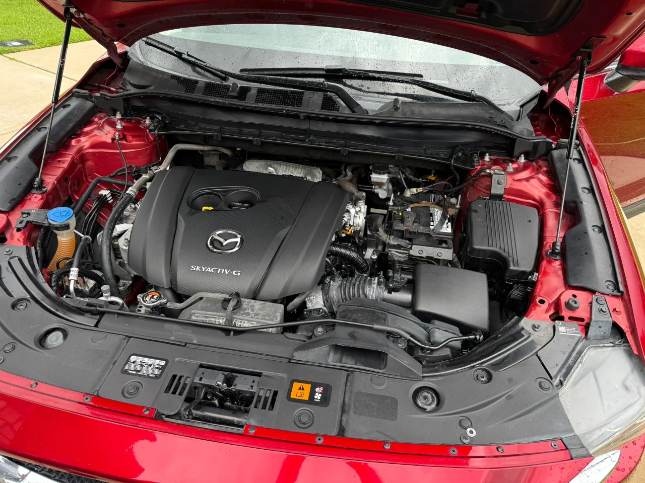

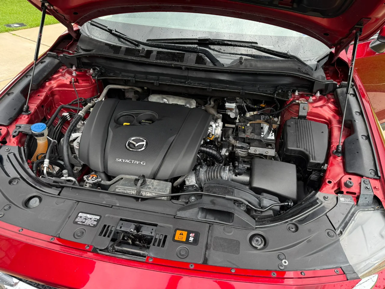

Today I decided to clean the engine bay. Never done it before but after few YouTube instructions and some careless(!) considerations, I went for it. I only spent, maybe 15-20 minutes with the cleaning process. but I am satisfied with the result. The more time you allocate and the more patience you have, the better the engine will look.
I used an electric hand spray pump, a cleaner called P21S and a brush. Rinsed at the end with water using a hose with low pressure and a shower like nozzle. Before the start of the process I bagged the alternator, removed the car battery and bagged the terminals and the ECU connector. I've seen some videos where they did not remove the battery at all, left it all connected. I am glad that I took the battery off because I found that the battery tray has no drain, so the water was accumulating on the tray. I would not want to have a battery sitting in water. With the engine off and hot (I did not want to wait few hours for the engine to cool off), started to spray the cleaner all over the bay and the engine block. Let it soak for 5 minutes, then used the brush to clean in tight spaces and at the end tried to rinse everything really good. Used some rags to wipe of the water and that's it.
When done, went for a ride to the supermarket to help drying the water. While driving I felt an odor inside the car, probably the chemical residue getting hot from the engine and burning which makes me thinking that I should have spent a little more time on rinsing. In the end, I am satisfied with the results and next time I'll try to clean it better.
I don't think this is necessary on modern cars. Pros clean hundreds of engine bays per year and never have an issue, and they are using pressure washers.
Good tip about the battery tray, though. That would be a reason to remove the battery. I'm surprised there isn't better drainage there.

That's good stuff. Next time I'll try to get some of these. On the connectors matter, the modern cars have seal tight connector and water should not make contact with the pins. But high pressure water, all the instructions I've read said no to high pressure. And it makes sense to me, considering that it might be something loose in there, maybe a weak connector, maybe a loose wire or something else and I would not want to make any damages with high pressure. Definitely cover the alternator, I'd say.
Everything I've seen about modern cars tells me that the alternator is designed to handle being wet, no problem. Not saying you can submerge it while driving...that is probably different. But there is no need to cover it for a wash.
But you need to really rinse the engine thoroughly to not leave cleaner residue behind.
I would recommend a strong leaf blower to blast the water out of the engine. Think about spark plug holes, etc.

You sprayed cold water on a hot engine? Not something that I would recommend doing.
Warm engine, yes. Hot engine, no. No need to take the chance of messing something up.
Did the cleaner that you sprayed on sizzle when spraying it onto the hot bits like the exhaust?
Another possible issue with cold water on a hot engine is that as the engine cools from the water, the water can get sucked into areas where you do NOT want water to be sucked into.

Well, I get that. The water from the garden hose wasn’t cold, not enough to mess with the engine. And you’d have to pour a lot of cold water on that engine to mess it up, to crack the engine or something. With low pressure, most of the water was evaporating rather quick.
