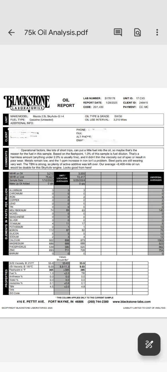

Last 3k miles were mostly short trips (under 5 miles) so I was curious to see how the oil held up. Looks like it did just fine (2017 NA, California climate, Pennzoil ultra plat 5w30).
Question- if I only drive 3k miles every 6 months, is it safe to wait a few extra months to get closer to 5k miles? Not sure if the fuel in the oil would cause any issues if I went an extra 4 months on it.
If it were mine, I'd go 5k miles on oil changes, regardless of the time interval. Oil has an infinite shelf life. Your oil test confirms you engine is not wearing outside of the norm.

If you want try the Amsoil Extended XL (next one after the OE ). Viscosity drop is because of the fuel unfortunately but that is not that much problem at 5k changes. The engine didnt mind..
