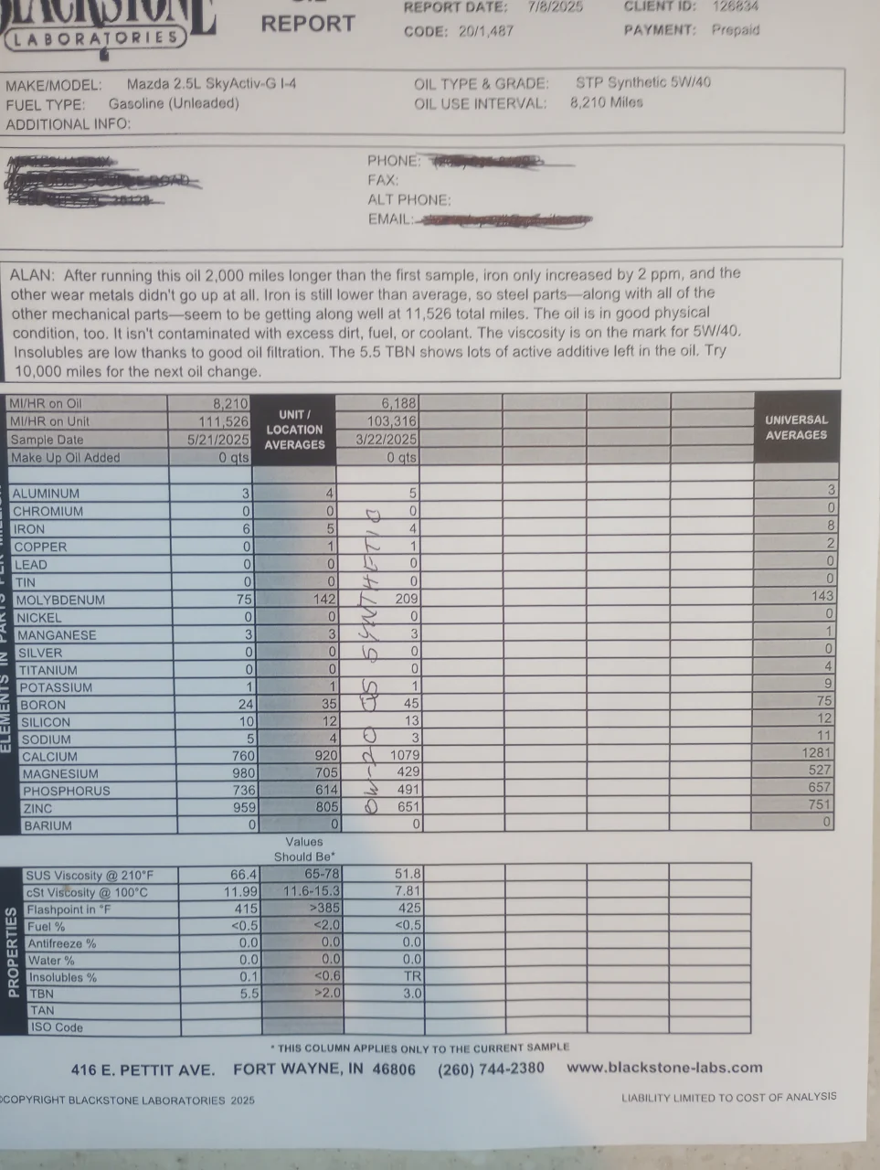

First UOA on a new to us 2019 CX-5 purchased from a Mazda dealer. Sticker indicated it used Qualker State 0w-20. The aluminum was a bit higher than anverages. What say you all about this? Is this normal for a CX-5, especially one with cylinder deactivation?
I would not say that 5 is high considering 6188 miles on the oil. I would defer to their expertise whether it's abnormal to see aluminum higher than iron.
Cant open the file for some reason but Check my past UOAs of the same engine (past posts) if curious. I have done multiple UOAs from new.
5 is not a lot. Your are fine.
Changing oil earlier or using Mazda oil should drop those even lower.
2019 CX-5 Touring. 2.5 NA. The first oil analysis was from the oil that was in it when we bought it used from a Mazda dealer, Quaker State 0w-20 synthetic. This UOA is for STP/Amalie 5W-40, SN rated HDEO. I'M A FIRM BELIEVER IN USING PROPERLY RATED HDEOS. I'm very pleased with this result. The iron is up but the aluminum is down. I used a Champ XL filter. I guess my fear over fuel dilution issues with direct injection engines is apparently not valid with the Mazda Skyactiv.
