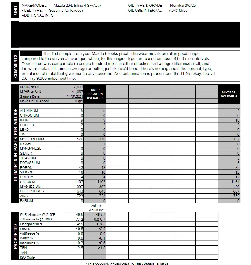

Here is my oil test @ 7k mi from 3 years ago on page 23. Oil was regular Idemitsu, not high moly
If fuel dilution is a problem, it's an issue with the engine not operating correctly or the sample being taken after lots of short trips and not getting the engine up to temp
All of our engines will have fuel dilution, even if they are perfectly operated by a knowledgeable technician. Of course, some people will accumulate more than others due to their driving habits.
Can't tell much on this topic from your oil analysis because we don't know what the viscosity was of the fresh oil. But I can guarantee you there is a steady drop as the miles are added and you approach 2-4% fuel in the oil (which is not apparent from Blackstone's standard test, as it always comes in lower than Oil Analyzers).
